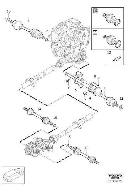

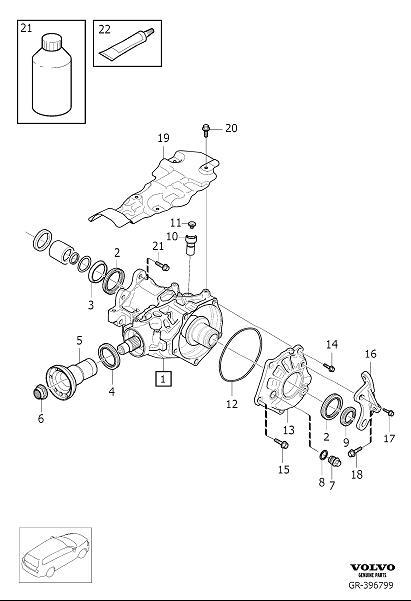

Hi there, I’m sorry nobody answered your question but here you go. The AWD in the 2nd gen uses a bevel gear off the transmission in the front and a differential in the rear. The AWD is a Haldex gen 5 and uses limited slip clutches to sense wheel slip and apply grip.
As long as you keep up on the lubrication schedules, it should last 150k+ miles. Previous gen V70 and XC90 vehicles had high mileage wear problems that were likely to total the car if the bevel gear was found to be bad. In our case the bevel gear costs $1953.
