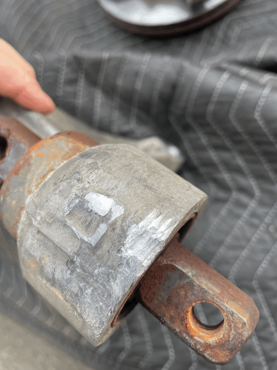

Here is a picture of my two year old Control Arm from Uro. You can see where the control arm was rubbing/hitting up against the subframe causing clunks
I bought old original Control Arms from erievovo.com. Even though they are used, they are still better than these replacement brands. These actually looked as if they were new.
I'm using original Volvo Ball Joints as replacements. A bit costly but definitely worth the cost. The flange on it is thicker than the URO its replacing. The Uro ball joint was also beginning to rip.

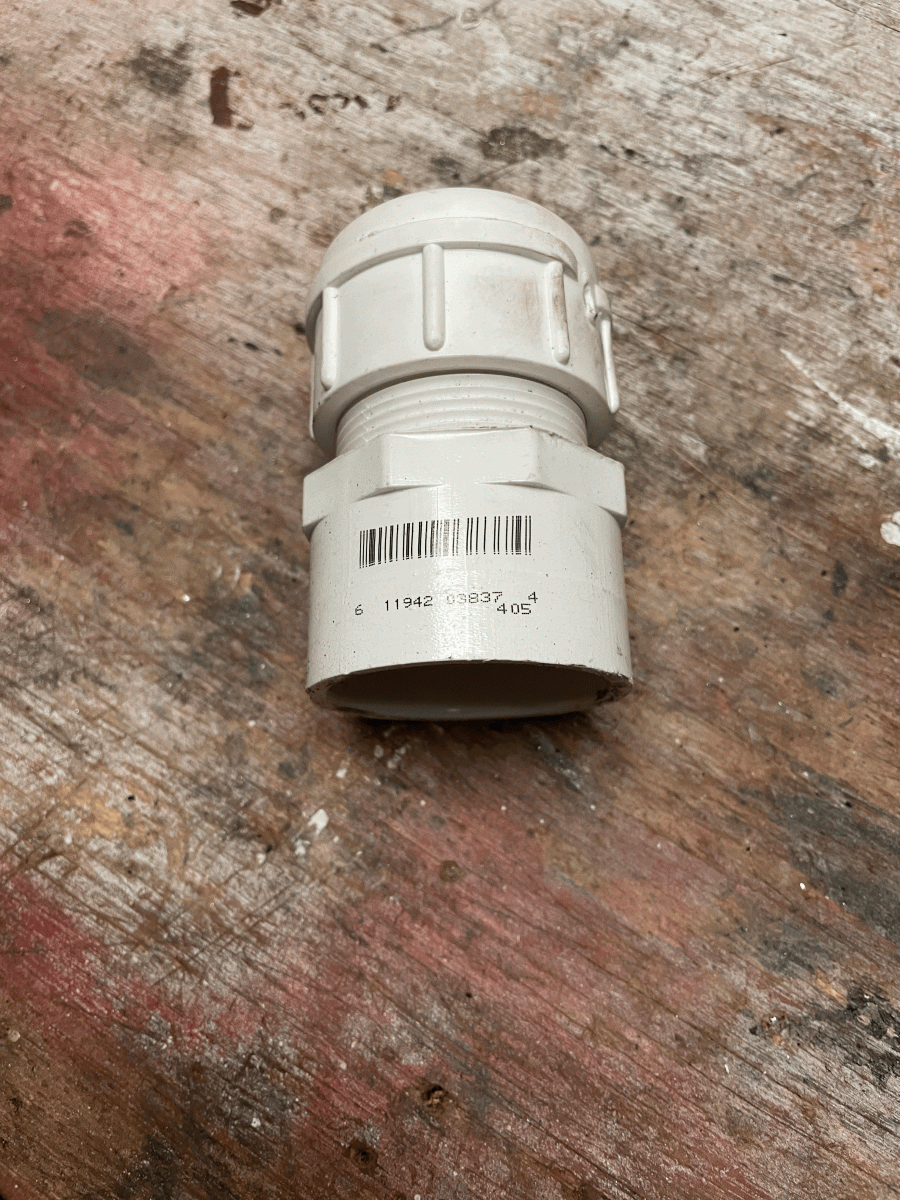

I used this trick to help with installation of the ball joint. Put the ball joint in the freezer the night before install. First attempt and the ball joint was 1/3rd seated. Then I use this PVC setup to hit the rest in. Three hits and it was seated. Cost was just $3.50. Its two pieces that's fits perfect over the ball joint

The Volvo ball joints are usually made by Lemforder

Good call on the control arms and ball joints, I just went through the same thing as you probably know. It's amazing how great these cars are when they've got the correct parts installed! My aftermarket control arm were doing the same thing after 6 months. Serviceable used OEM parts should last you at least 5 to 10 years.
