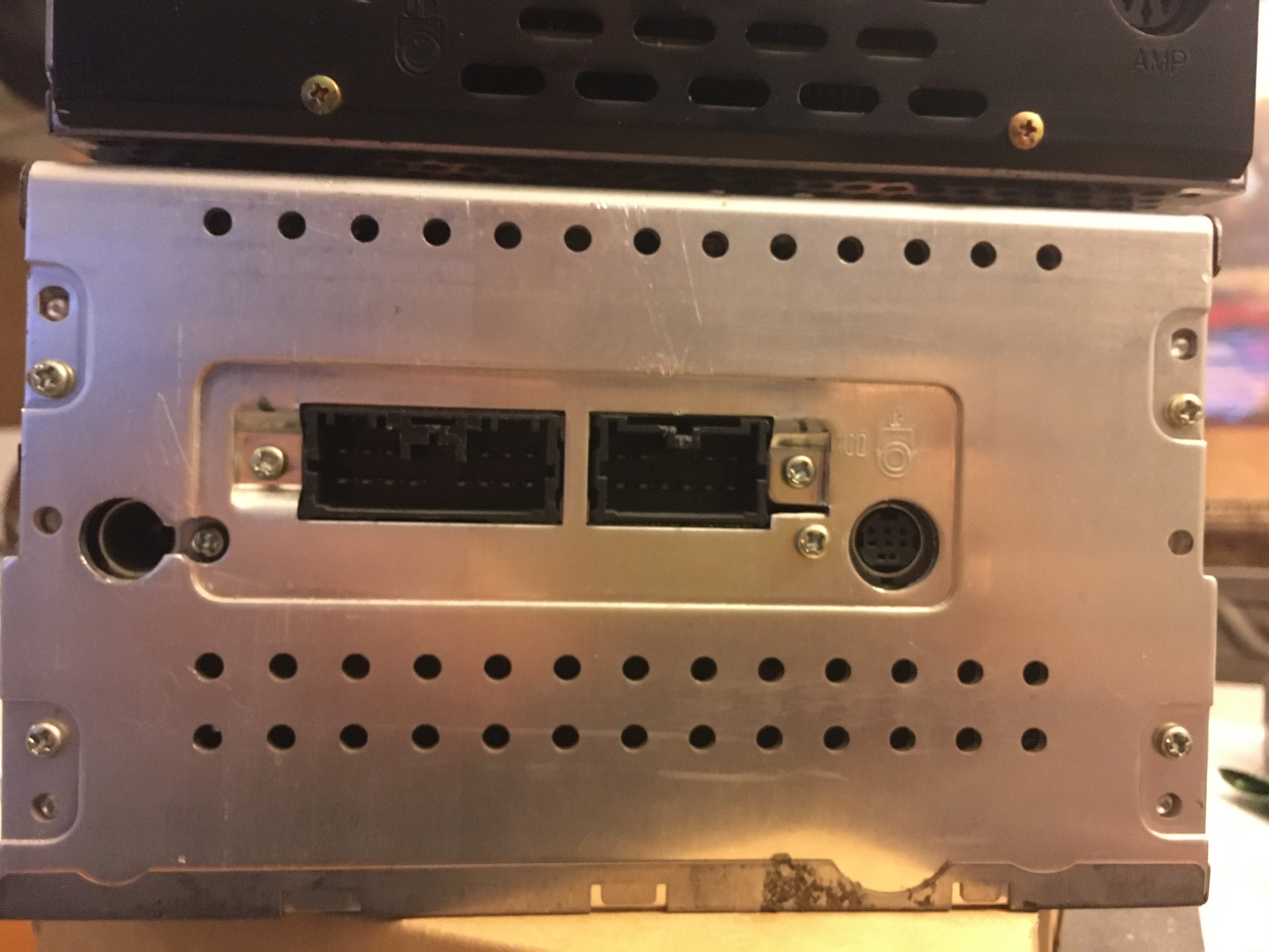

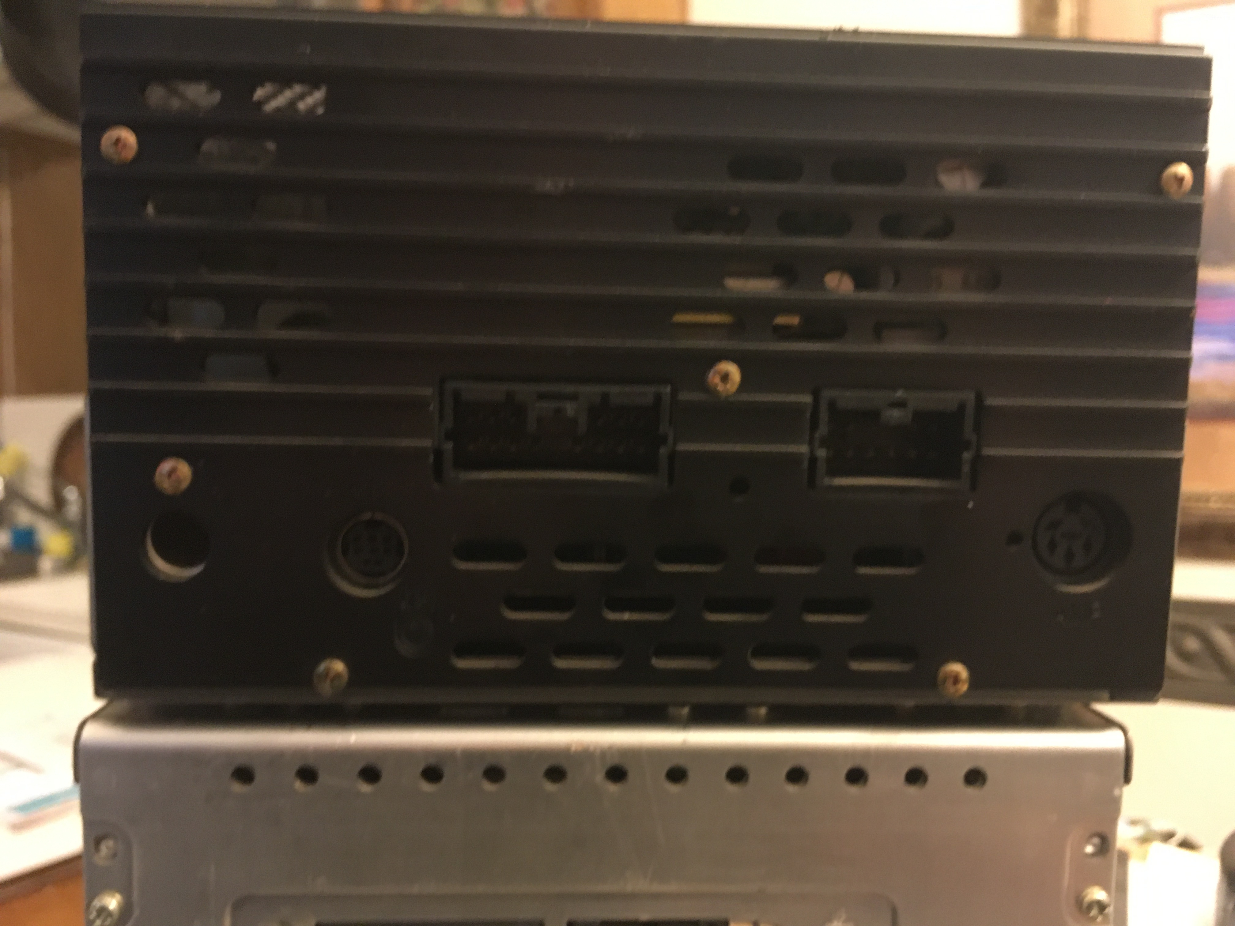

I cannot see the back of either the SC-710 or 811 unit to see what they have in the way of outputs/inputs. Can you possibly post pictures of the respective units or even of the backs of both side by side?
What other things do you have attached to the unit? Do you have an amp or CD player attached?

I'm just trying to replace the SC-710 with a unit that has an operating cassette player, so I can use a bluetooth adapter.
Pics are attached. The SC-710 is silver, and the SC-811 is black.
When the SC-811 is installed, with the amp port empty, the display reads "OFF", and it is otherwise unresponsive.
Shouldn't this 850 have the necessary plugs for either unit?
If not, is there perhaps an adapter I could use?
