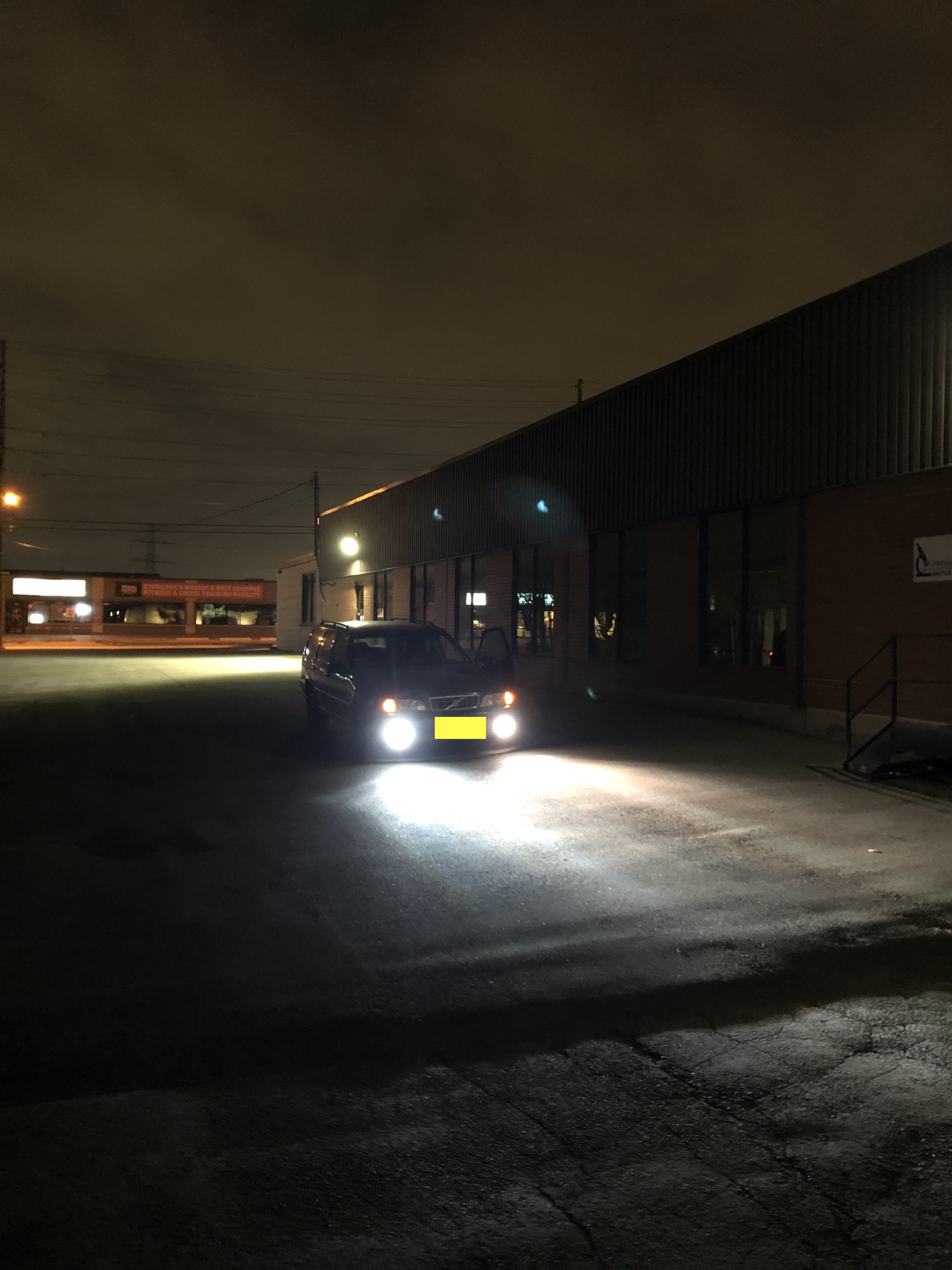

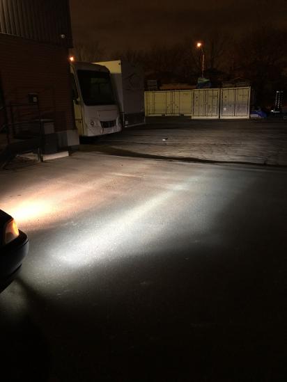

Hi Everyone,

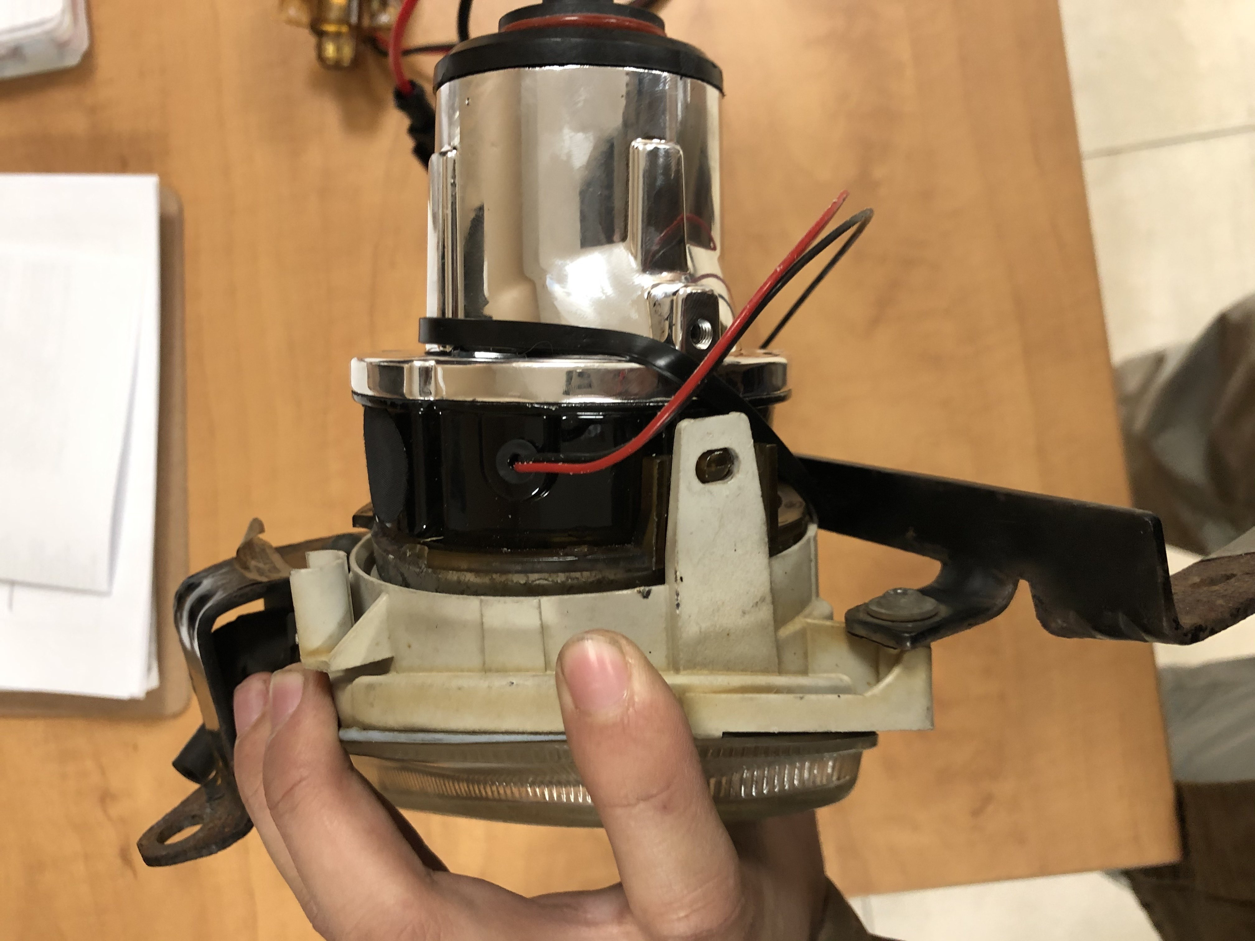

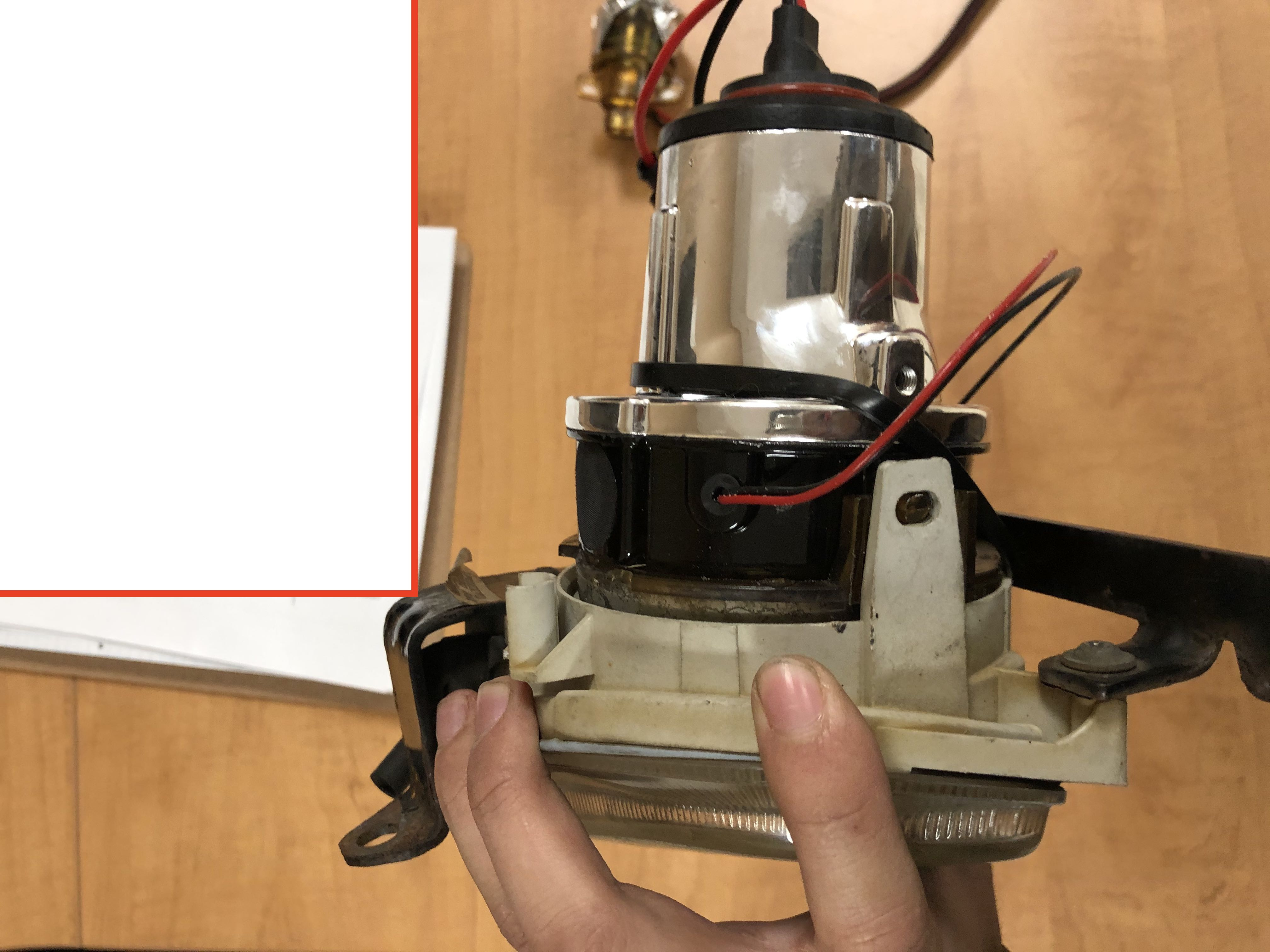

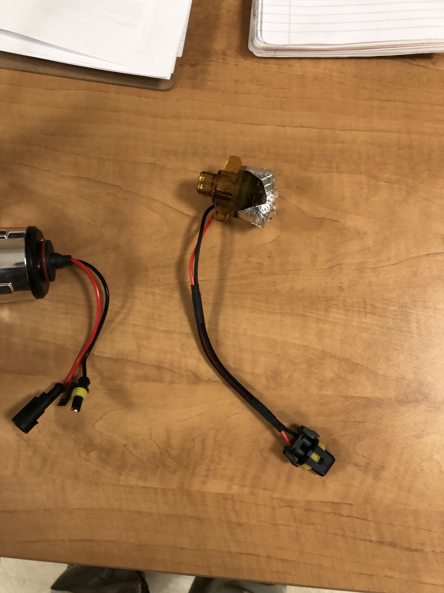

I picked up a few things for this retrofit a long while ago but didnt find the time to do it until now.

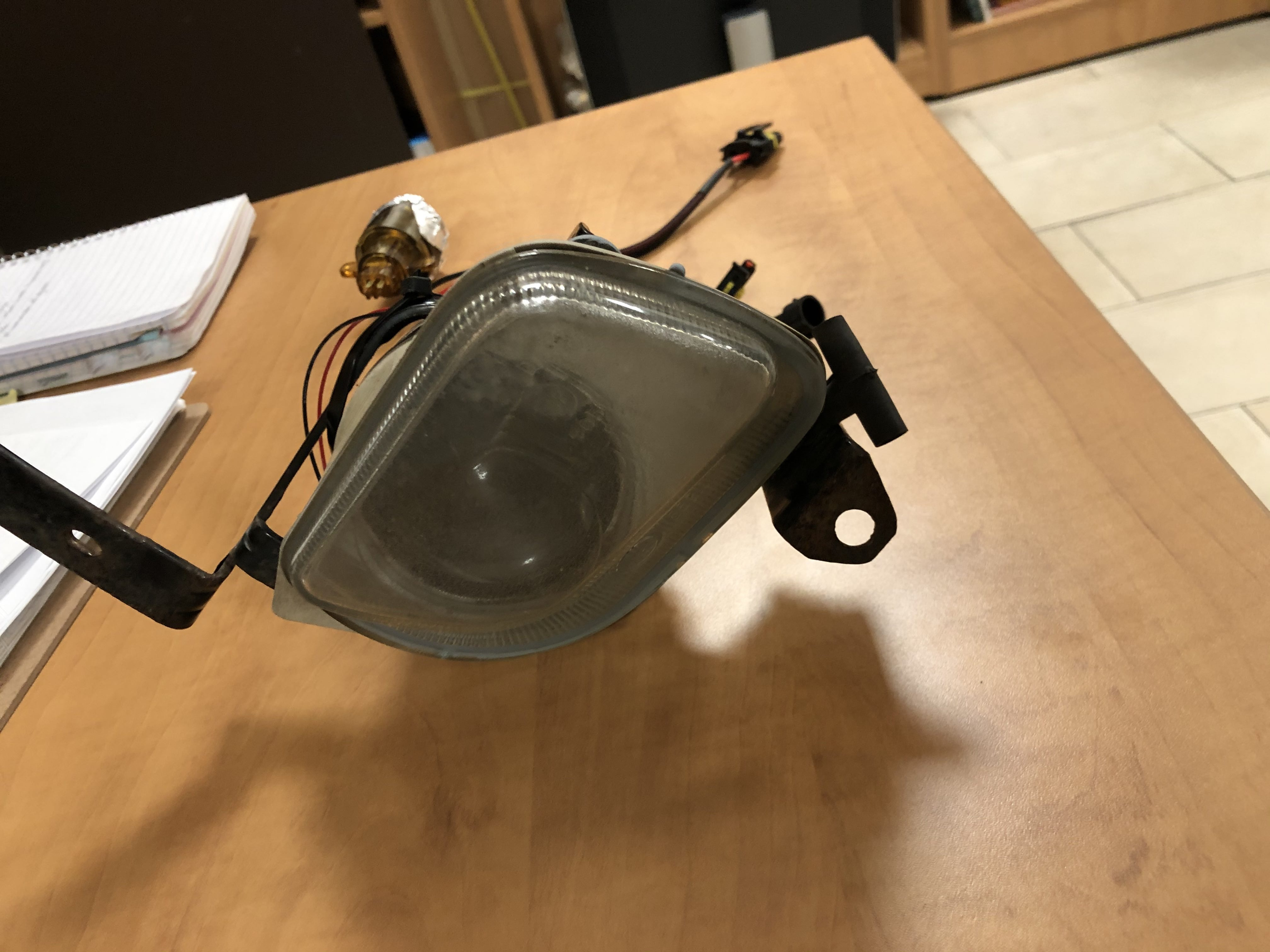

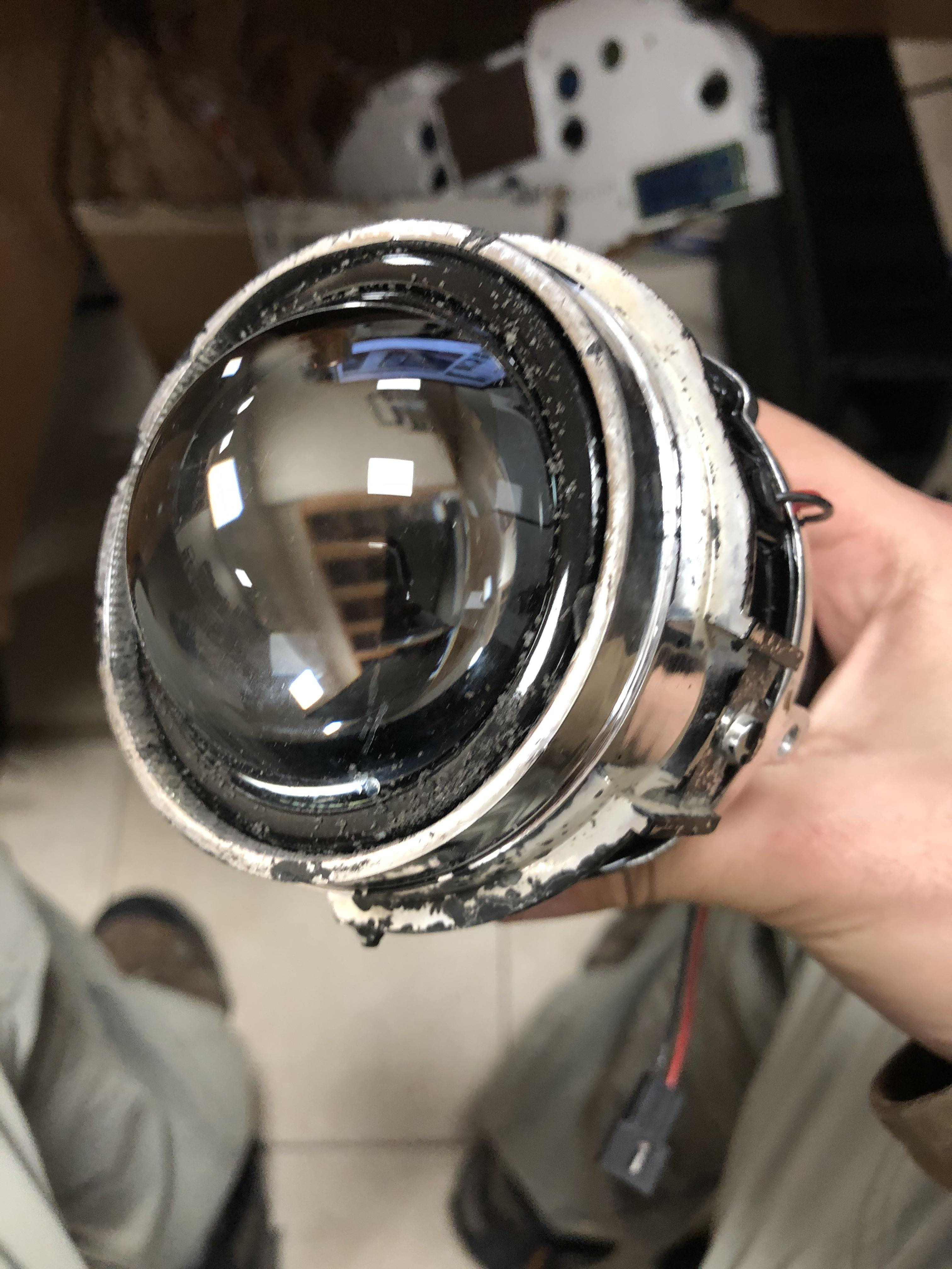

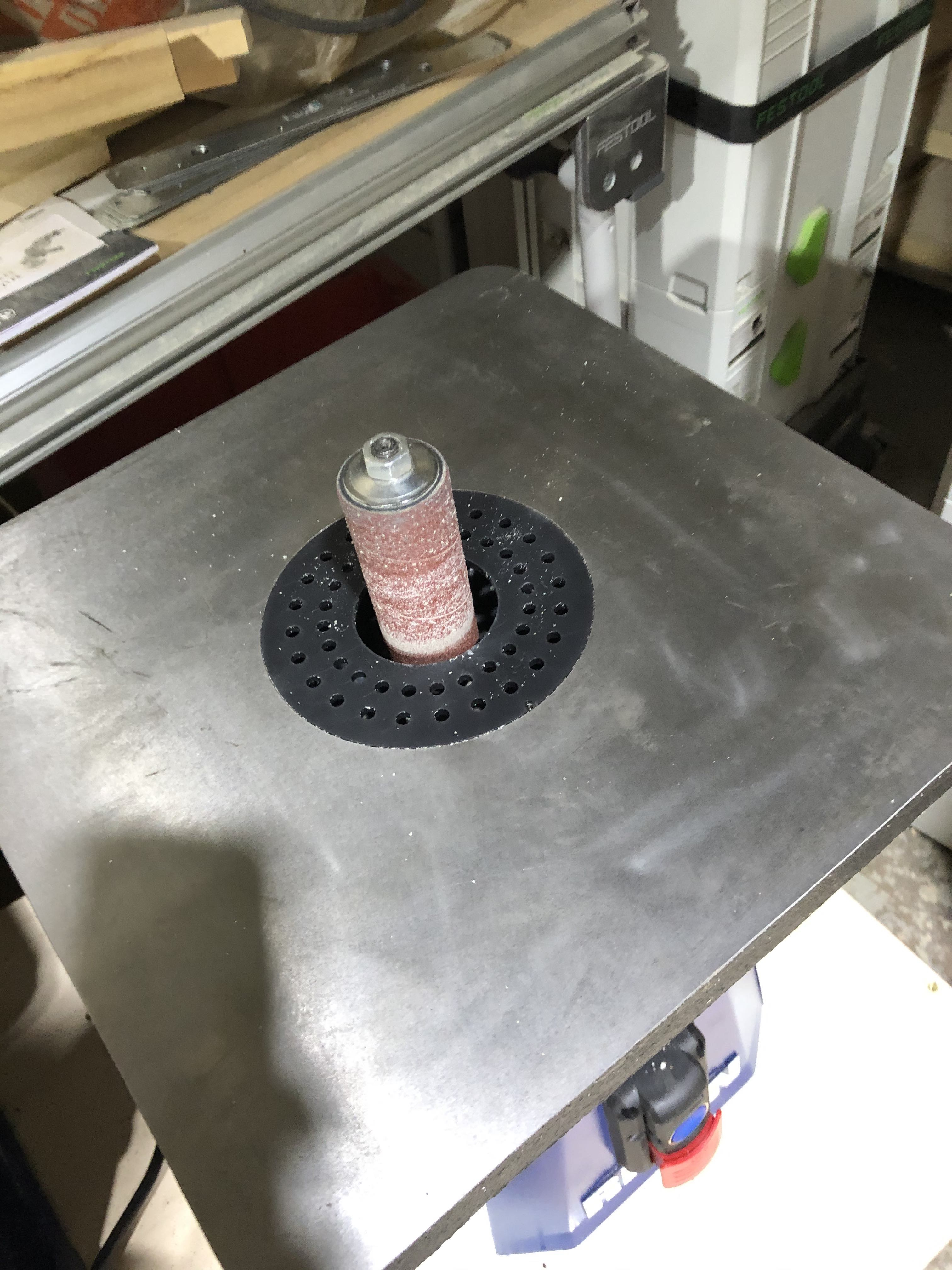

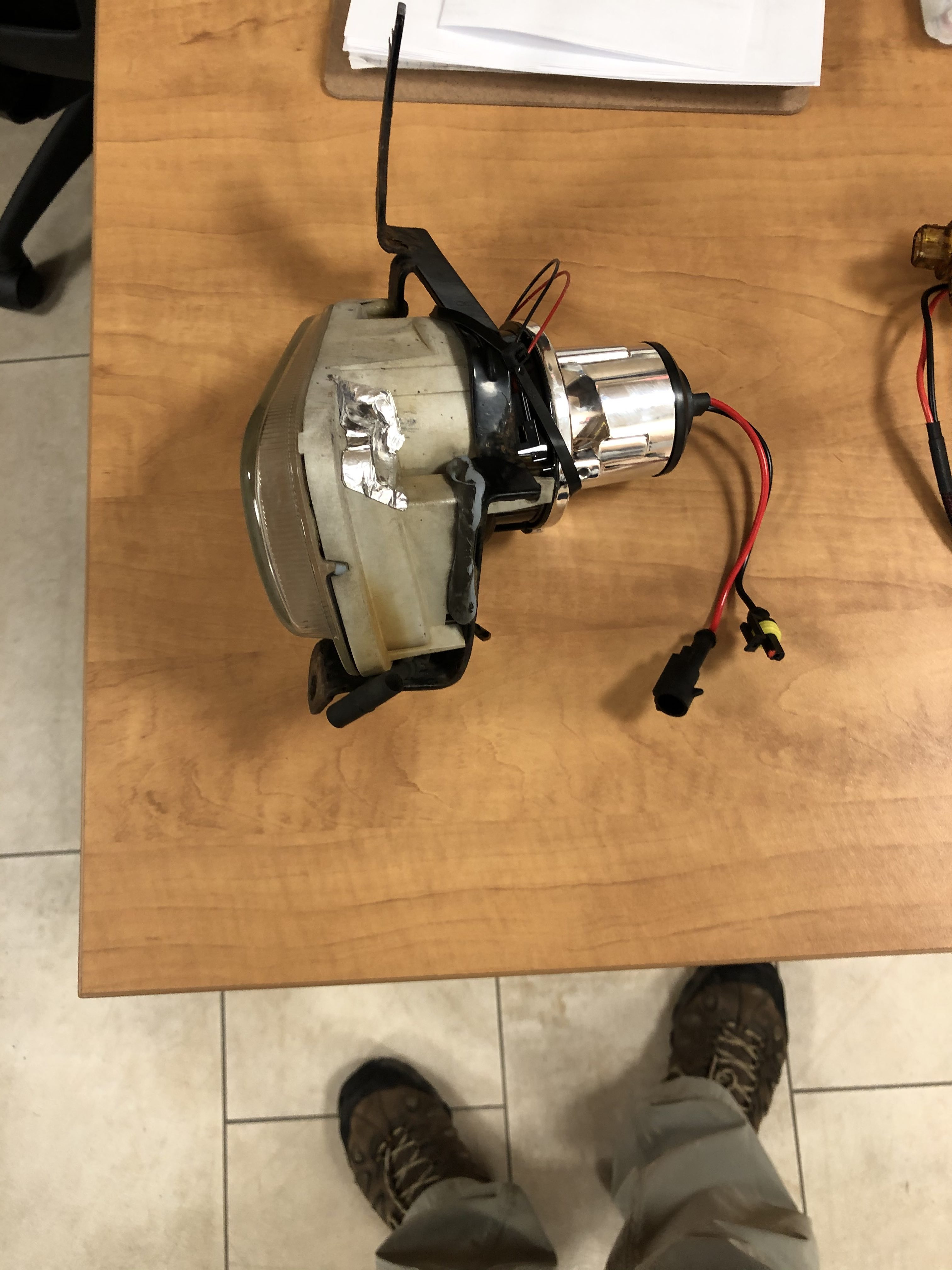

Anyways, long story short, i installed some projector lenses into the OEM foglight housings as i like there feel and mounting on the car. To do this, i took some bad reflector housings, and sanded out their interiors until the lenses would press fit in. Then i reattached the reflectors to the headlights, and ziptied them down to ensure they would not fall out. I had to add extra zipties to aim the lights but i am happy with the overall result.
I believe they could be far brighter with better ballasts and lights, but that is a test for another day. I am going to car wash the wagon today so ill see if moisture will kill these cheap ballasts.

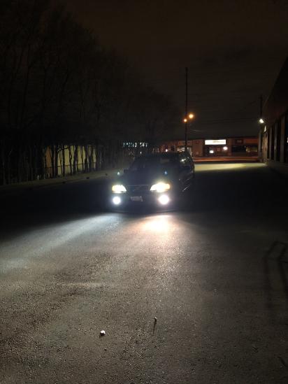

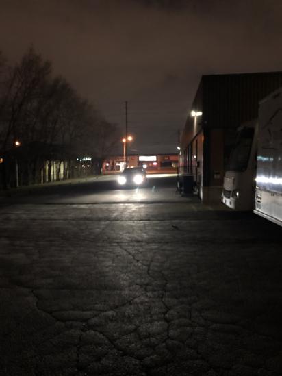

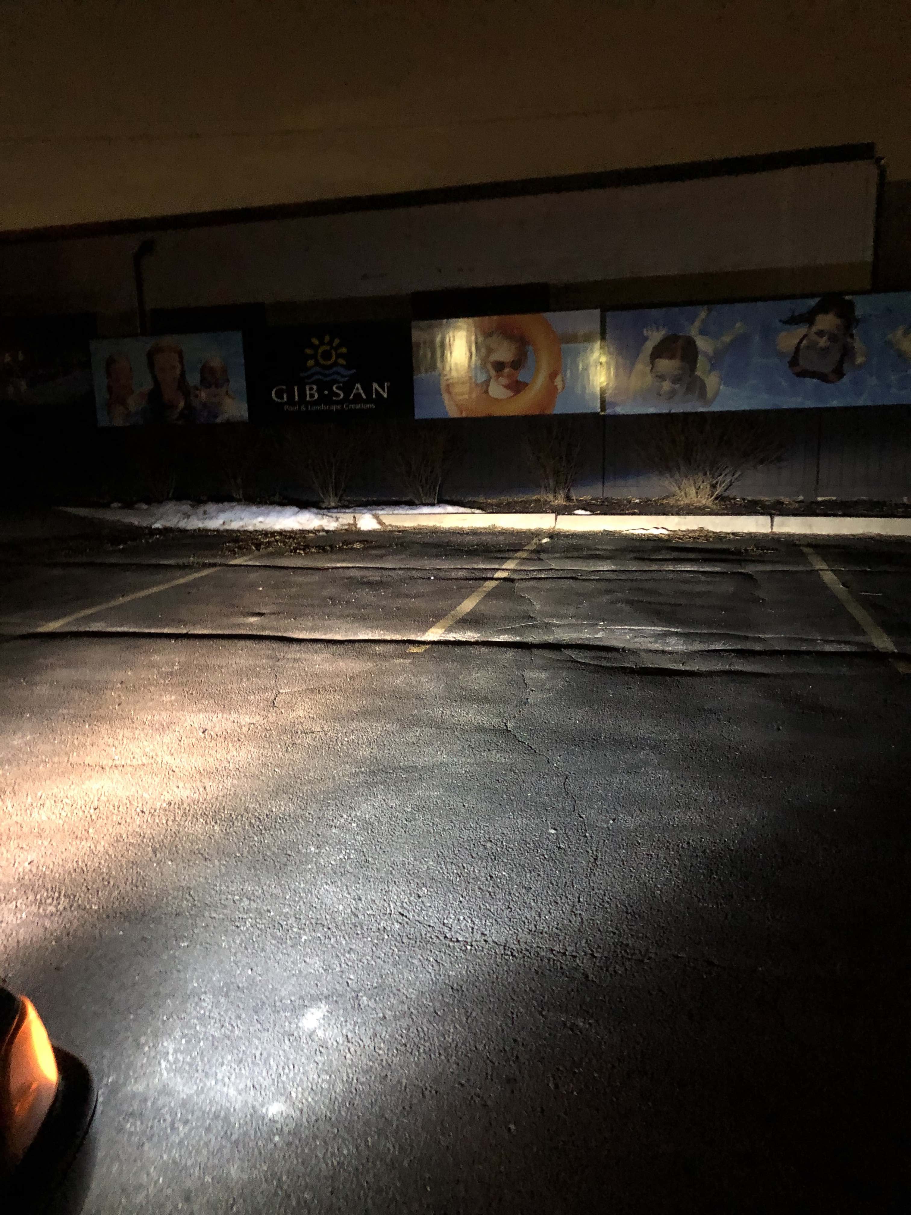

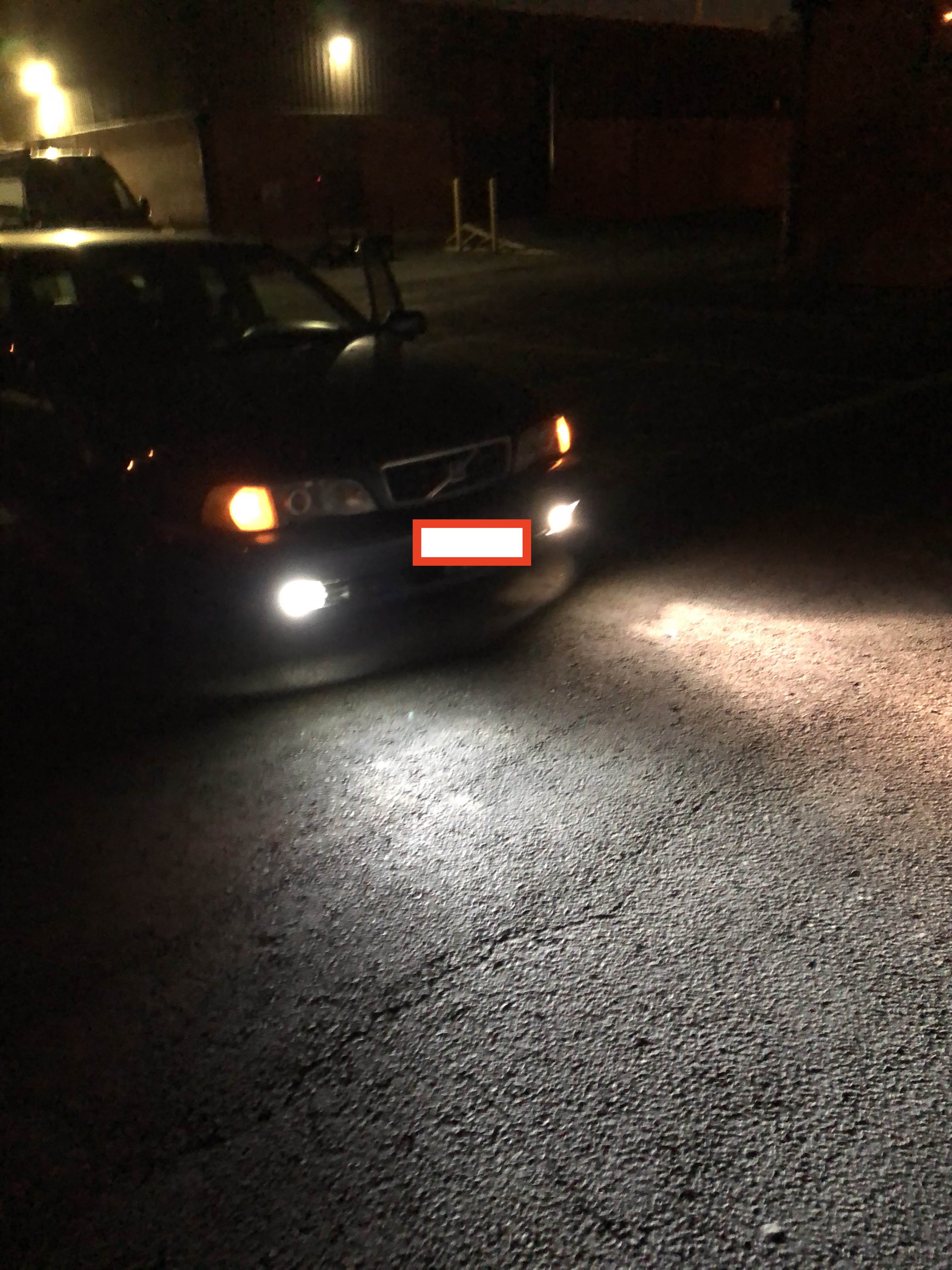

The lights are not as powerful as normal low beams, however they perfectly light up lane markers which is very helpful given how dull the road paint can be up here.

Picked them up on a website called aliexpress, attached a link.
they were like 60$ i believe although cheaper ones should be emerging
ebay has a few models, 2.5" will fit into the old lense holders if you sand it down as i did.
https://www.aliexpress.com/item/3276177 ... web201603_
I ordered these:
https://www.aliexpress.com/item/3291703 ... 5609%23288
I ordered these:

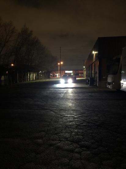

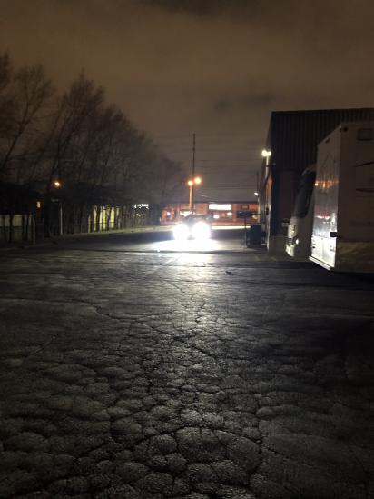

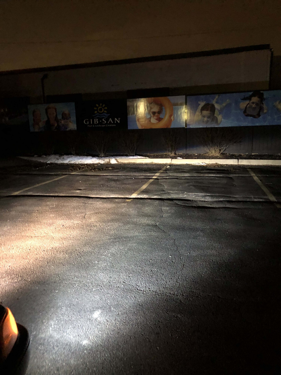

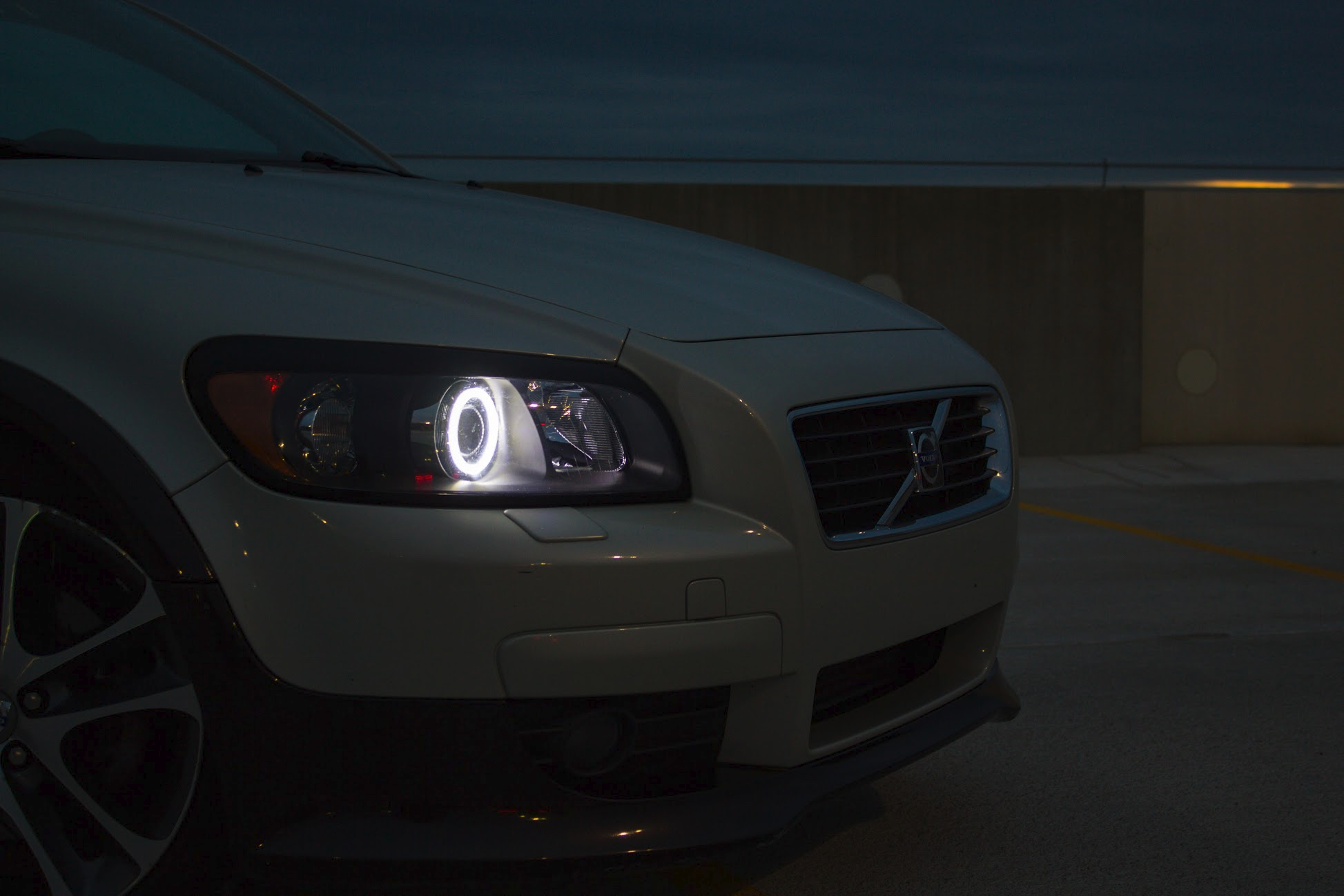

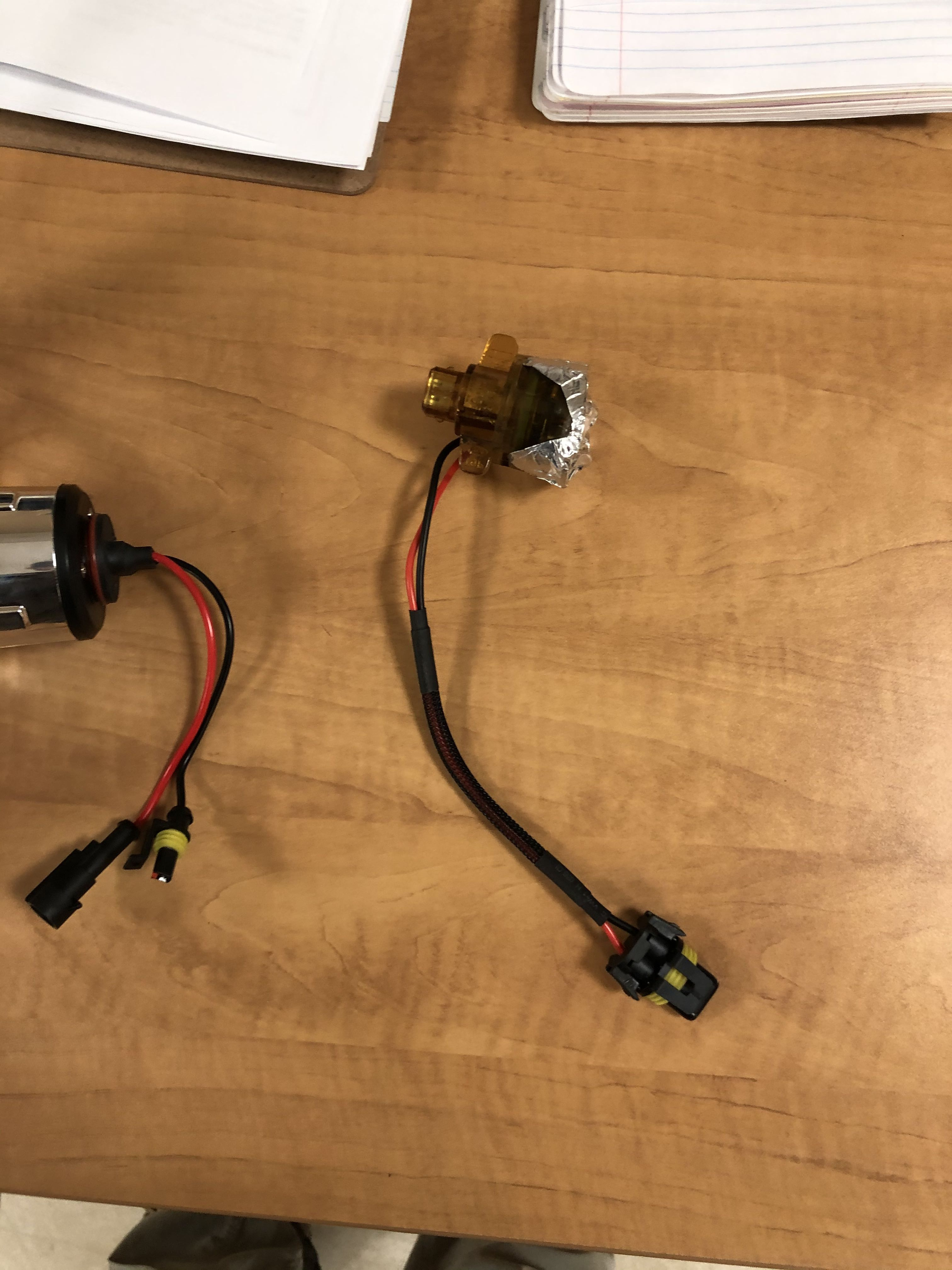

Conclusion to the saga:

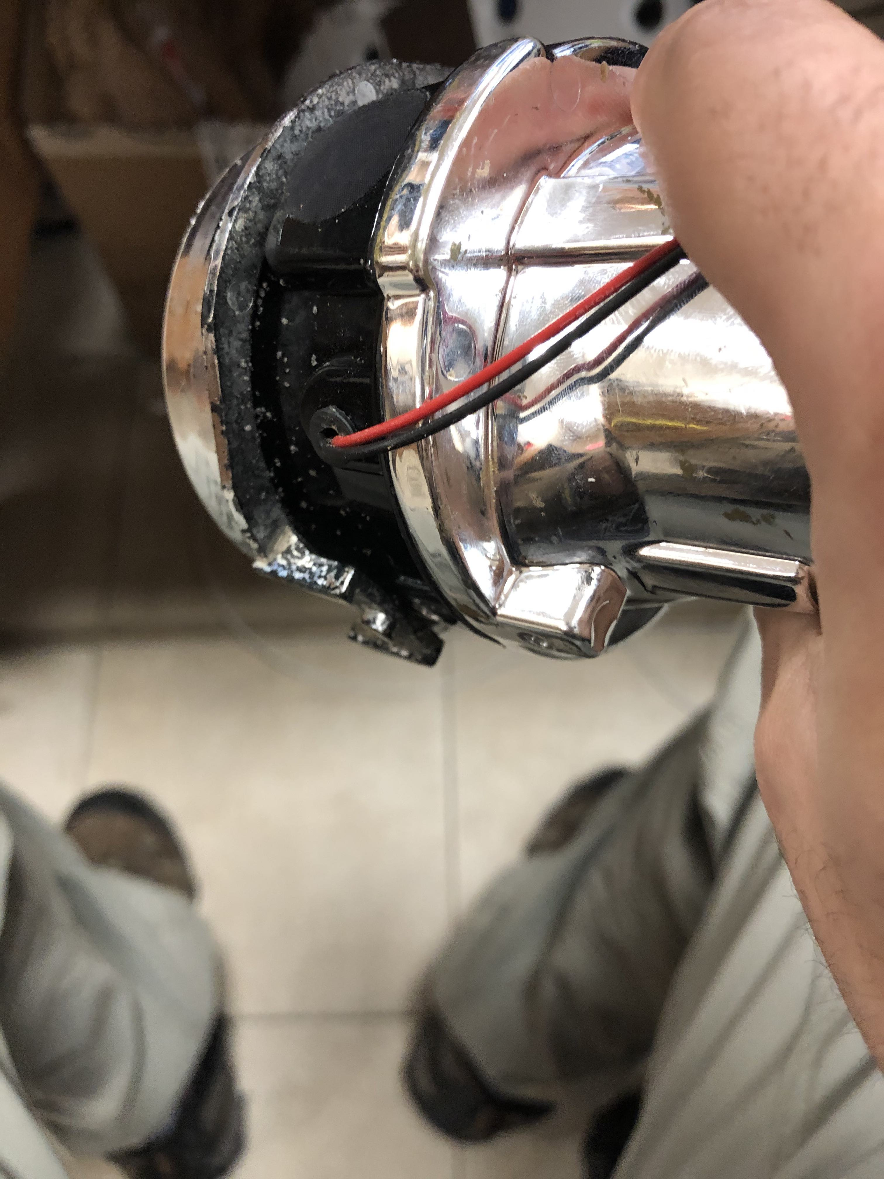

So i was not that happy with the overall lighting output of the system. I modified the projectors to enable their high beam modes. I tested them on the road and using my own judgement at varying distances and found them to be equally as bright as my normal low beams. No one has flashed me, and i do not light up the interiors of every sedan in front of me so i take that as a victory. @BEHinFBK inspired me to improve the output as my entire goal was to have effective lighting in foggy conditions.
Here are the results
