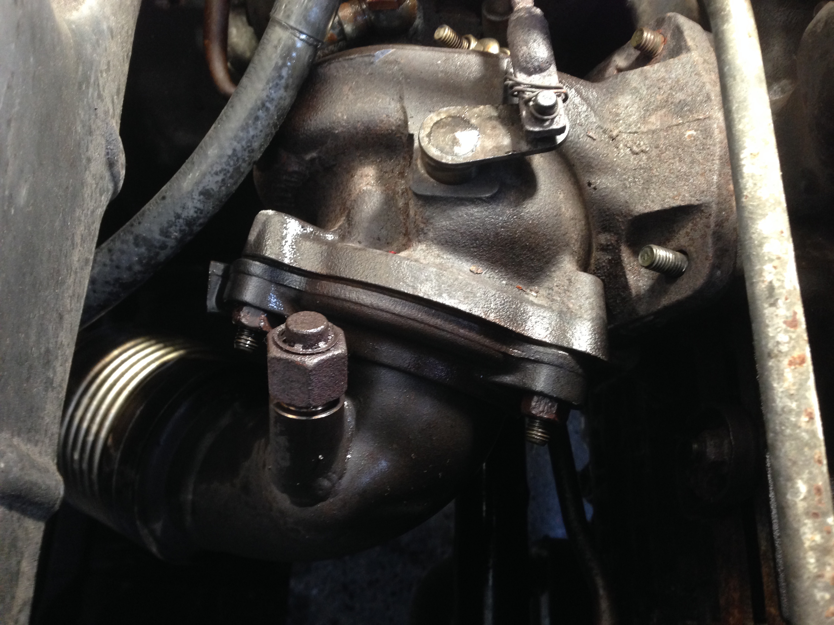

Yeah, well this isn't happening on the 1999 HPT
The manifold to turbo flange is angled up so you aren't lifitng the cylinder head from those studs

Once the downpipe nuts are removed and separated from the turbo, will the turbo pull away, maybe with some prying, from the manifold? to clear the manifold studs?
Would pulling the two studs from the manifold outlet allow me to lift up the manifold?

Yes on moving the turbo. Down pipe nuts off, move down pipe away. Now turbo to manifold nuts. Lift turbo out.
If you are smart, also line up and start your coolant hoses when you reinstall turbo, much easier than trying to work hoses onto hard pipes in position

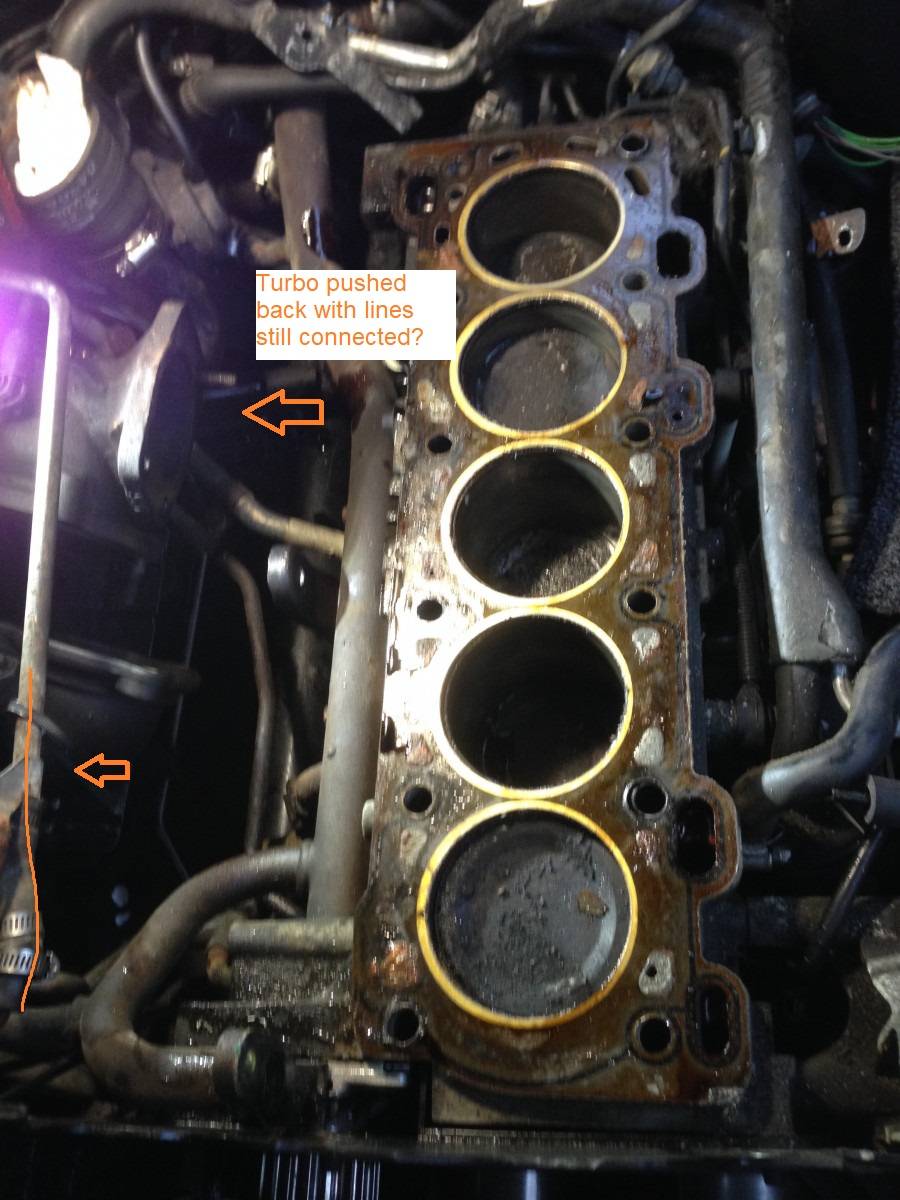

Can I get away with not removing the turbo and disconnecting the lines from it? but just pushing it away from the exhaust manifold? I saw a picture of your Elizabeth where the downpipe was detached but the turbo was still in place. I know that you pulled the manifold with the head but wondering if the turbo can somehow detach from the manifold with the head still in place.
It's blowby
- Posts: 36145
I think it has to come off the down pipe. I don’t think there is enough play in the exhaust to let the turbo come back enough to clear the studs.
Side to side maybe, but not for-aft
