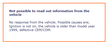

When I attempt to actually read the car, with the key in position 2 or the engine running, I receive this message:
Not possible to read out information for the vehicle. No response from the vehicle. Possible causes are; Ignition is not on, the vehicle is older than model year 1999, defective CEM/CDM
When I enter the VIN and click the Diagnostics tab, almost every computer appears in the Not Detected orange.
The Firmware Status and USB Com Status lights appear to be normal. I never see the Vehicle interface status light illuminate. My cheap Bluetooth OBD2 reader recognizes the car.

VIDA works, DiCE does not connect to car. Bad DiCE? Diagnostic steps taken inside Topic is solved

UPDATE: New DiCE unit arrived from China and works perfectly, even with my Windows 10 VIDA installation.
