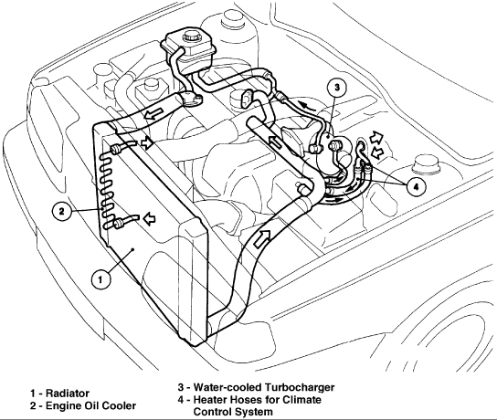

Found this on the web, too
Missing ,the later RN biscuit style oil cooler and coolant flow
- 2F496FC3-1D0E-48D2-A13D-B2B277155C19.gif (30.47 KiB) Viewed 2453 times
