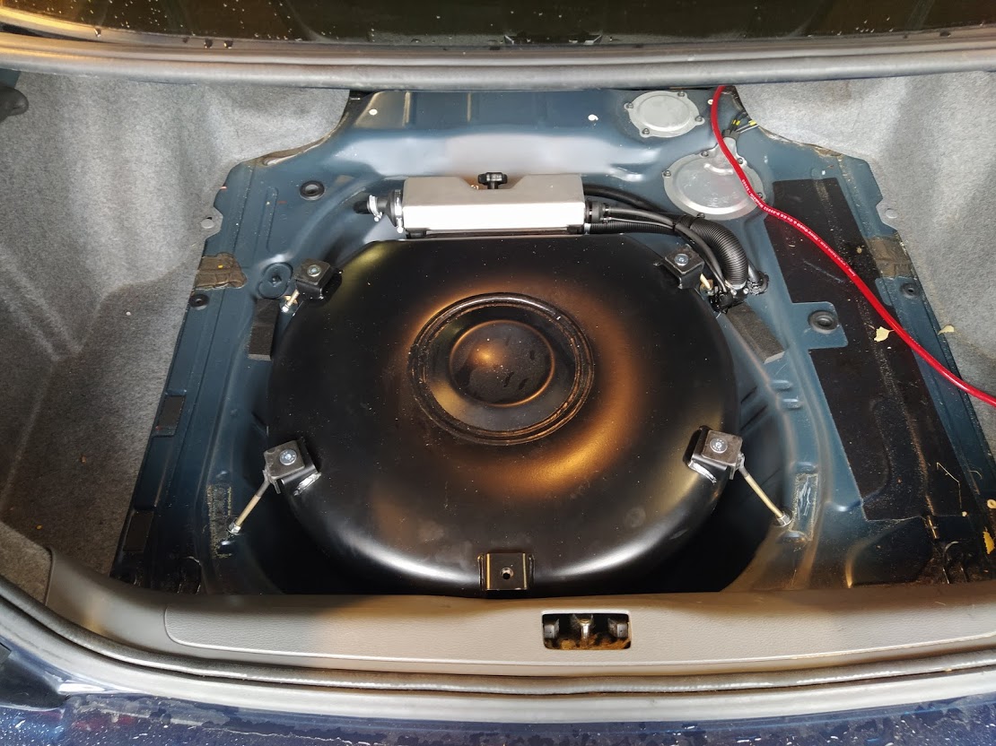

So I recently got my S70 back from the LPG workshop and I wanted to show you guys some pictures of it. I can't notice any difference in engine sound/performance whether I'm driving on gasoline or LPG so I have to say I'm quite impressed. But that's because I have an outdated image of LPG. Back in the day, with the old LPG systems, you could definitely notice less power coming from the engine when it ran on LPG. But luckily that's a thing of the past.
Here are some pictures! :)
I chose for 76 liter tank. That'll get me around 660 kilometers per tank (around 410 miles per tank). The same (or a bit less) I get on a full tank of gas (only now for 1/3 of the price :D ).

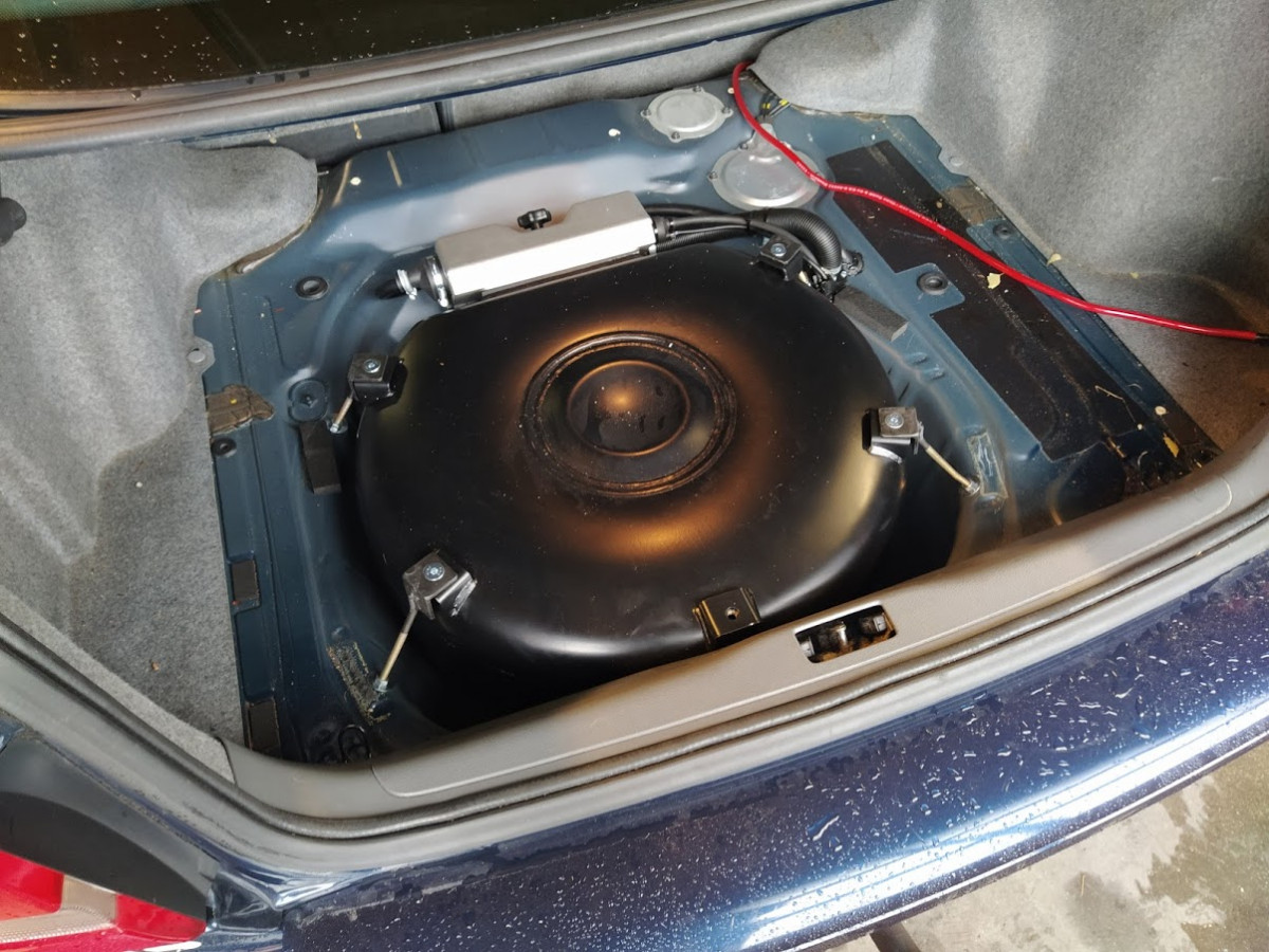

lpg tank in trunk2.jpg (193.77 KiB) Viewed 1624 times
The tank from a different angle.

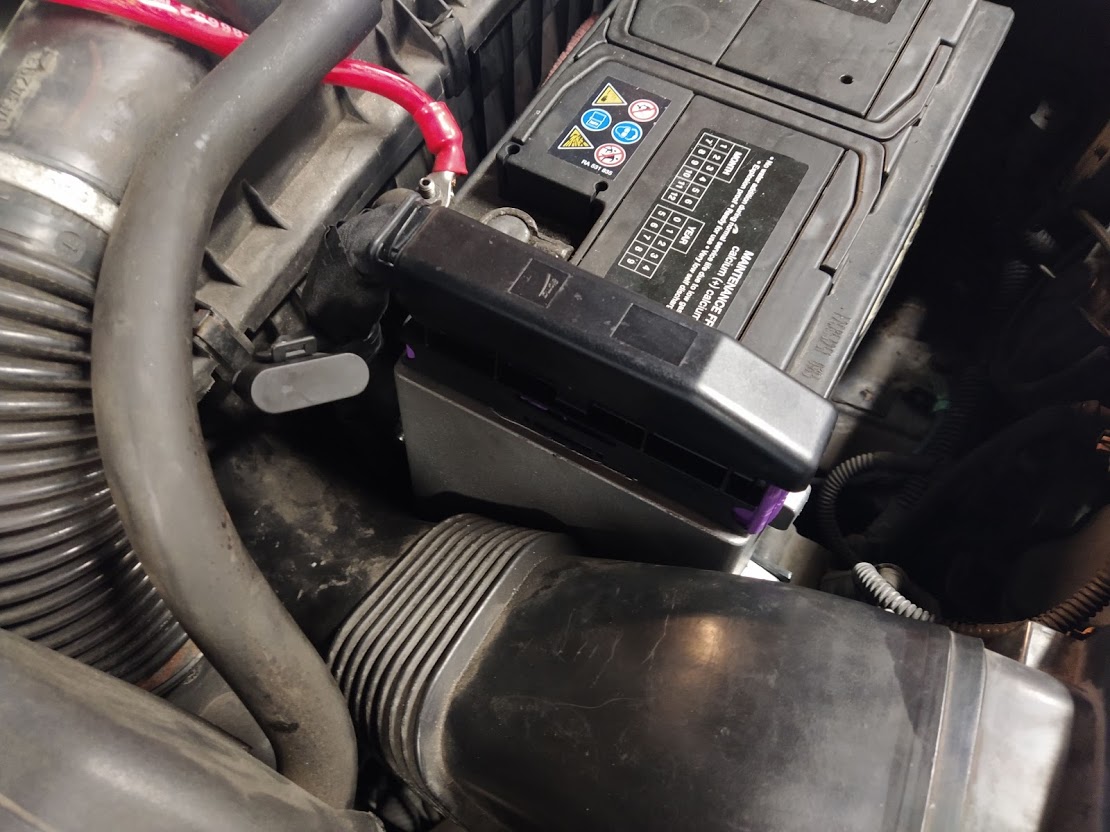

lpg ecu in engineroom.jpg (156.49 KiB) Viewed 1624 times
A picture of the LPG ecu next to the battery.

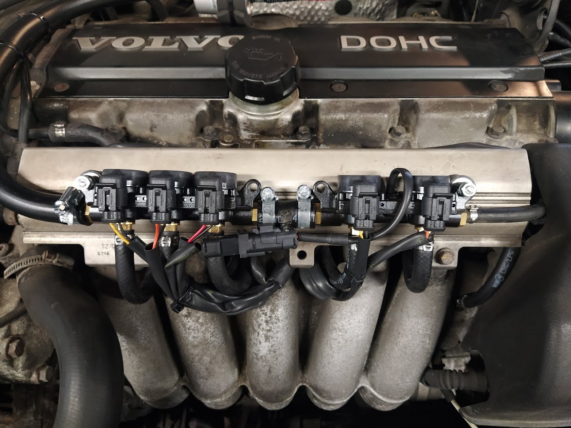

lpg fuelrail.jpg (184.43 KiB) Viewed 1624 times
The "second" fuel rail. Nicely done :)

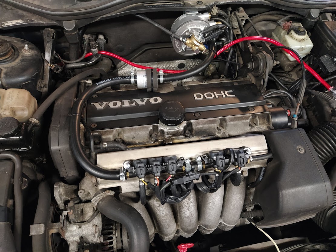

engine with lpg.jpg (229.65 KiB) Viewed 1624 times
Last but not least, an overal picture of the engine with LPG. The cilinderform object on the engine is the LPG filter. It has to be replaced every 20.000 kilometers (12.000 miles).
