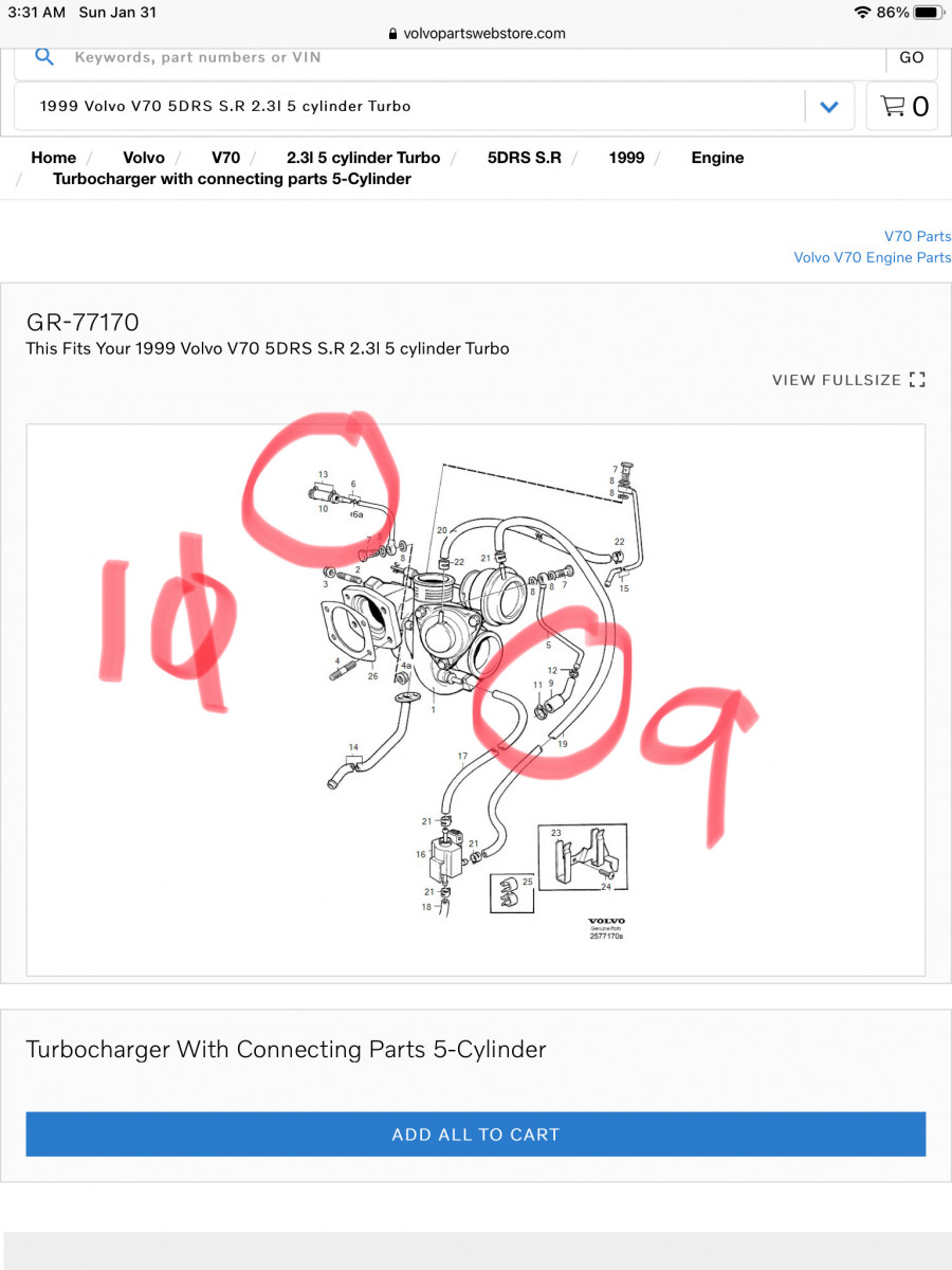

Report as of 2021 January
Some sites reporting 30713305, the return hose upper right side, as NLA
Coolant supply 9471700 is still available
I’ve ordered both and will update availability
P80 turbo coolant hoses 31439471 30713305 9471700

PN 31439471 appears to supersede 30713305.
That stubby little hose piece seems to be used on a lot of turbo Volvos over a lot of years. It is the right one for both my '96 850 and also my '14 XC70.
