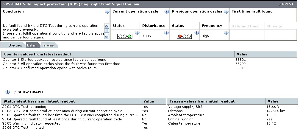

What is strange for me is the VIDA delivered informations :
if I 2-click on the default to see details on SRS-0041 for example (the same for SRS-0107)
CONCLUSION : no fault found by the DTC during current operation cycle but previously. If possible fulfil operational conditions where fault is active and can be found again.
Current Operation cycle : GREEN
Previous operation cycle : RED
Historical graph indicate DTC happens in the past, 32 000+ cycle ago.
The STATUS IDENTIFIER indicate :
SI 01 DTC test is running = YES
SI 02 DTC Completed at least once during current operation cycle = YES
SI 03 Sporadic Fault ... last time ... = NO
SI 04 Sporadic Fault ... current .... = NO
SI 05 Warning indicator requested = YES
SI 06 DTC TEST INHIBITED = YES
This last SI seems to indicate that the default is permanent because ECU won't pass the test anymore ???
I think there is no real world problems anymore, but CEM keep the memory of the trouble and refuse to pass the test anymore ?
I don't know if my understanding is correct.
I can't imagine the way out of the nightmare.
How can I clean this AIRBAG DTC ?

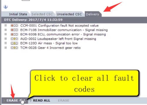

Click on Delivery Tab, click on Erase All, click Ok to confirm erase and take a screenshot your current errors codes after this procedure.
- vida_delivery_tab.png (134.84 KiB) Viewed 2616 times

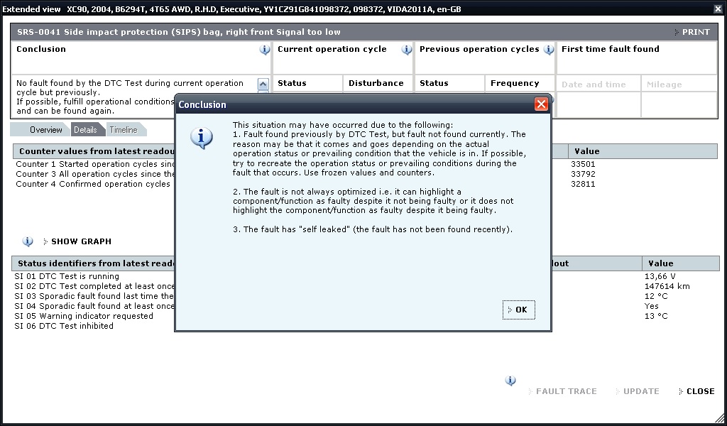

Details indicate
- B.jpg (131.6 KiB) Viewed 2611 times
- Richard III -
RichardIII
- Posts: 9
- Joined: 08 Jan 2021, 03:19
- Year and Model: 2004 XC90 T6
- Location: PARIS FRANCE
This interesting message is displayed, but I can't understand what to do ...
- D.jpg (172.78 KiB) Viewed 2611 times

At the end of the 2nd attachment, you can read Status Identifier #6 of the DTC (all the same) :
- SI06 DTC test inhibited
I'm not a wizzard at all, I've start to use VIDA for the first time few weeks ago.
So I asked myself if electonic system block reset ?
Any advice of experienced user is welcome ...
I have no idea of what to do in a clever way.
As I explain previously, I have unplugged the front right connector on yesterday and launch VIDA.
DTC are the RED, not YELLOW.
The I plug again, and launch VIDA, DTC are YELLOW, and detail icon is GREEN for actual status.
So I think real world wiring is now OK, and it is a electronic module that avoid reset.
32000 cycles have record the DTC, so maybe a counter pass a memory to "persist default" ???
Any experienced VIDA user can explain the last screenshot of VIDA :
- How can I use "Frozen values and counters" ?
- What is the final process to withdraw the DTC ?

Your posted cycle readings are 33501, 33792 and 32811. Have they changed at all? Run the vehicle a few times and see if any of the figures go up. They should.
Report back.
Report back.
RichardIII
- Posts: 9
Vehicule run "On Demand" this week
The values are not the same for DTC SRS-0041 (for example, the same as previously)
