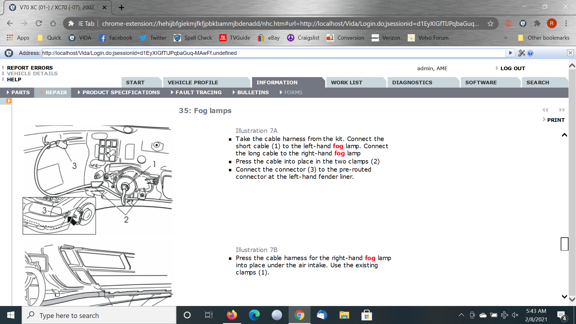

The "mounting bracket" is integrated into the bumper cover. Screws and clips hold it on to the bumper cover.
- 1. The blank that is in there now should have all the mounting hardware you need.
2. You will need to change the light switch or install a fog light button and lamp in the switch that is there.
3. I think you will need to install a relay on the CEM for the fog lights.
4. You will need to set a flag in with VIDA so the CEM knows fog lights are installed. This does not require a software reload. You change the settings of the software that is installed. This can be done with a DiCE clone.
