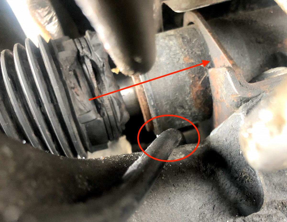

I was using a zip tie previously, but it broke off a while ago. Even still, I wasn't able to get the boot properly into place (i.e. slid all the way back around the rack) with all of the obstructions around that side of the steering rack. I have a proper Genuine Volvo clamp to use, but at this point I'll probably also need to replace the boot because of how chewed up it is. I did tried turning the wheel so as to compress the boot all the way, but even still I was unable to maneuver it around the flange on the steering rack. It seems like maybe moving the plastic line that's between the subframe and the rack would help, but I'm not sure how to do that.
All these circled obstructions make it pretty difficult to get hands in there to maneuver the boot on all the way.
Just wondering if other people have had this difficulty, and if so, how they overcame it.

You need to rotate it as you push it on. Secure the outside after you secure the inside. Leave the clamp pushed up towards the tie rod.

Have you tried from underneath the car - like sliding yourself under the car (support the car safely), and slide you hands by the subframe ? As you mention, the boot is already chewed, I wouldn't risk it, the slightest crack will cause the rack surface to get rust which will chew the rack seal on that side.

It may be that the end of the boot is currently so distorted that it just won’t slide on. I should plan to replace the boot later this year, of course that means removing the outer tie rod, lock nut, and getting an alignment again.

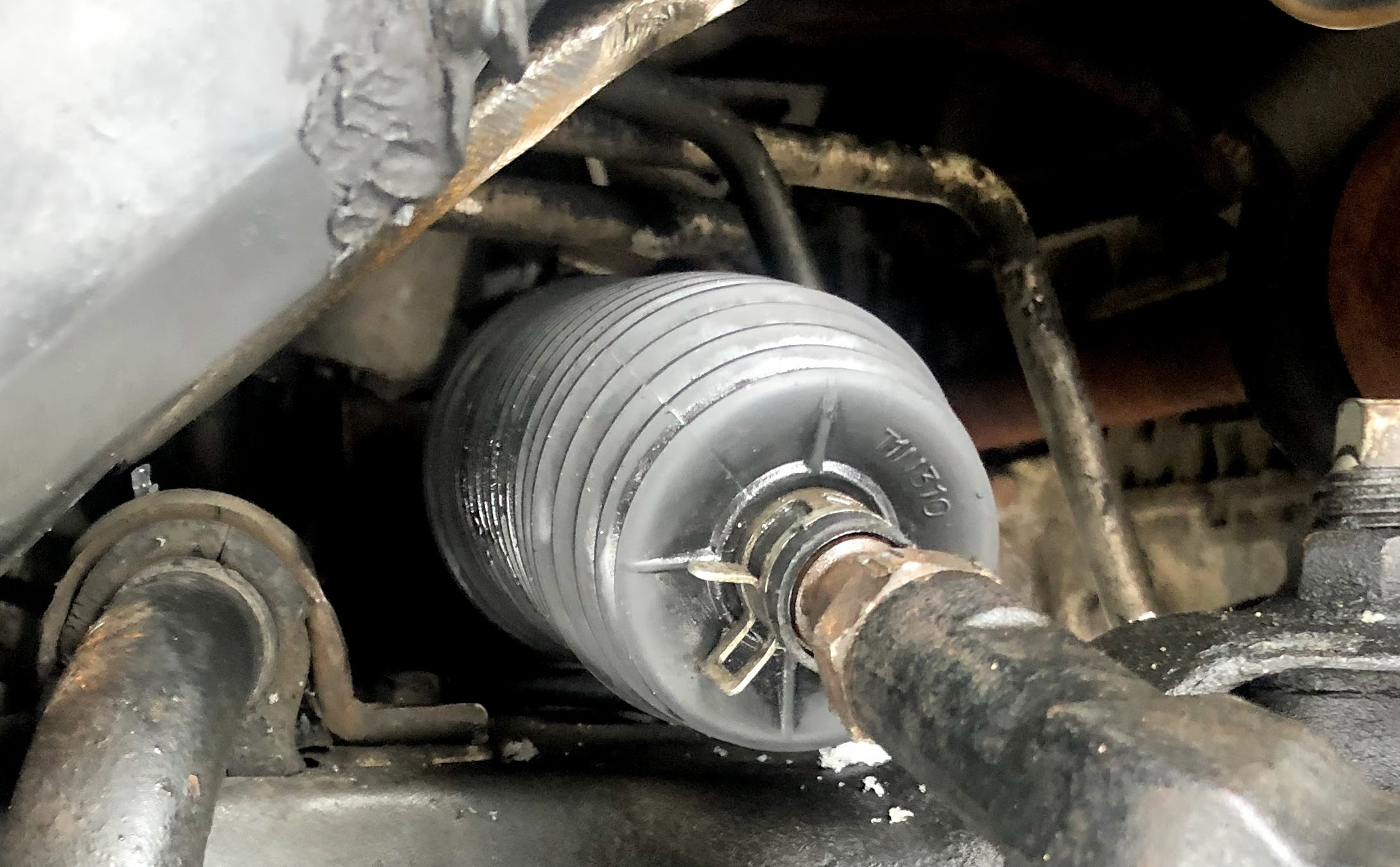

I have tried from under the car (that’s where the second photo was shot from) but it doesn’t make it easier to access.
It will probably just be easier to do it with a new boot and also later when the weather isn’t so cold and snowy.
