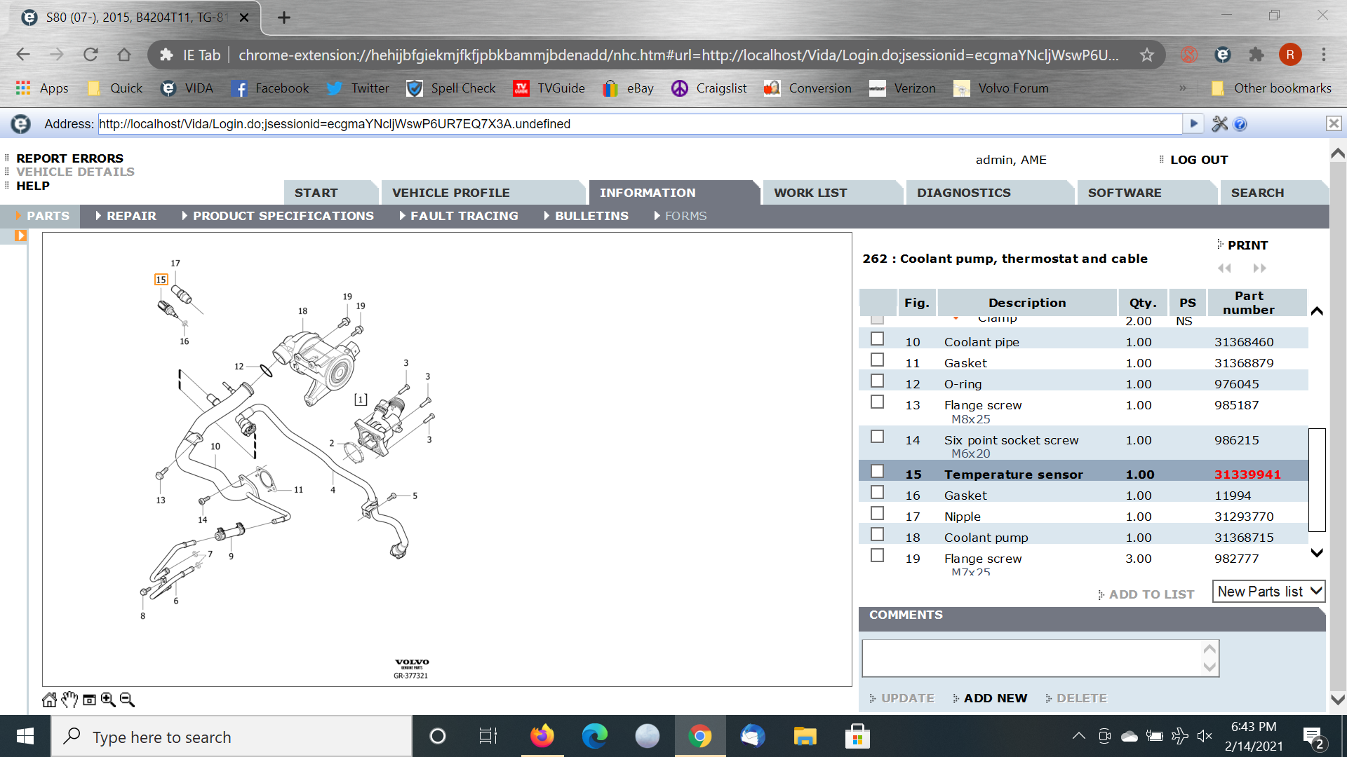

I'm looking to find the coolant sensor location on my 2015 2.0 engine. I found the thermostat housing which seems to be deeply buried but no luck on the sensor. I assume that its close to the thermostat but I prefer to not disassemble until I Know for sure. Would anyone know were it is? Thanks!

It is mounted in the Coolant pipe.

I found it based upon that drawing! Thank you much for the information. I would have looked forever! Scott
