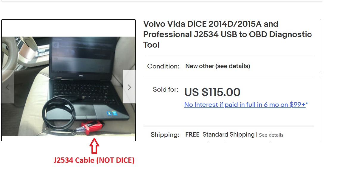

Asking for a friend bc I cannot find inexpensive DICE Units on ebay.
I have the old-school DICE and Vida on a laptop.
A friend happens to see on ebay: J2534 Cable + Flash Drive (software in it).
You install it on your own laptop.
Has anyone here used this setup of J2534 Cable + Vida on a laptop?
Pros on cons of this J2534 vs old-school DICE?
Volvo VIDA J2534 Cable vs DICE?

That looks like a Mongoose JLR clone (Jaguar/Land Rover). You can find them for $40.00. They do work with VIDA and Volvo. If you have a 64 bit operating system most likely you will need to download the 64 bit drivers from DrewTech's website.

"For all vehicles with model year 2004 and later, equipped with OBD and reprogramming capability, manufacturers shall comply with SAE J2534. There are two different versions of J2534:
J2534-1 can be used to download software to vehicles from, and Including, model year 2004. J2534-1 manages software to control modules on CAN HS (Controller Area Network High Speed) that are emission related.
J2534-1 cannot be used for diagnostics.
J2534-2 manages software download to control modules on both CAN HS and CAN MS (Controller Area Network Middle Speed)."

How about $36.00 with free shipping. They ship from China. It does take some time for them to arrive.
If you Windows operating system is 64bit. Download the 64bit drivers for MongoosePro® JLR from Drew Technologies.
