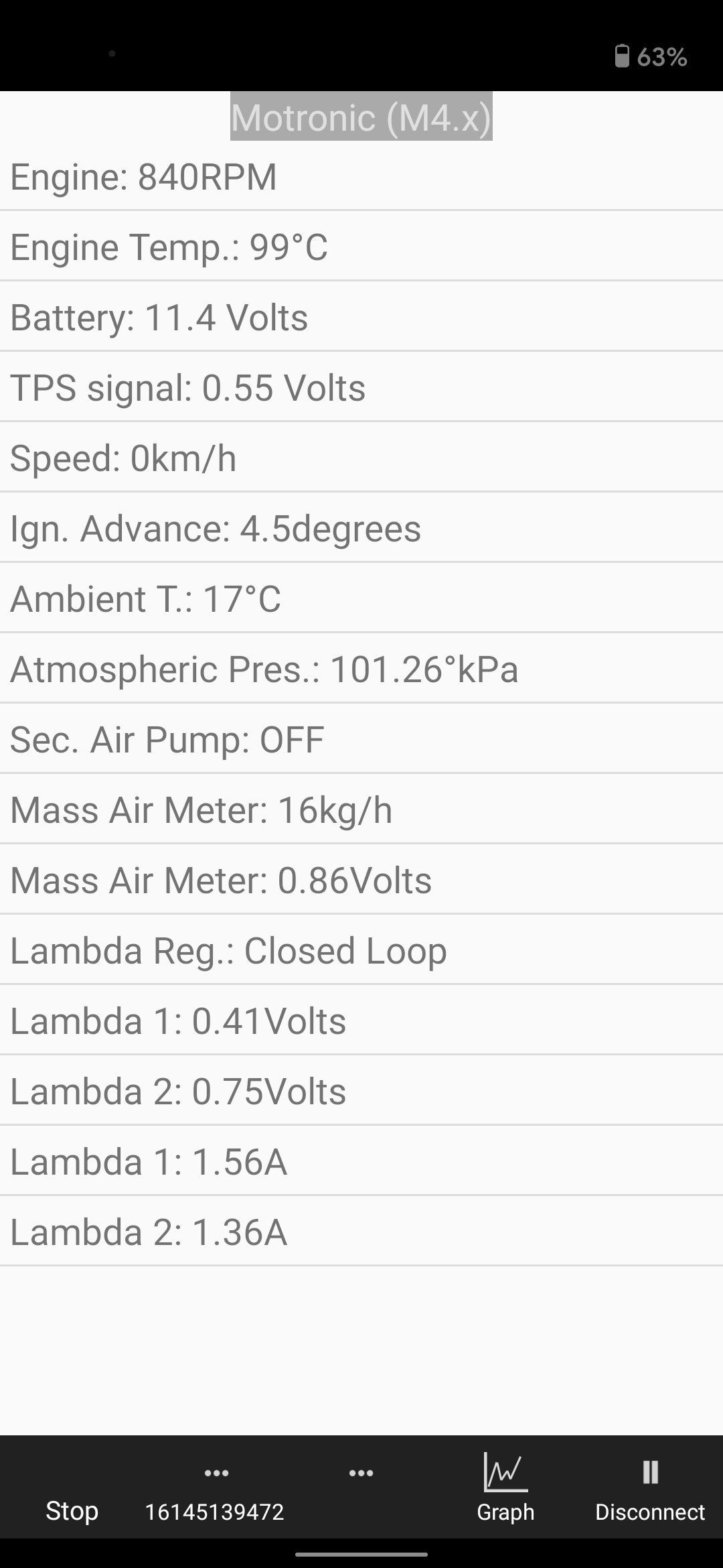

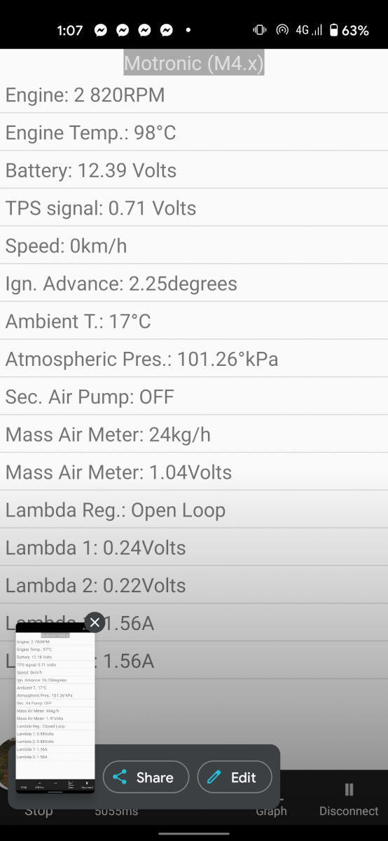

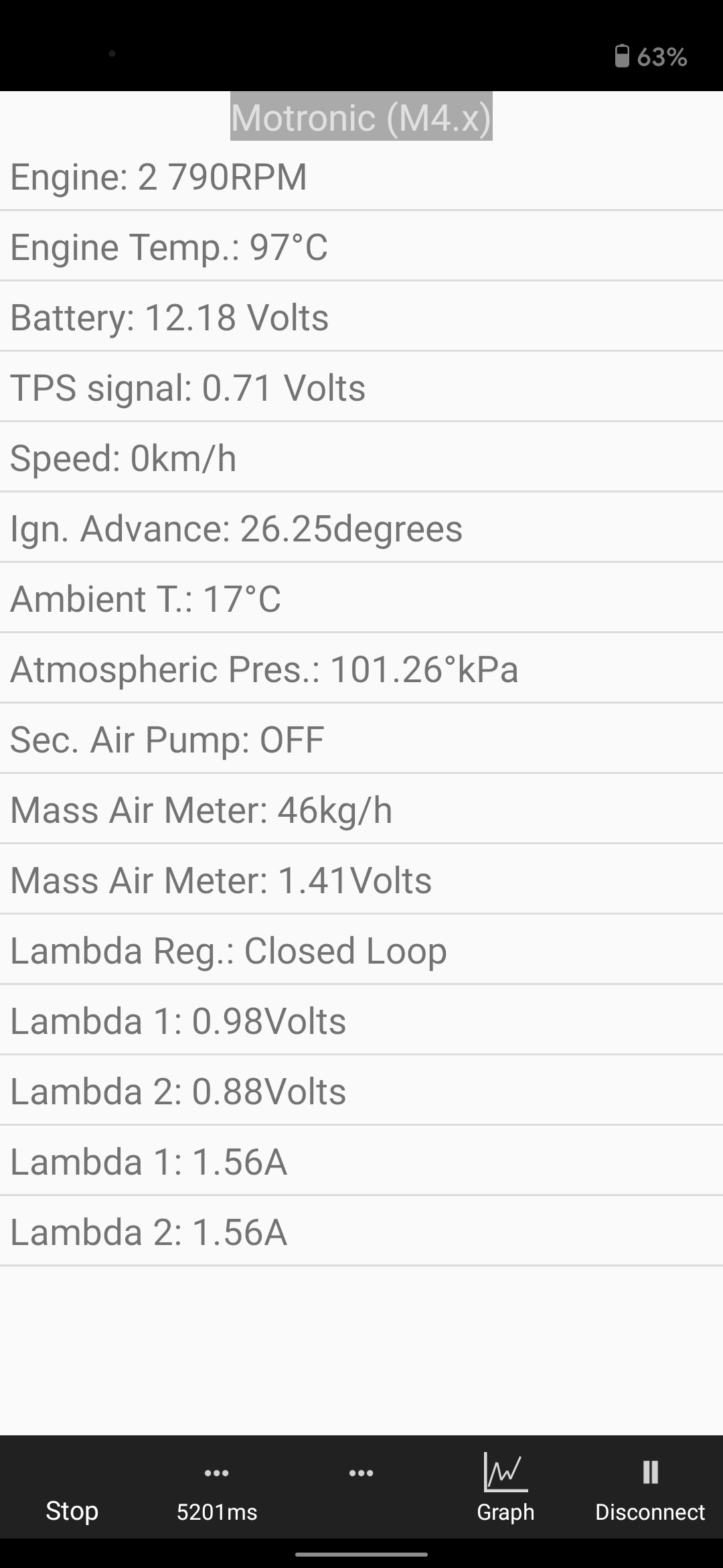

Piggyback removed, front lambda sensor replaced, new pierburg tcv installed, new Bosch injectors.
Everything is the same as before (lambda and Injectors fixed some stumbling at idle) ie. drove perfectly fine for 15km after resetting the ECU and then the hesitation at WOT came back.
Still haven't checked the fuel pressure but I don't see how that would explain the fact that the engine runs fine when the ECU just got reset.
It's boosting consistently at 0.9 bar without any spikes.
One thing that's been puzzling me is that my fuel trims are stuck at 0% (using torque pro and xanthefin's app 850-OBDII).

Fiodor wrote: 27 Feb 2021, 09:39 One thing that's been puzzling me is that my fuel trims are stuck at 0% (using torque pro and xanthefin's app 850-OBDII).
Sounds like the ECU is sticking to open loop :?:
Maybe a bad O2 sensor ?

I replaced the front O2 sensor with a bosch universal one yesterday.
Fixed some stumbling at idle but didn't improve the stutter condition.
And monitoring shows that the car stays in closed loop when I'm not pressing down on the gas pedal too hard.
