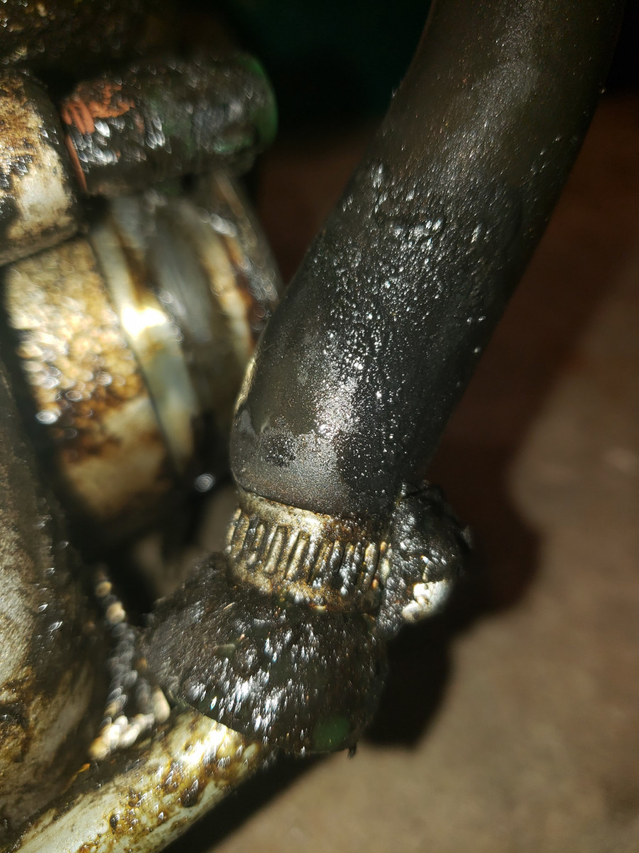

If you're poking around the turbo however, the coolant lines are susceptible to swelling and disintegration after time and mileage. They're kind of a pain to get to on most models, especially AWD, but they are worth inspecting.
This is what I found on the 1997 850 I rescued. Not sure how long this had left, but I'd wager not much.
