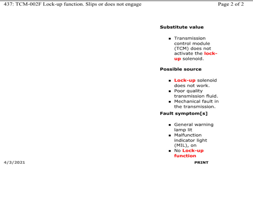

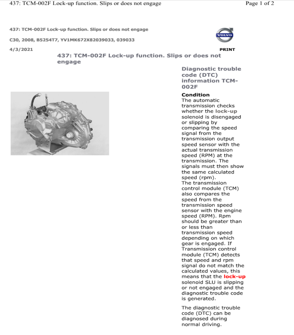

Well, got some deeper code reading:
might do rain and fill, but ill share here where its at now on codes, and going to the shop to get estimates. hope its not $$$...
note. C30 2008 v2 turbo, Automatic transmission.
IMAGES:
CODE P0811 = TCM-002F

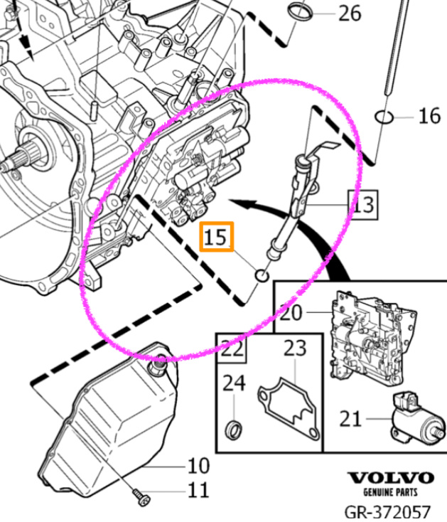

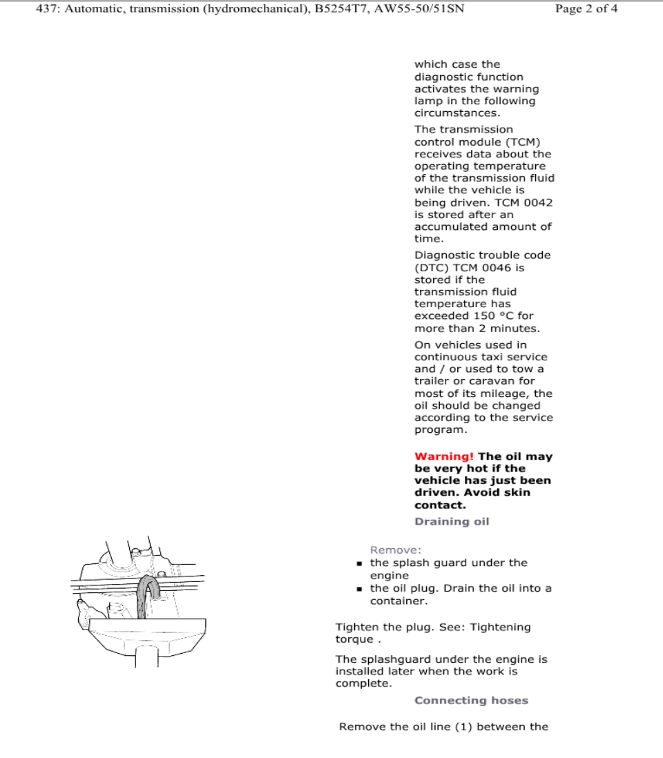

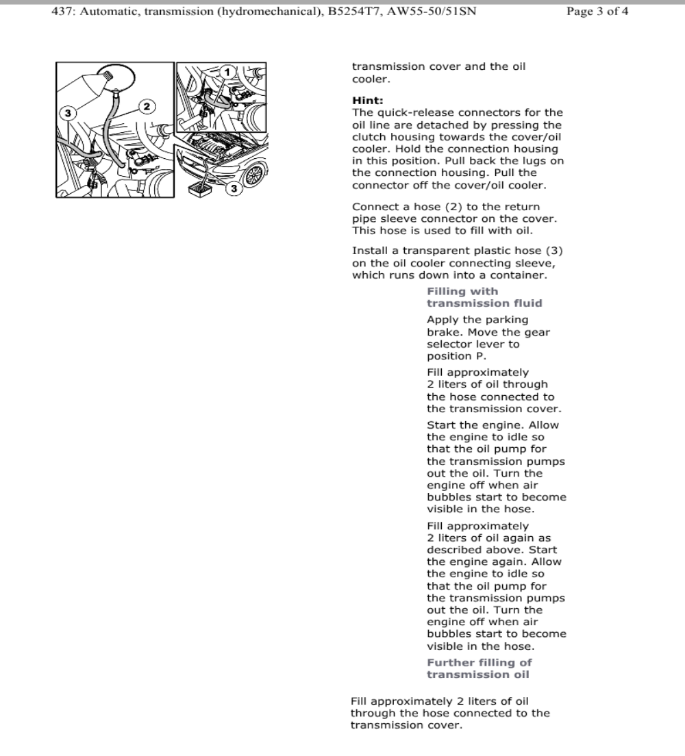

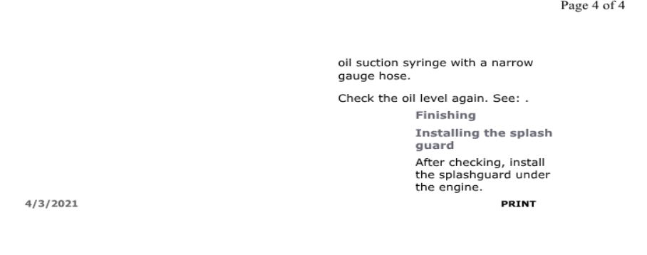

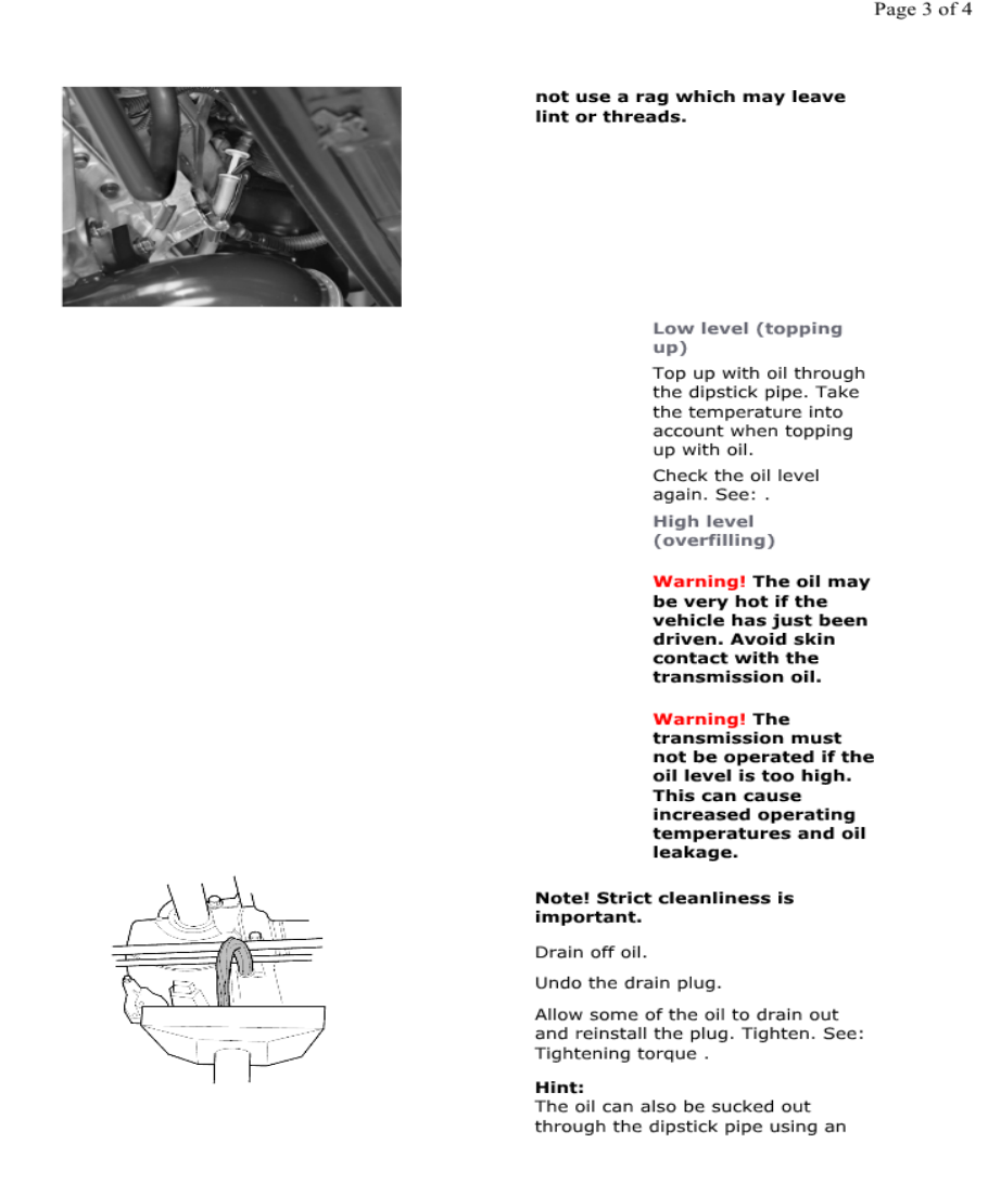

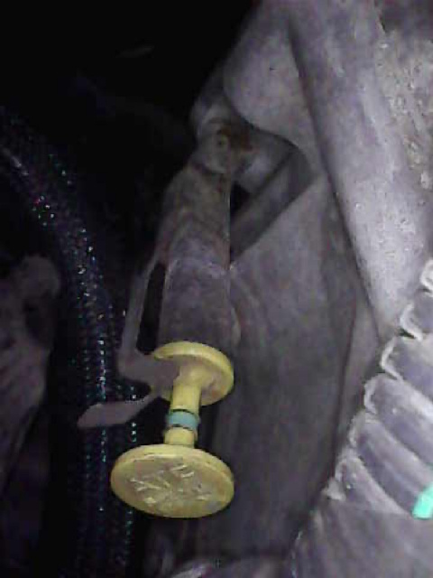

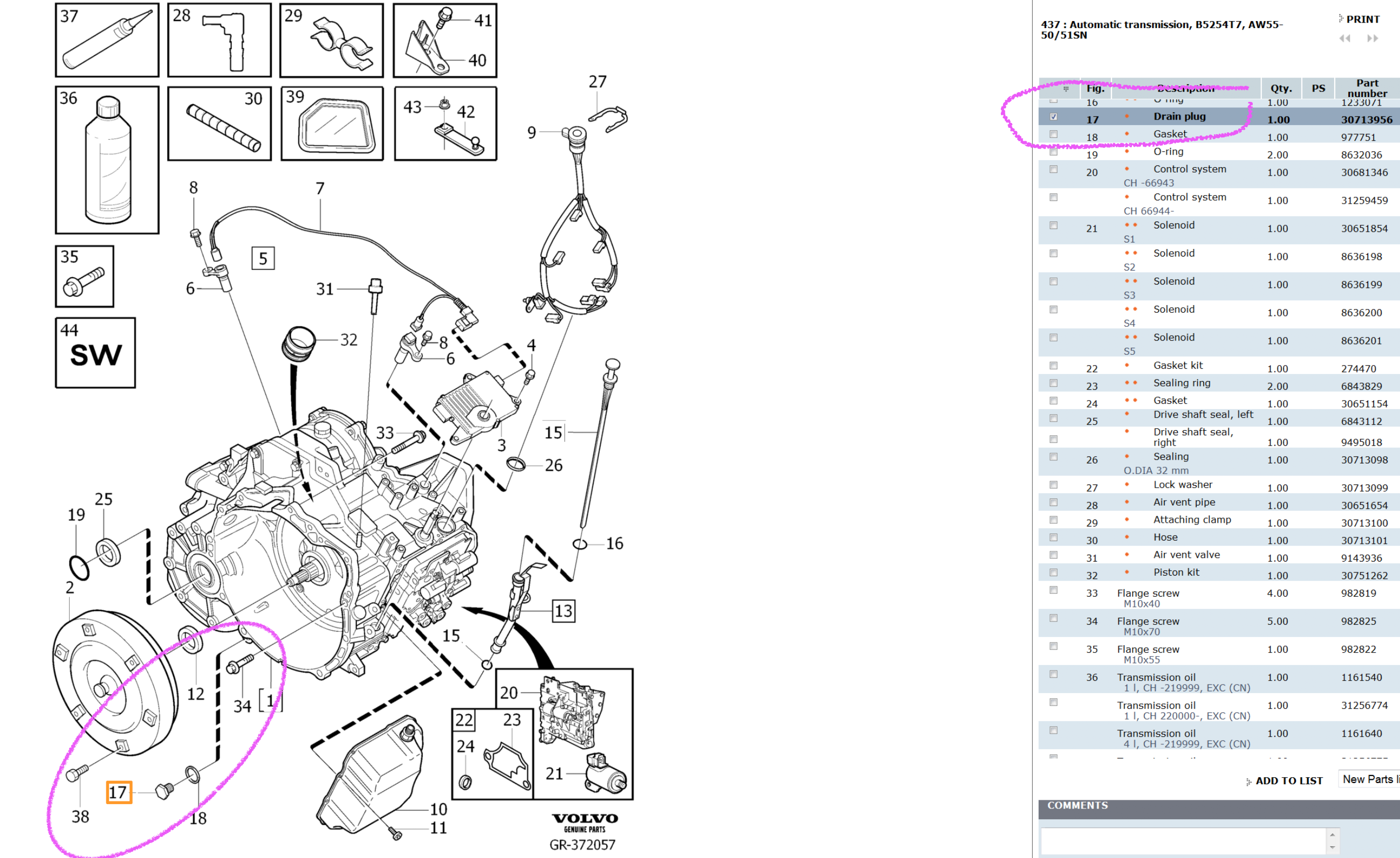

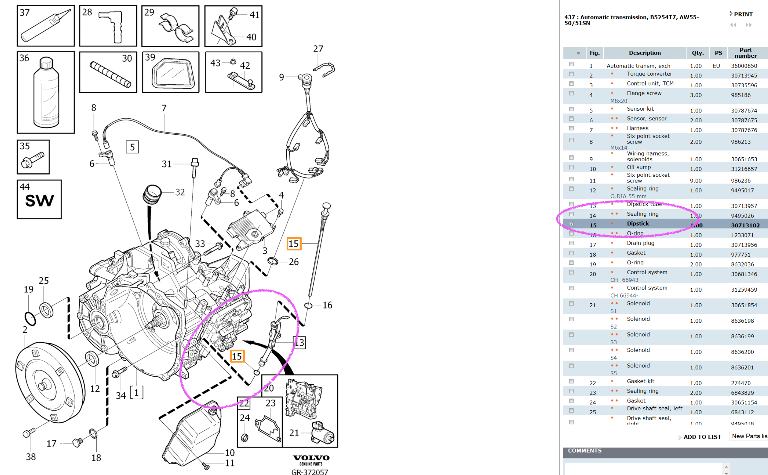

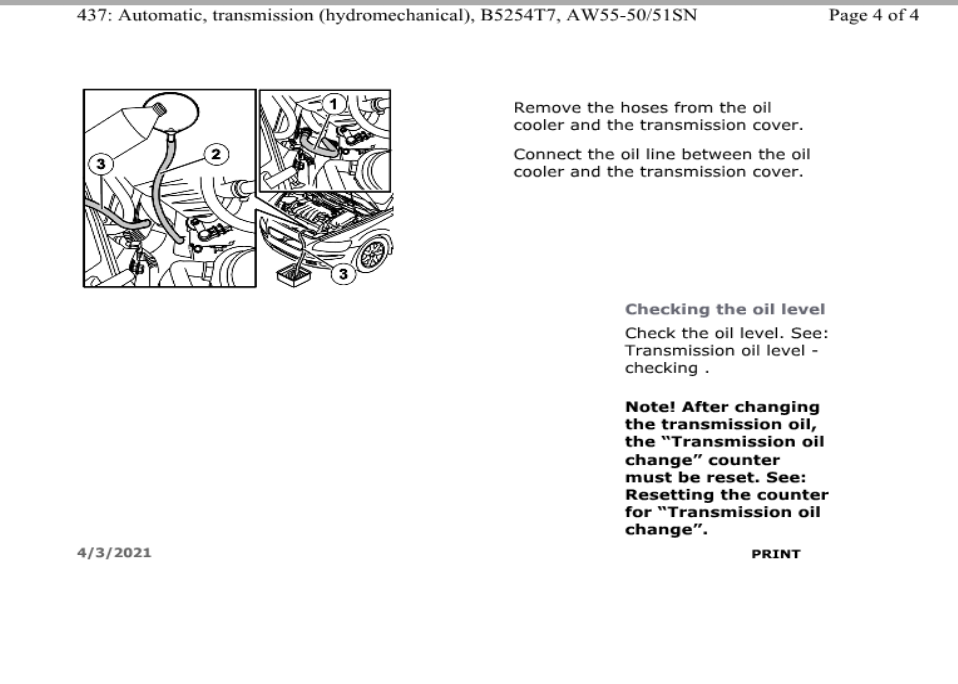

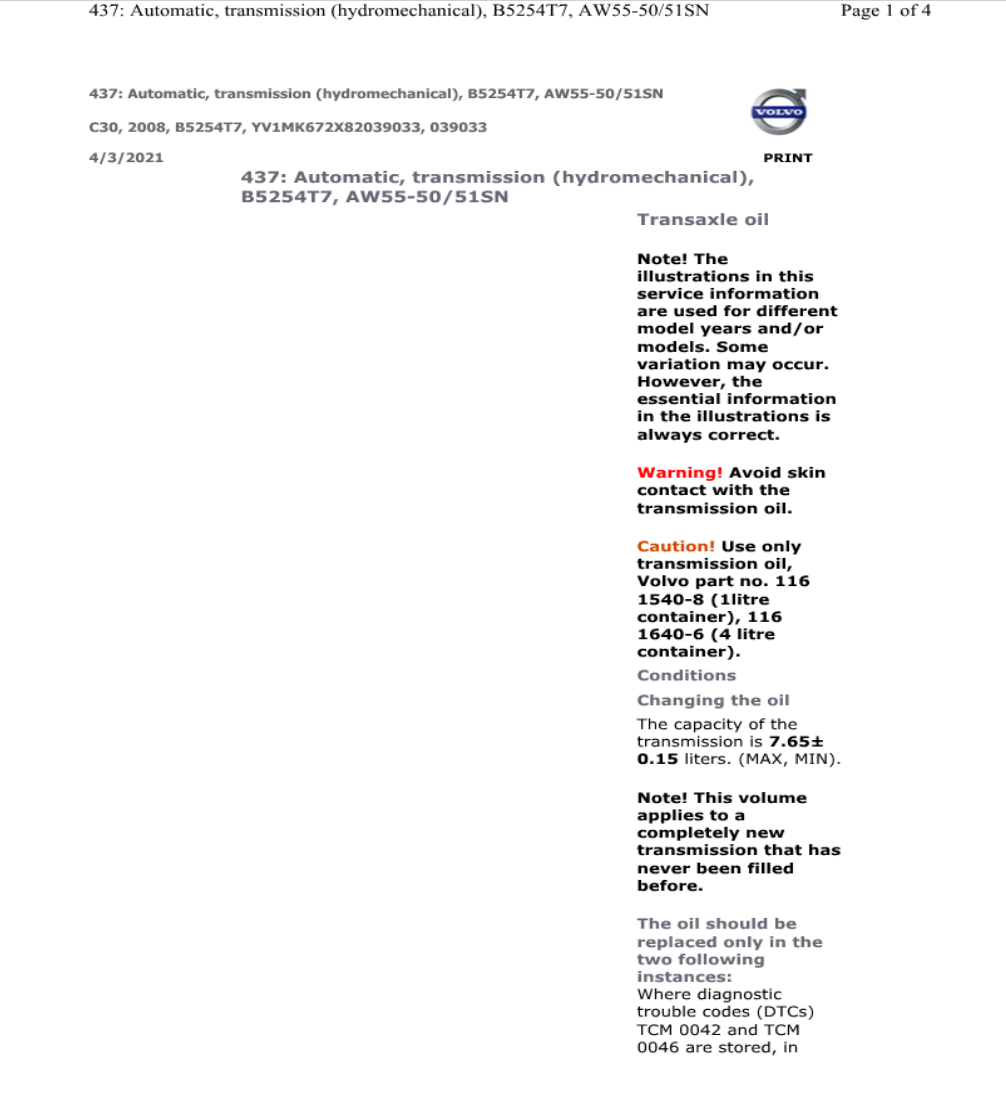

Ok,
Got a bit discouraged when a mechanic said my car wouldn’t have a dip stick and I would need a computer to monitor and control the fluid changes.
Well, as the Vida did show a dip stick. I poked in with a cable camera and found it. So planning to follow the VIDA steps.
Now to figure out how to get to it, sooo tight there, probably some reach point from under the car.
Update soon.

CAREFUL not to break that. The entire yellow handle just came off the metal stick as I check the trans fluid a couple of days ago. I have get pair of pliers to pull it out now.

Volvo Automatic Transmission Dipstick - Genuine Volvo 30713102
C30, S40, V50, C70
https://www.fcpeuro.com/products/volvo- ... 02#fitment
C30, S40, V50, C70
