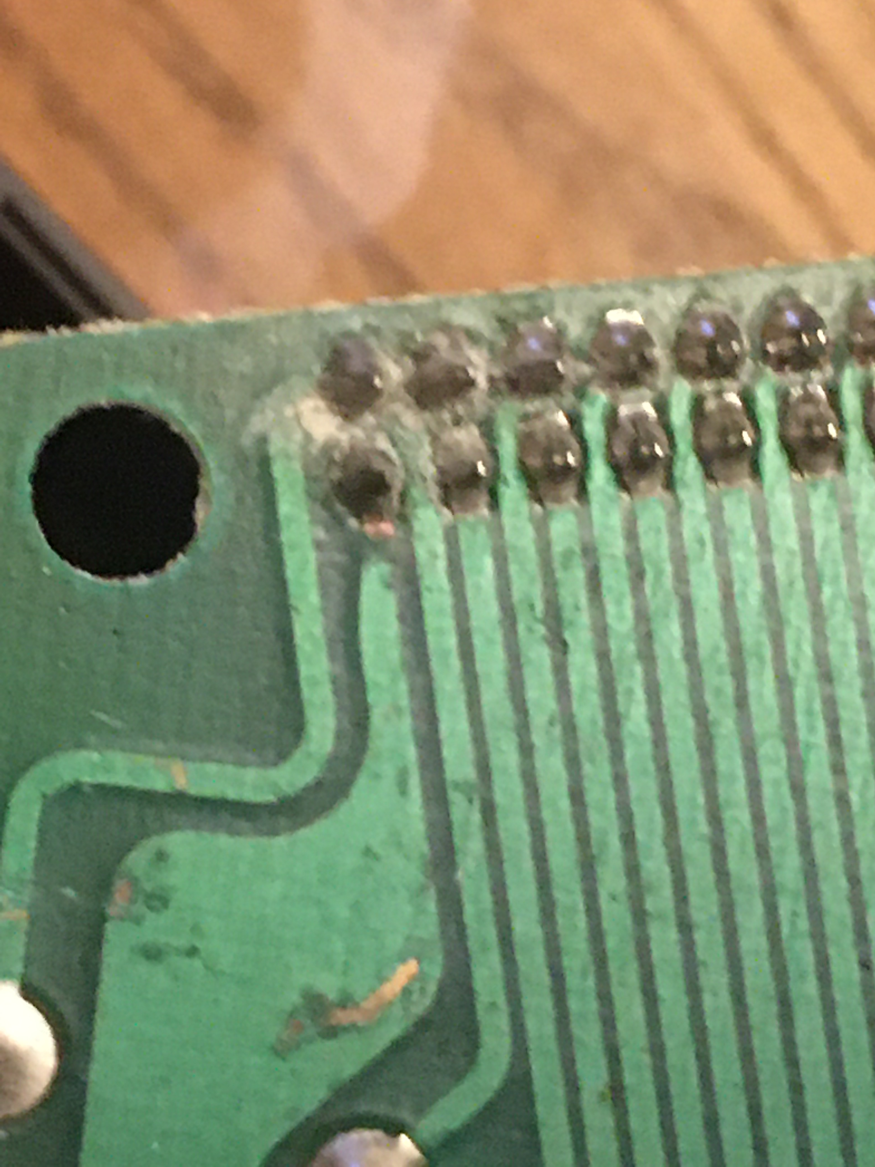

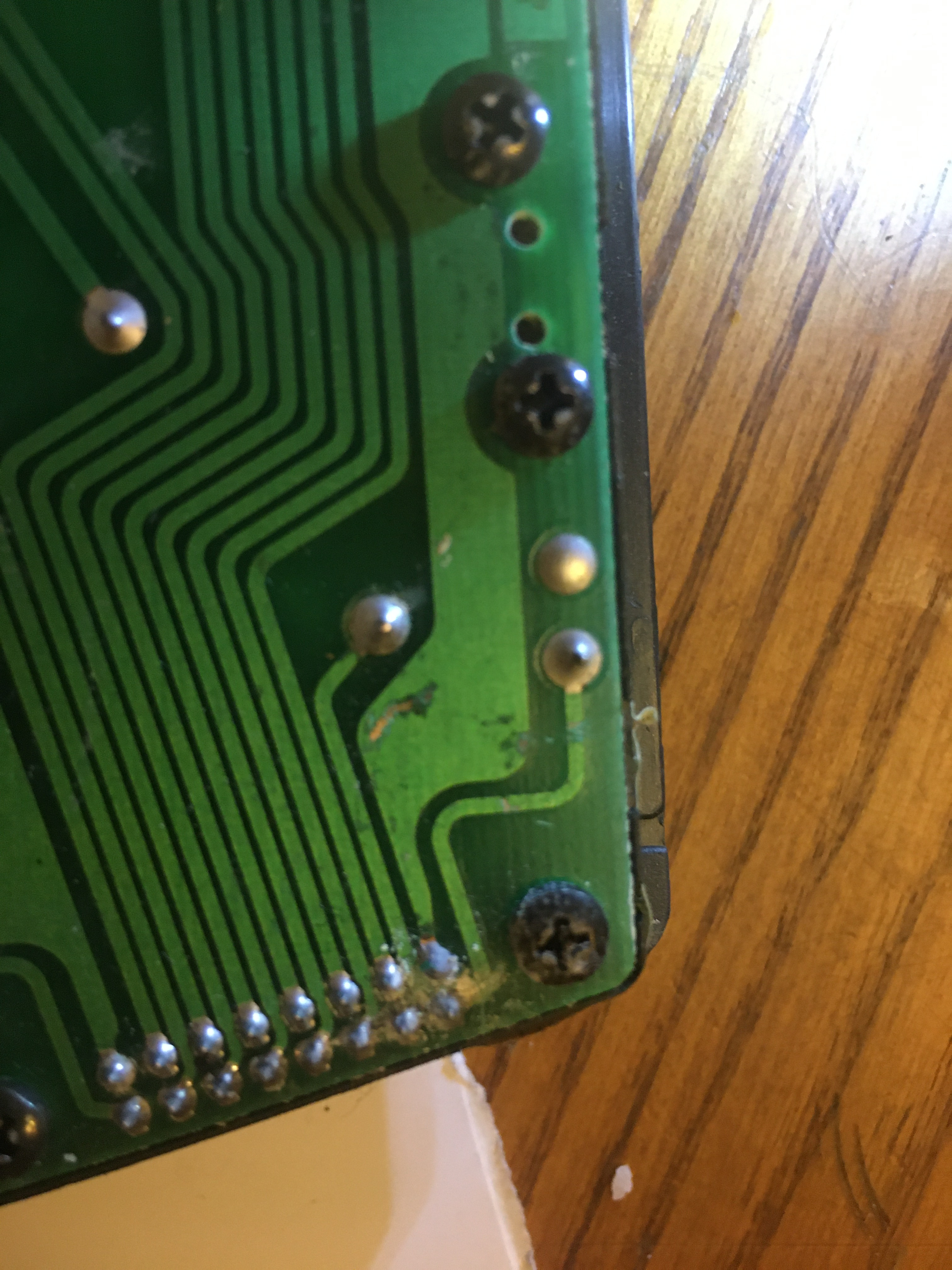

A single function not working points a bit to the motor, but I pulled the switch assembly first and probably found cause,

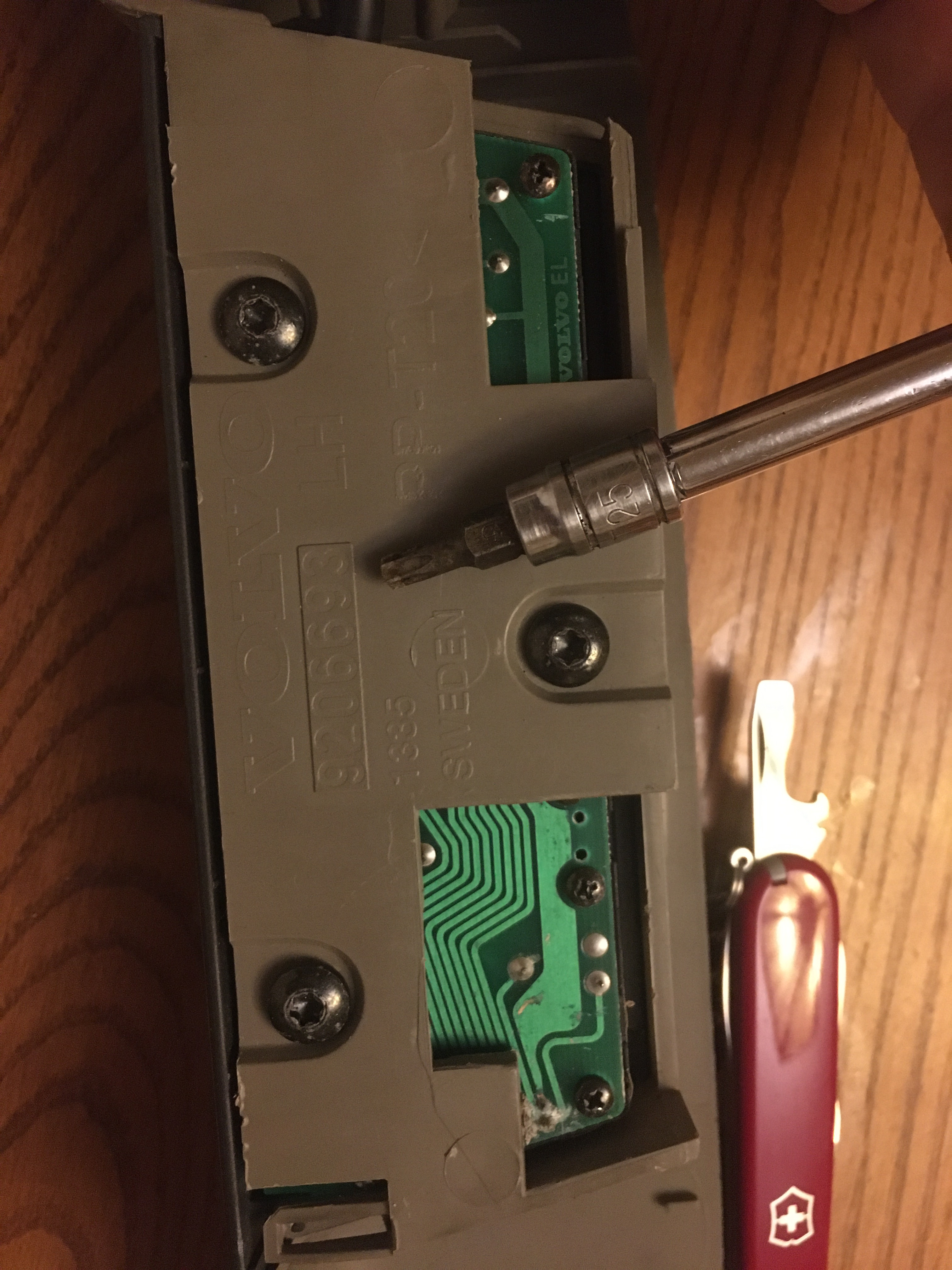

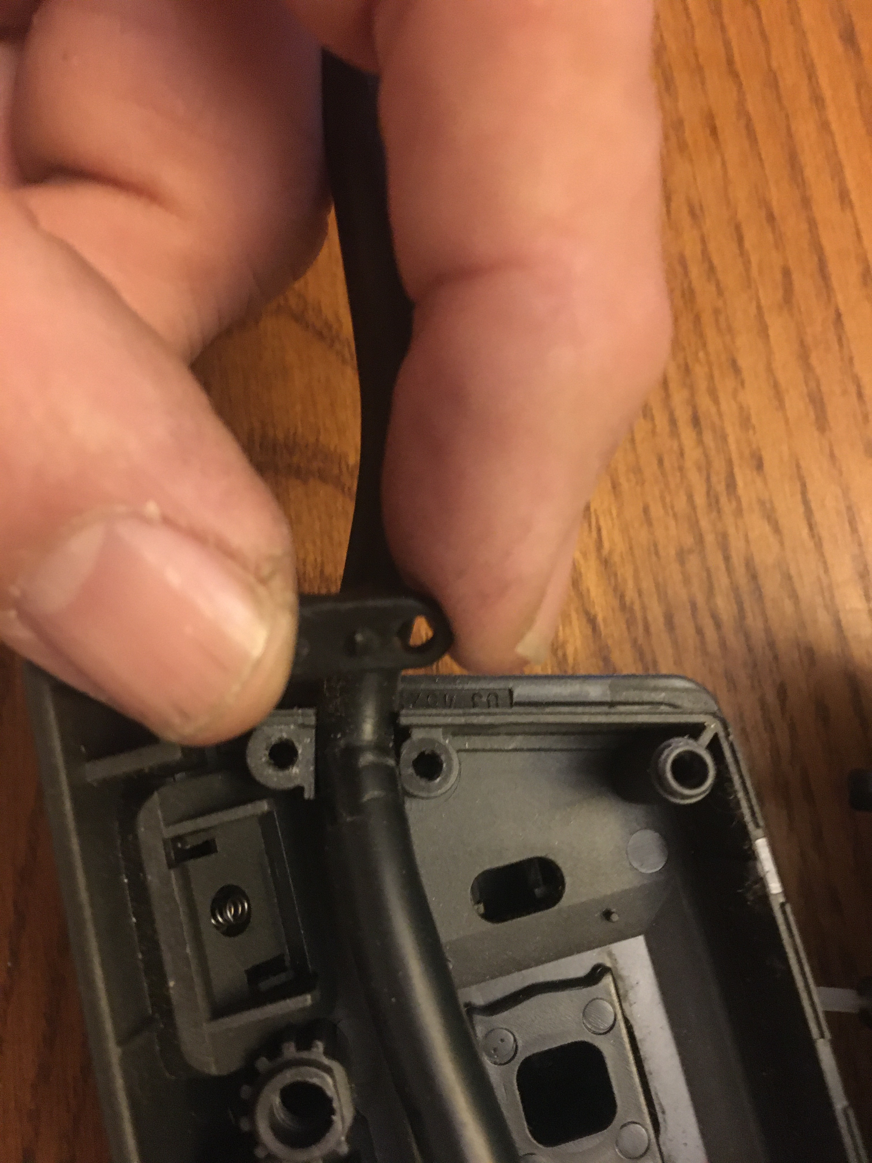

Seat switch unclips from seat without tools
Torx T25 allows switch to release from plastic
Philip is screws hold circuit board to switch body

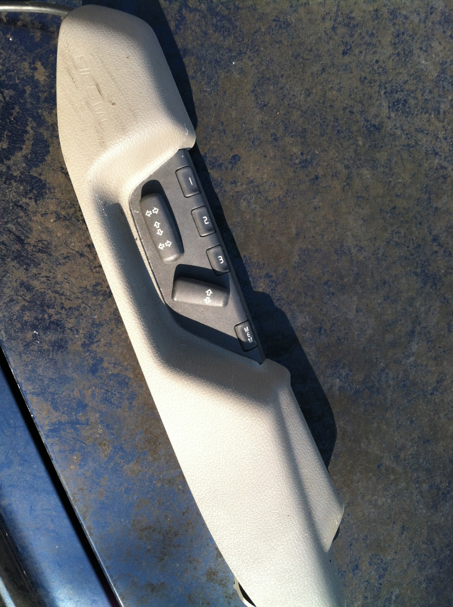

P80 power seat switch troubleshooting , driver side

So resoldering solved the problem?

What year is the car? I have a beige driver's seat switch assembly for I believe was a 98? I don't need it.
