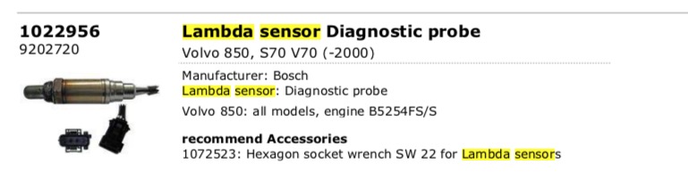

Since 2 days, I have a light on my speedometer, the famous "orange triangle": lambda sensor.
Here's my question : have a to replace the 2 sensors or only one ?

Thanks.xanthefin wrote: 10 Mar 2021, 00:16 Only broken one I would go as I like be cheap.
Lambda light is not automatically that it is lambda sensor. It's engine check light. Just to make sure here.

Does someone knows about which one i should watch over ?Fiodor wrote: 10 Mar 2021, 00:21 Have you tried to read the codes ?

As mentioned it may not be the lambda sensor. The light is as said a generic engine warning light so don't assume it is the lambda sensor. If one fails it is more common of the upstream one (the one closest to the engine).
