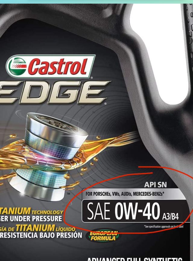

Thanks for the tips.
Ok, so the XC70 specs say A5/B5.
I see this one is good. But for my c30
It says A3/B4
But would a 0-40 be fine? Like does it have to be 5-30?
Say this one:
It says A3/B4
Say this one:

If I could clarify; what I'm trying to tell you is that at the end of the day it doesn't matter. Almost all motor oil today has already exceeded the required specs from the 2000's and the only thing you should be worrying about is the oil weight and the price. Now if you want 0w-40 then yes you can either get the Castrol or go with liquid moly from FCP - the engine is not going to care only your wallet.
If you want 5w-30 then you can literally get the cheapest one such as 'Super Tech' from Walmart or 'Amazon Basics' which is about the same price. I have been using Super Tech 5w-30 for over 2 years; the engine is fine.
Portland Oregon ain't ever gonna experience Scandinavian weather; your engine will never struggle with the super cold or heat so both 5w-30 and 0w-40 will be fine for the car, but the only issue is that 5w-30 is significantly cheaper.
XC70 is already gonna be a pricy car down the road especially since it's an AWD car with fancy suspension, so if I were you just get a bang for buck Super Tech oil. Also, the most important thing you should do in any car is to change the oil regularly, in the P2 Volvo's case every 7500k miles or every year - whichever comes first.

The Castrol 0W-40 is a very good oil. Only the 0W-30 is better in my opinion, but it's not sold in 5l jugs. These are the best oils in North America, unless you want to spend on oils such as Amsoil or Redline
