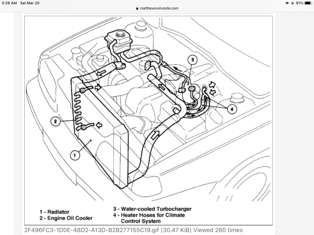

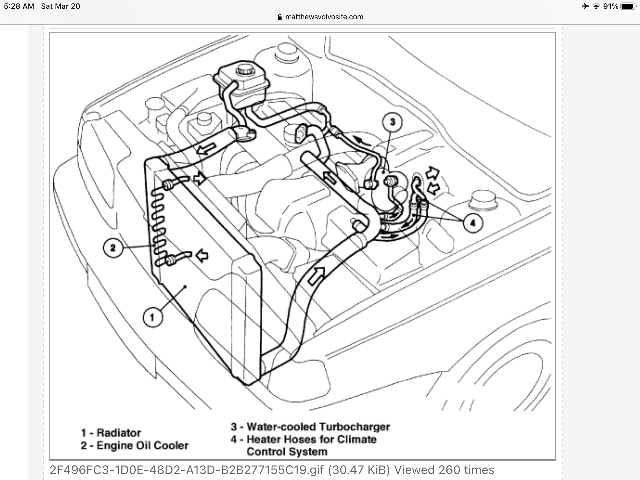

You have quick connection the heater hose , too, first grab the necks up at the firewall and give them a nice twist until the brass is rotating in the oring, maybe a 1/8 turn or so.
Now you can squeeze the yellow clips with needle nose and gently work the copper part out. Nice and slow here so you don’t break the plastic bulkhead connector. Pull straight and rotate a bit back and forth, and it will come out slowly and ( don’t call me ) Surely.
Some 5/8 Tygon clear tubing will let you evaluate flow without spilling , or you can use heater hose to a container
Here’s you flow diagram fir the Chem Engineer 101; you could have a plugged radiator and / or plugged heater core.

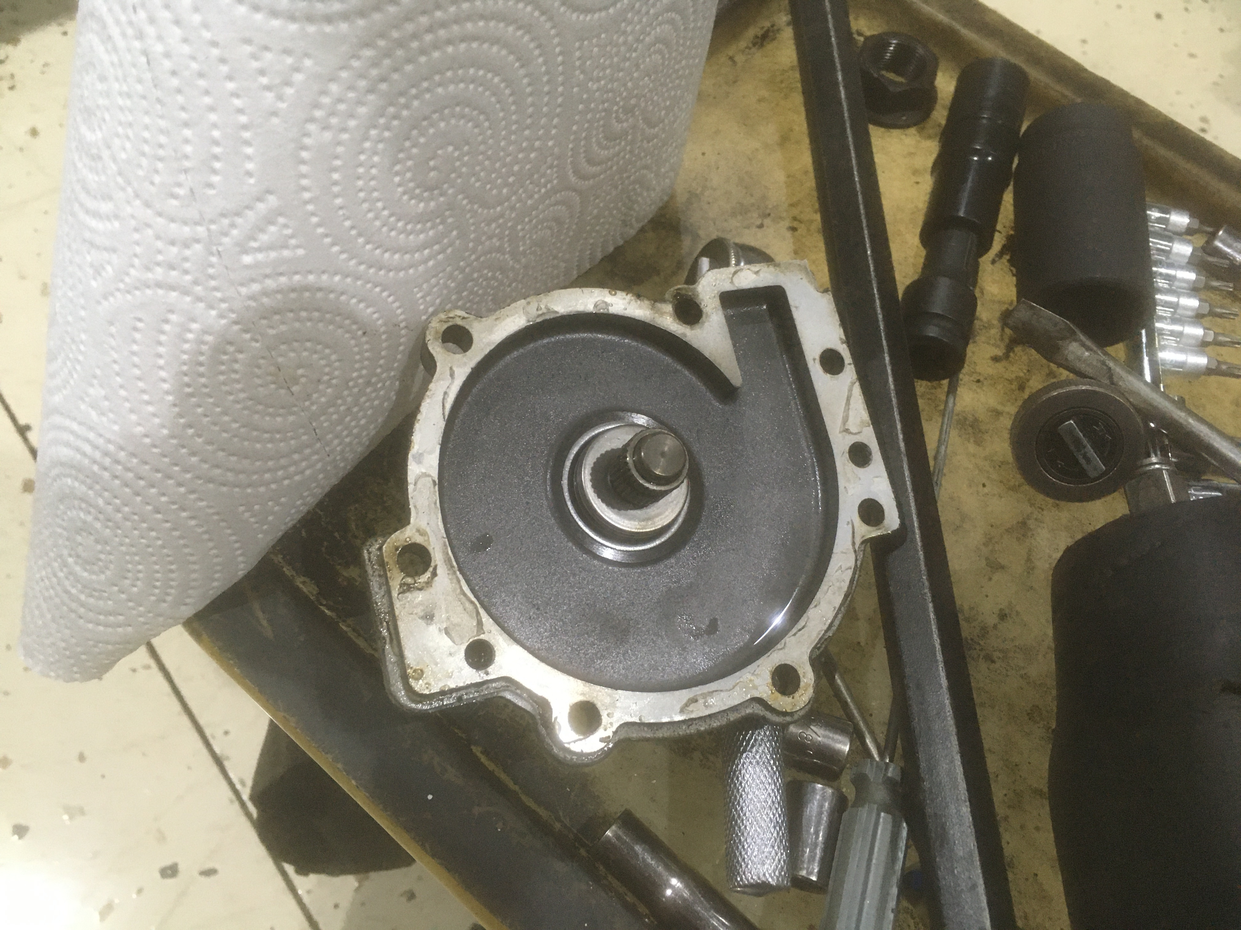

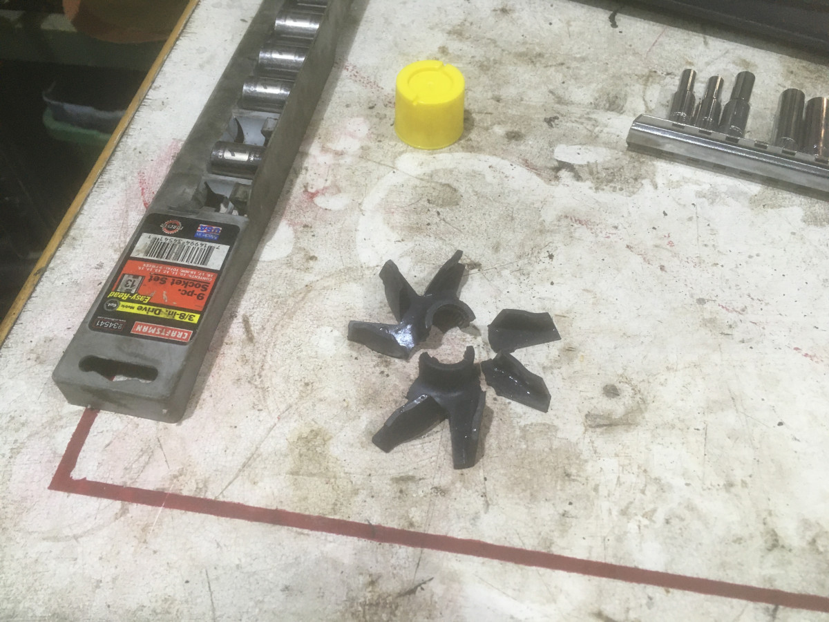

As Adam Savage would say : "There's your problem right there!"
Yep, water pump.
Thanks for all the support
Yep, water pump.

Is that an Aisin pump? Post some pics of the other side and its markings. Is the impeller plastic or metal?
