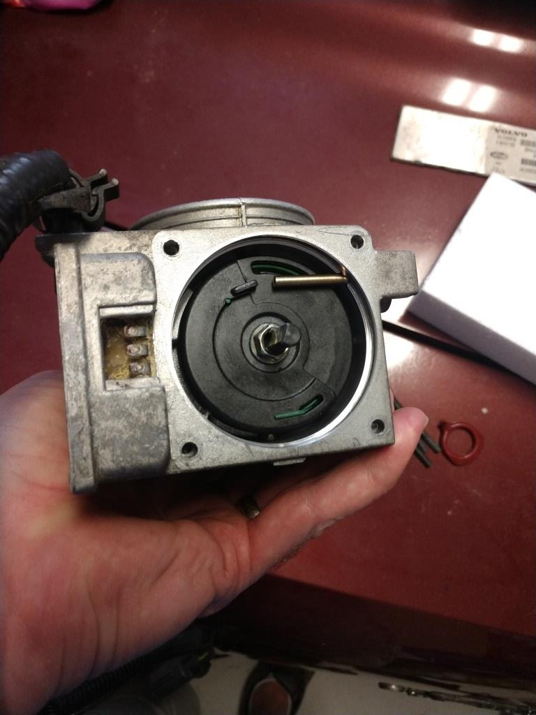

My 01 S60 2.4T went into full limp mode with ETM code. Not too many miles ago I cleaned it, so I figured the sensor has finally crapped out. New contact less sensor arrived today so I took out ETM and began installation. But I noticed the spring cannot easily return the throttle plate. Seems when I took this thing out in the past the throttle plate was easily moved and sprung back into place. Does anyone know what might be causing excess friction. I attached some pics
ETM throttle plate difficult to move

It should not do that. Of course. You would not want to have the car stuck with a wide open throttle - it's not a Toyota or an Audi (unintended acceleration reference).
You may just need a new ETM, not just the sensor part. Or there may be some cleaning or lubrication that fixes your issue. I don't know. I would rely on expert advice here to avoid damaging your ETM.
Perhaps give Xemodex a call in Canada. They may give you an idea although they sell repairs for ETMs. https://xemodex.com/us/product/electron ... r-service/

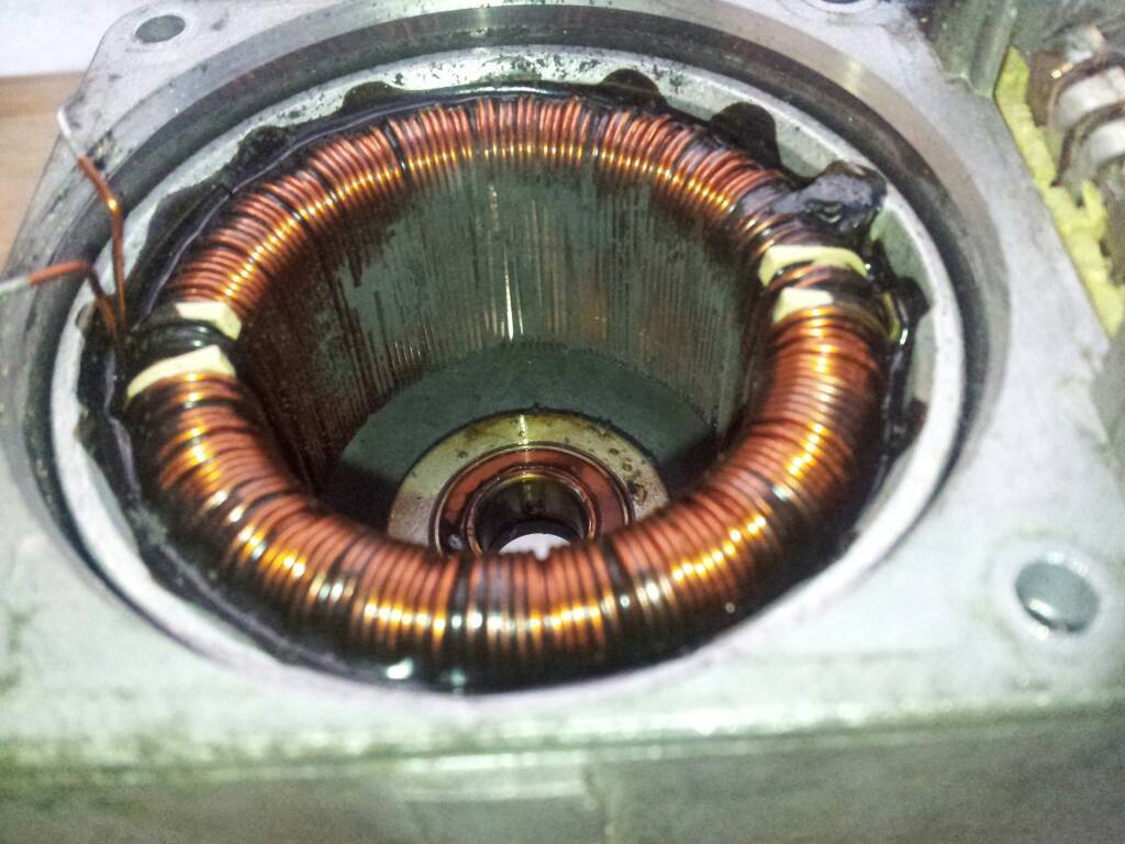

Based on the year of your car, 2001, you have the Magneti Marelli ETM and years ago I saved some photos of a problem not associated with the well-known position sensor problems. This problem was the cover of the armature rubbing on the windings, see photos. I don't know if the cover swelled up and deformed or the throttle plate shaft bearings went bad, but you can see the contact and this would certainly cause the throttle to stick. Not sure how often this happens and there could other reasons for the throttle to be sticking but thought this might be helpful. I also recall reading that Xemodex replaces the throttle shaft bearings with stainless steel ones when they rebuild these ETM's so they must see some problems with the original bearings.thorv70t5 wrote: 21 Oct 2022, 08:42 What was the verdict on your problem with the throttle plat being sticky?. Having same problem with mine.
