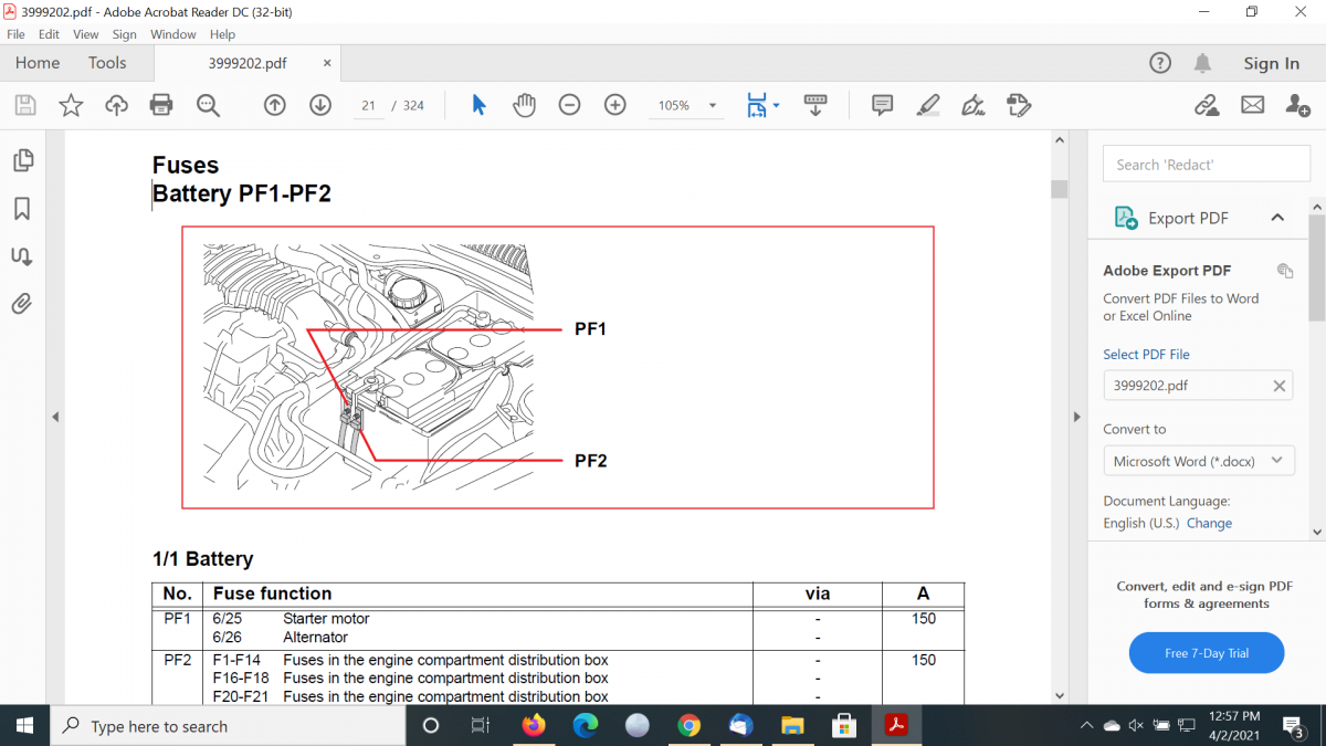

See attached file. Start at the battery and work your way down branch by branch.
Be sure to check PF1 & PF2. It could be leakage through the starter or alternator.
S40 Electrical Dist.pdf- (413.61 KiB) Downloaded 240 times

If it is on PF1, most likely one of the diodes in the Alternator's bridge rectifier has a fused PN junction. Which would explain your battery health problem also.
