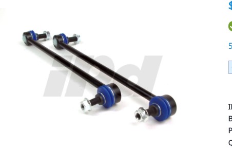

got these HD end links from IPD,
https://www.ipdusa.com/products/11189/F ... IPD-124646
Do i need to apply any 'Loctite' on the locking not on these end links? seems it should be extra carefully tight, no?
Whats the torque to close these?
video just shows him tightening...
New Sway Bar Links Install Question 2004 XC70

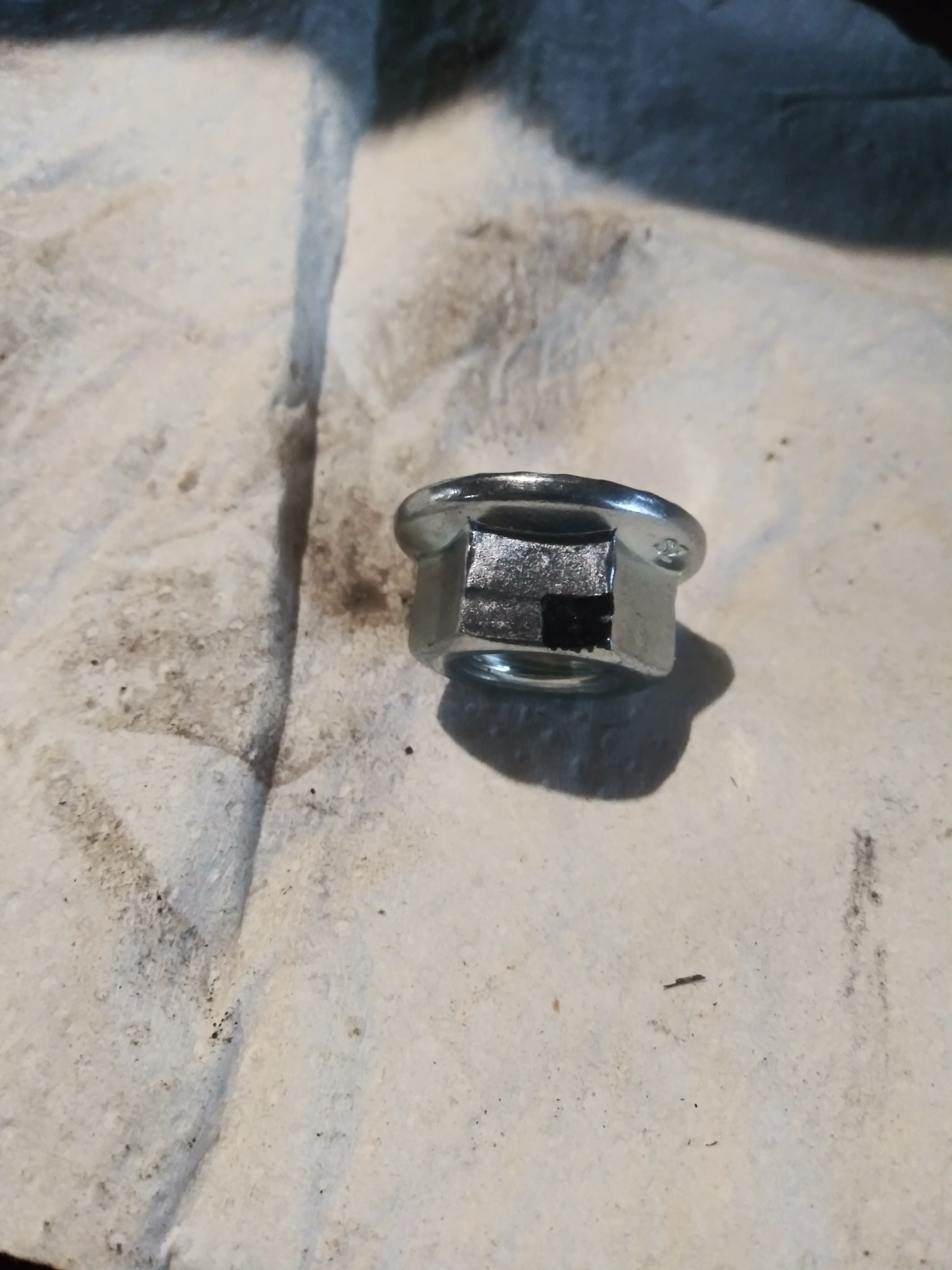

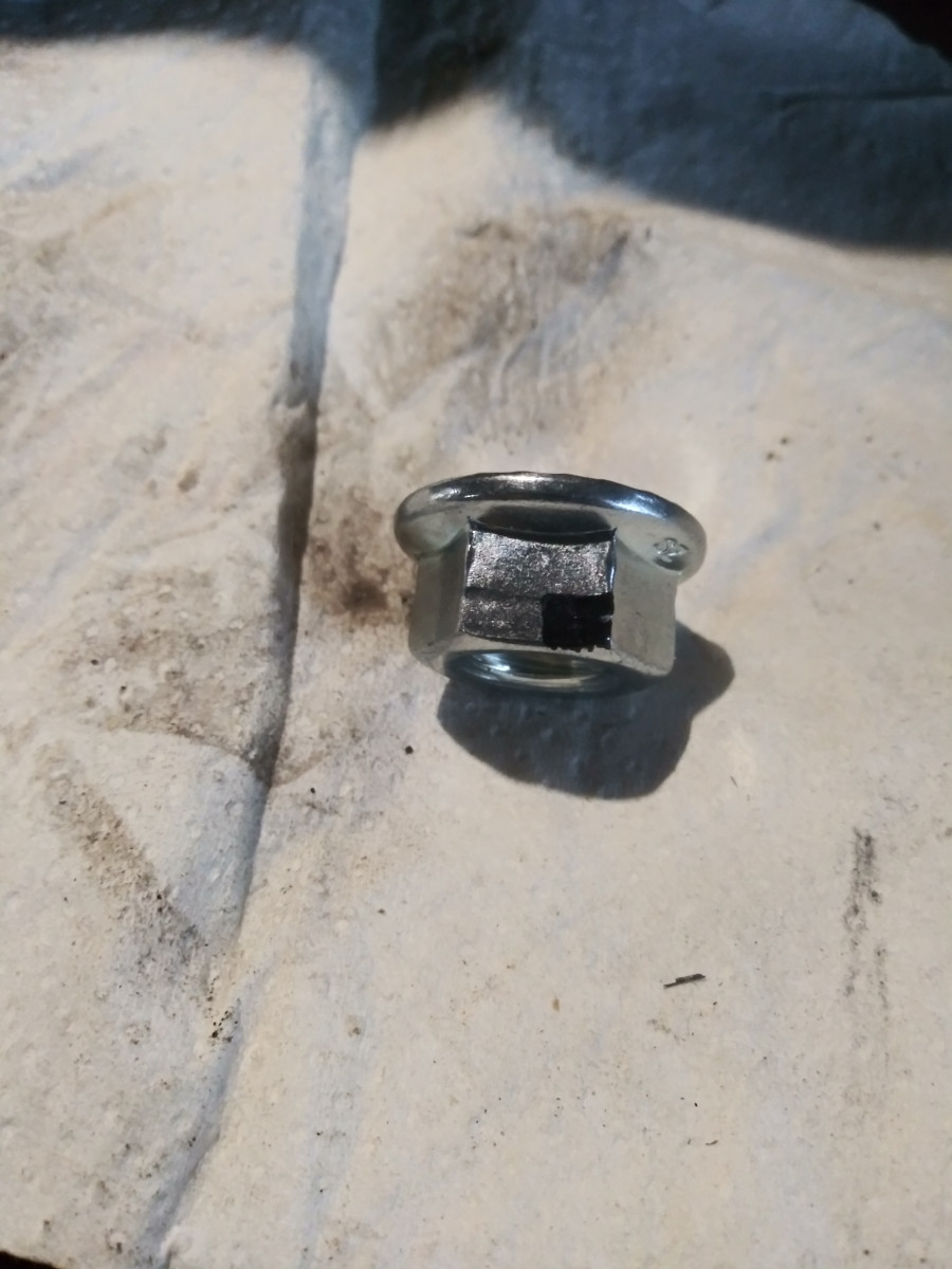

volvo swaged the nut, they crimped it so its out of round and binds on the thread.
The thread is very course but will not loosen by vibration.
Crimp mark on the nut is visible. I marked it with a black marker pen.
