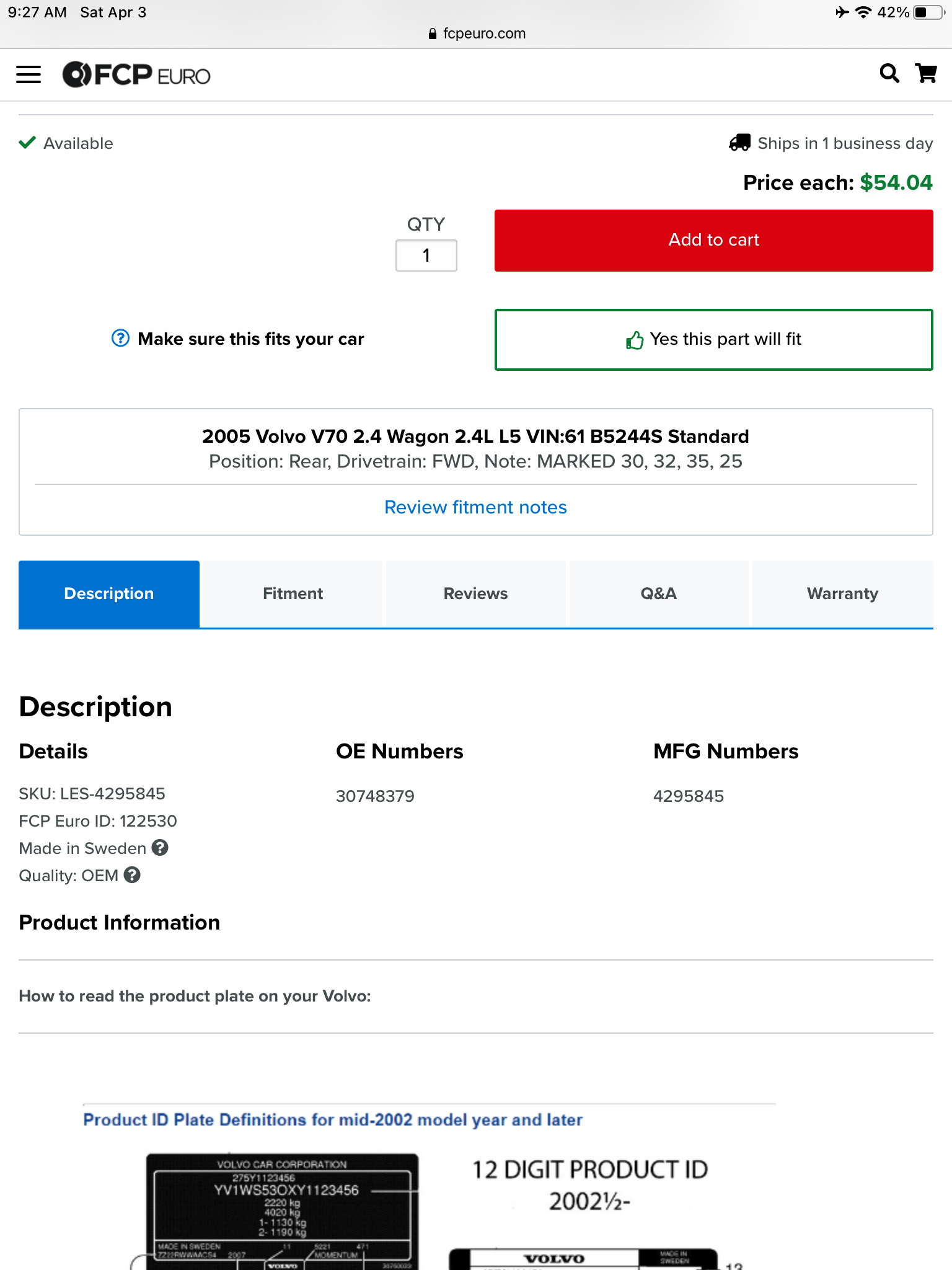

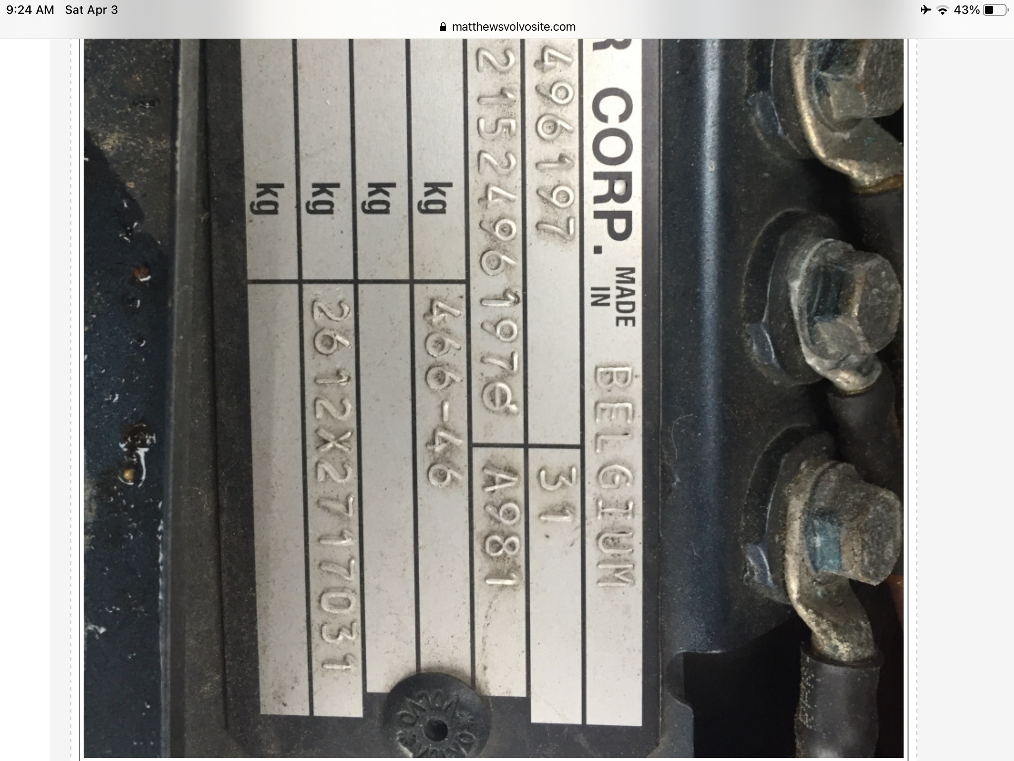

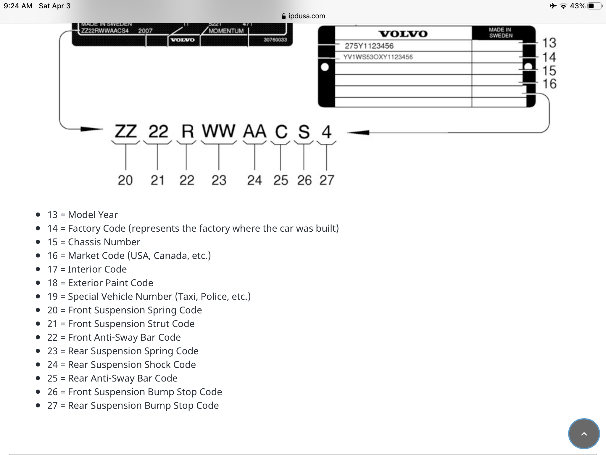

Would like some HD springs for my P2 but not finding fitment for the 27 spring code on mine ?
Hmmmm
2005 v70 NAM56 rear spring code 27 (error in VIDA and FCP APril 2021)

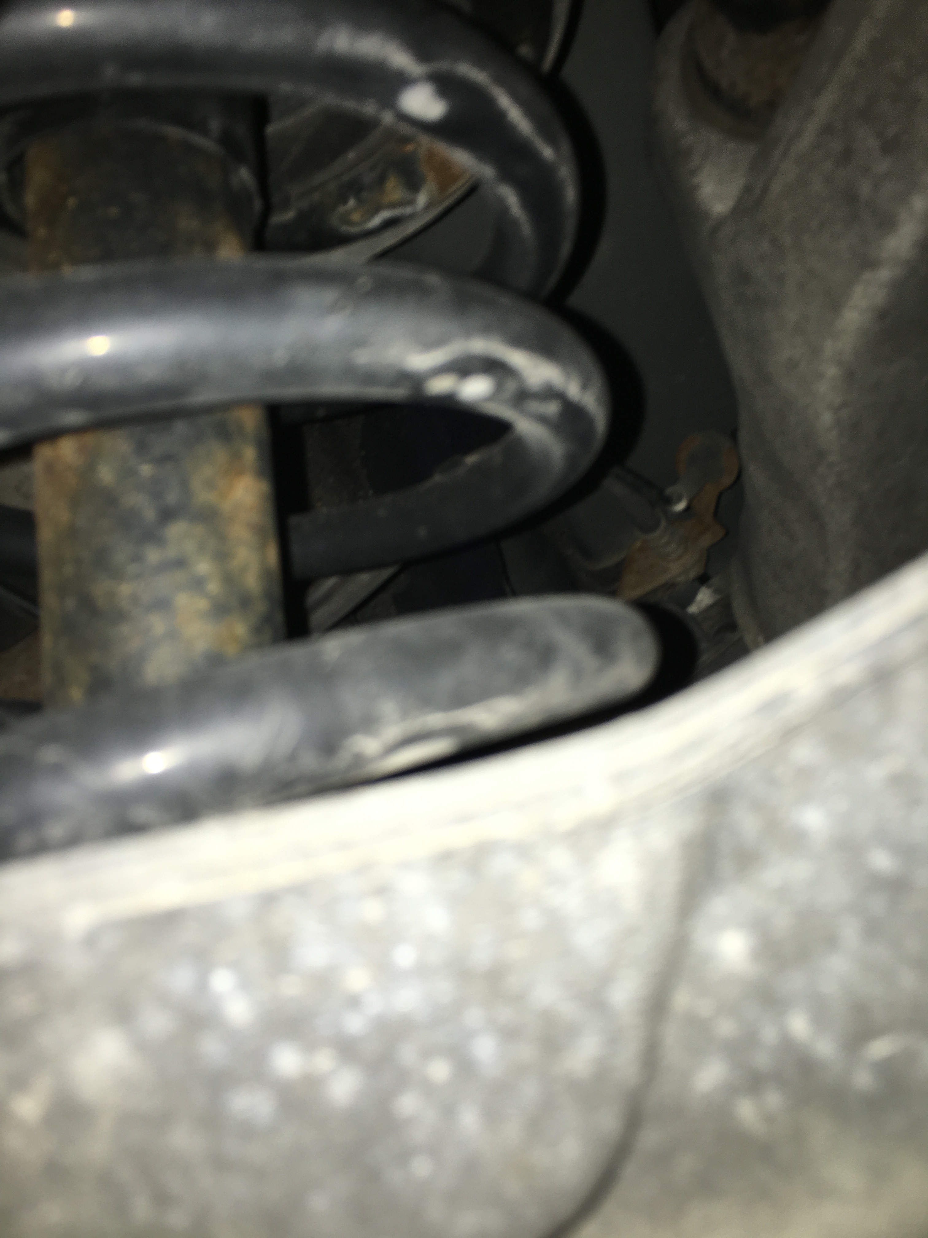

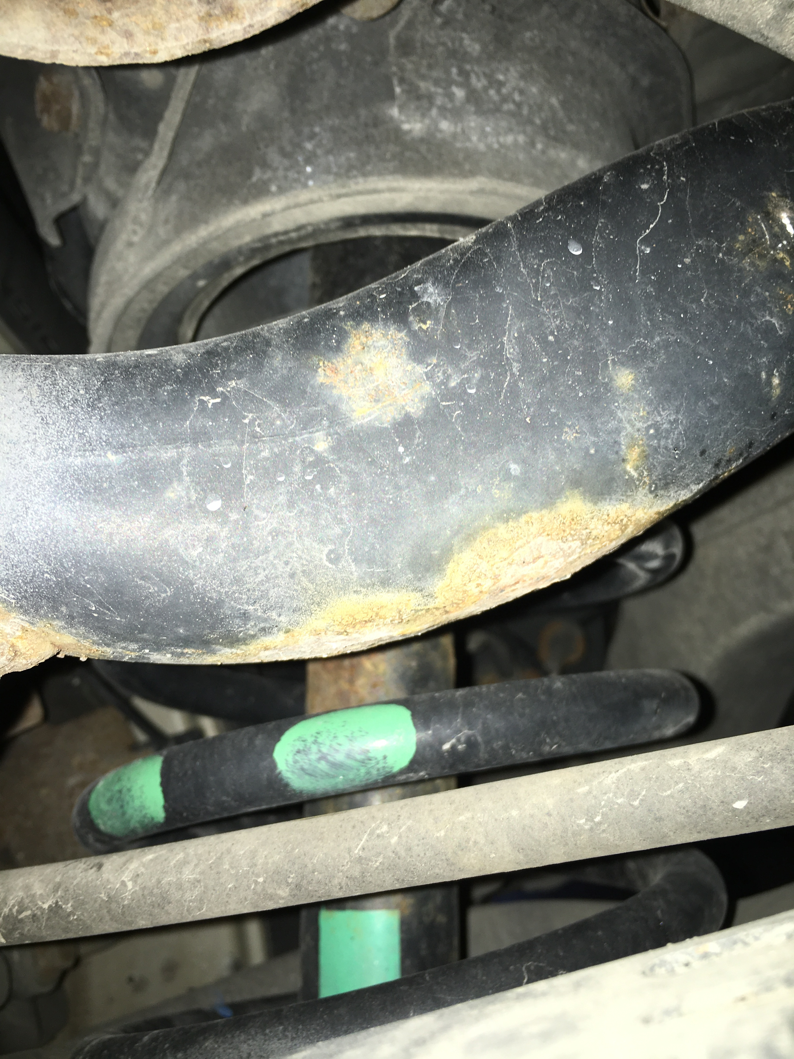

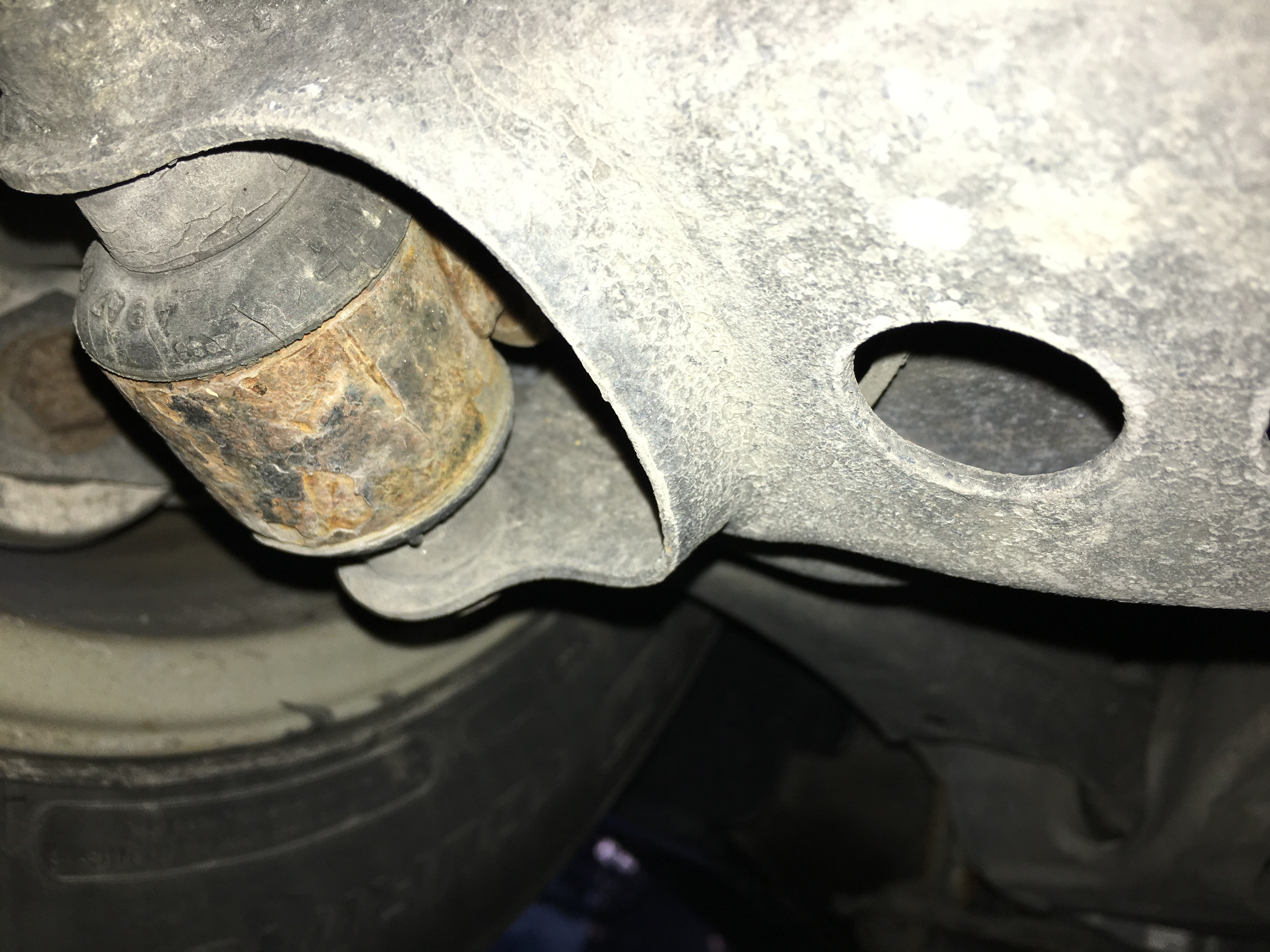

Pictures of my shocks and springs...I think these are just standards, although Volvo web store says code 27 is 4C

Skandix report
1013774 Suspension spring Rear axle
Volvo V70 P26: all models, Spring code 29
Volvo V70 P26: all models, Spring code 31
Volvo V70 P26: all models, Spring code 34
Volvo V70 P26: all models, Spring code 76
Volvo V70 P26: all models, Spring code 78
Volvo V70 P26: all models, Spring code D3
Volvo V70 P26: all models, Spring code D4
Volvo V70 P26: all models, Spring code 27
Volvo V70 P26: all models, Spring code E5
Volvo V70 P26: all models, Spring code 8F
Drive type: without AWD
VIN plate: Product plate
Type plate Code position: Line 5, right column
Type plate Position in line: 6+7
Type plate meaning: Spring code

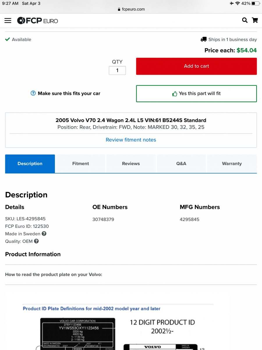

FCP reports incorrectly that spring code 27 is for 4C - apparently VIDA does the same error
