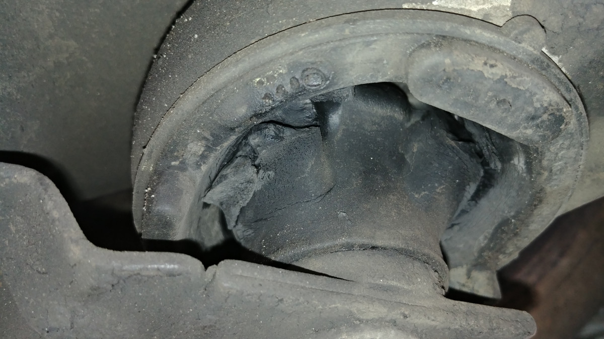

I'm guessing lower control arm inner bushing. My 1988 760 turbo wagon has a similar issue when turning into rough driveways. Upon inspection the lower control arm inner bushing appear worn.

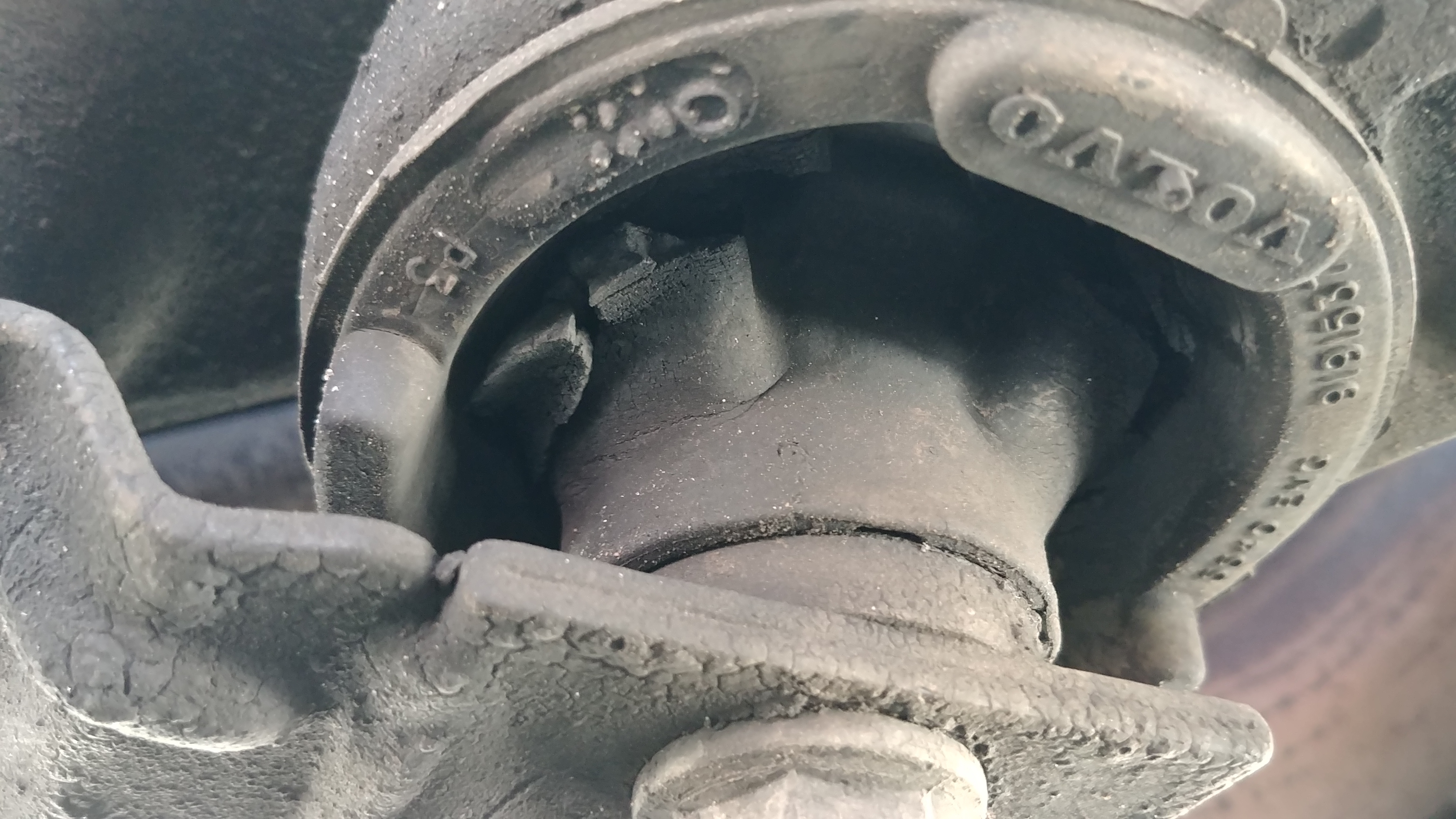

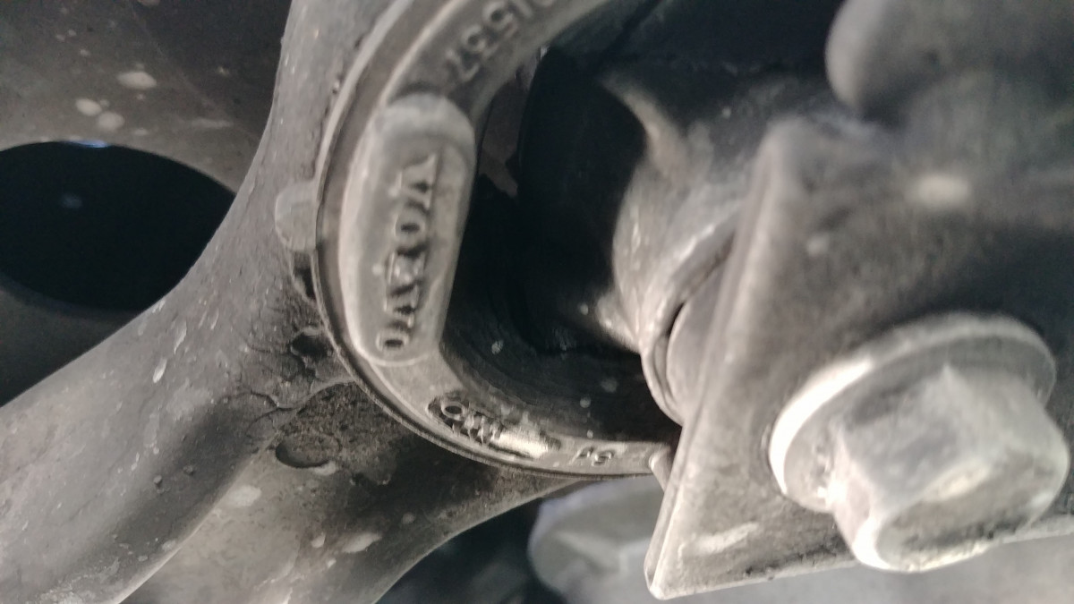

Here are some close-ups on the lower control arm bushings on the driver and passenger side. Yup, they are cracking but the rubber is still there. Perhaps they are cracked up enough to allow for contact sometimes.
driver side (should have used flash)
passenger side
passenger side
passenger side taken with flash
