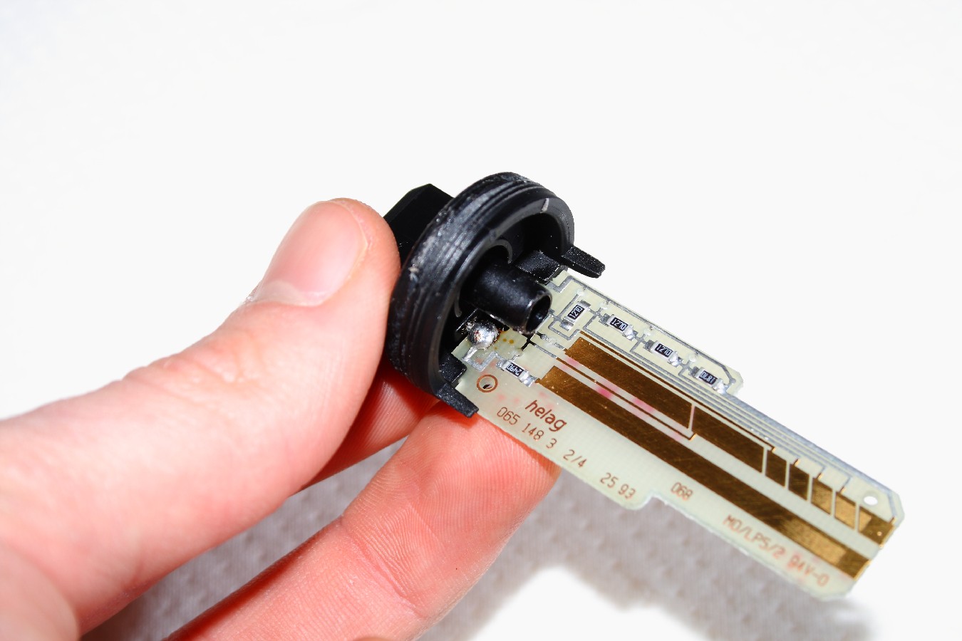

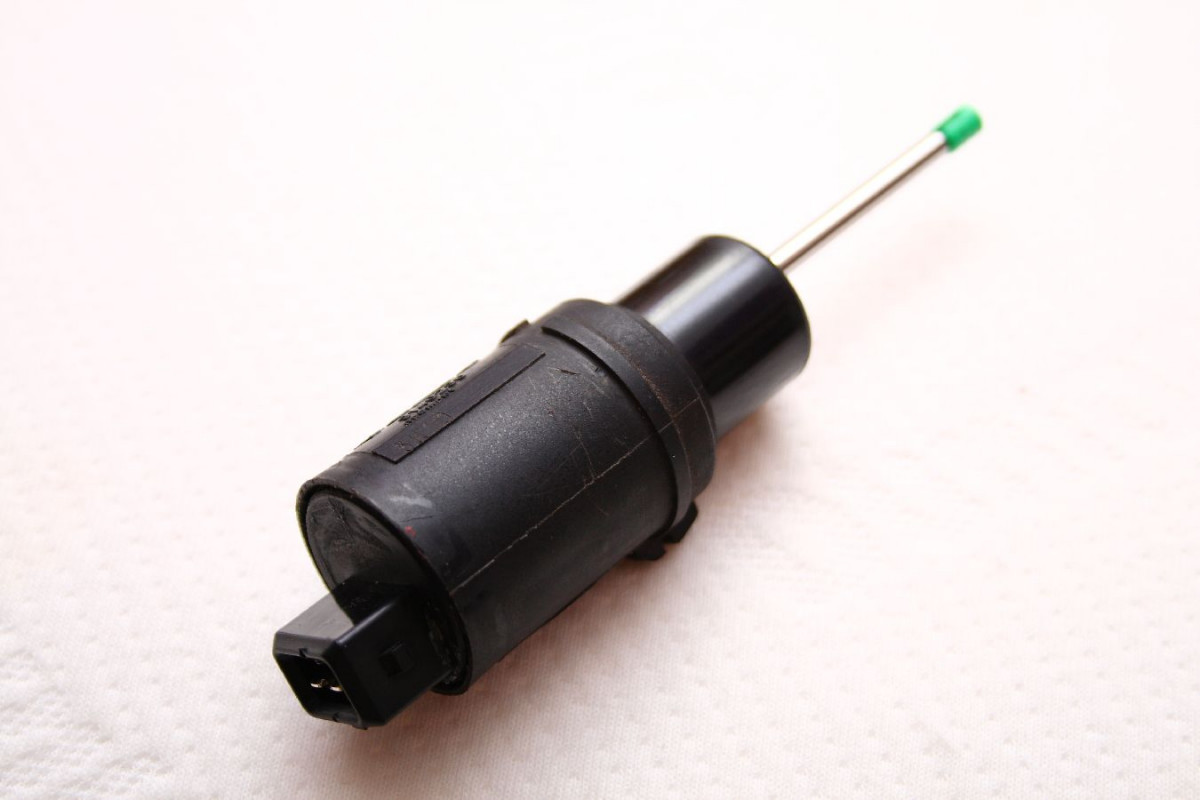

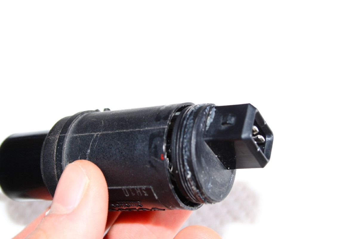

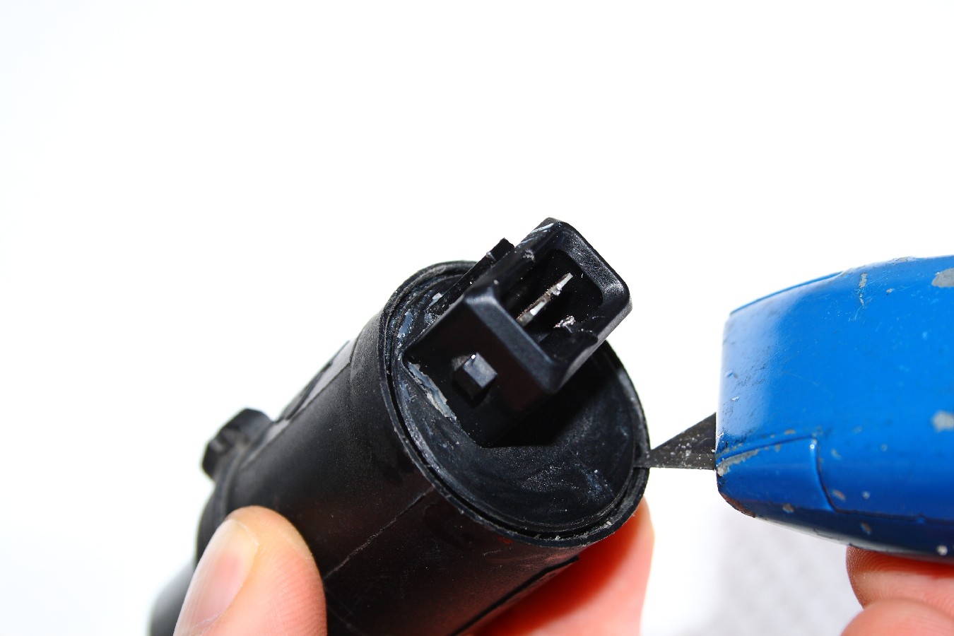

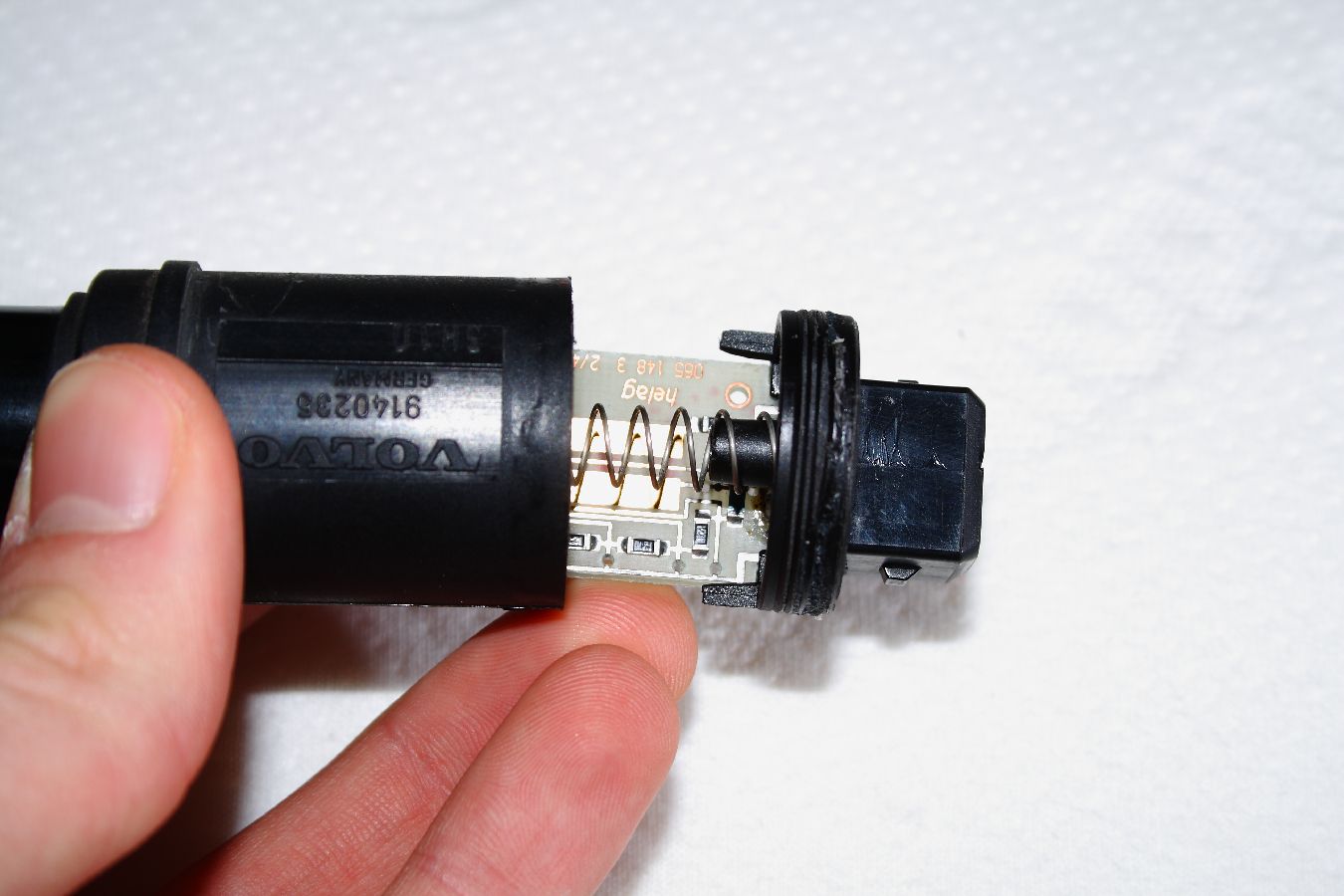

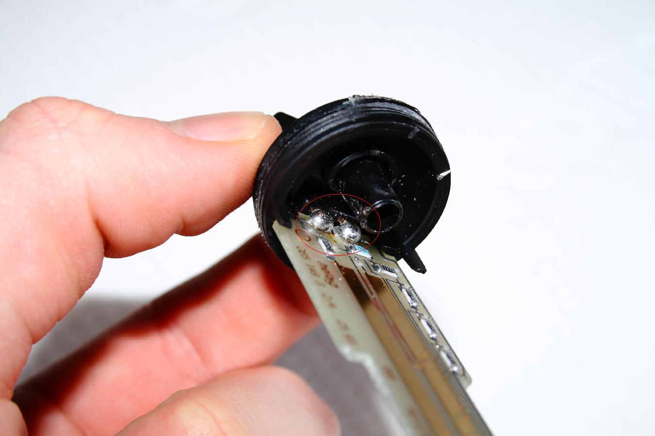

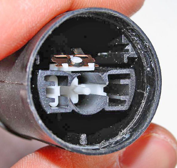

My cruise control stopped working and it was the brake pedal position sensor. This sensor is next to the master cylinder and held in the brake booster with a round clip. It's a sliding type contact with a rod in the brake booster and two fingers internally that contact and slide across strips connected to resistors on a small circuit board. In my case there was a solder joint that broke internally. These switches can be opened up and repaired but it might be safer to just replace the switch if that's what's causing the problem. These simple sensors are not cheap so a salvage yard may be your friend.fontoledo wrote: 05 Apr 2021, 21:40 Hi all
The cruise control in my 2006 XC70 has not worked since I bought it, but now that I'm putting together a few summer trips, I'd like to get it fixed. Controls on the steering wheel do seem to be properly connected and "semi-working": while pressing the Cruise button, the Cruise notification appears on the control panel. However, when attempting to set a speed, nothing happens: as soon as I release the gas pedal, the speed drops. I've tried several combinations with both the +/- speed buttons and the ones on top of it, but nothing works.
Any clues on where to start looking? Is it worth disassembling the steering wheel to check cable connections? Could it be mechanical?
Thanks in advance!
My symptoms were different though, I did have a code and I wasn't able to turn on cruise control with the cruise button. I can't recall the code number but it had to do with the brake position sensor and I read the code with a BSR PPC diag reader. I attached some photos from a person that repaired this switch, couldn't find the original link though.
I don't know if this brake position sensor is what's causing your cruise control problem but did want to mention this is a part that could potentially cause the problem.
