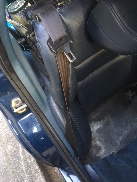

Hy Neil,
Here is the picture. You can see how far i'm able to bring back the back seat to its normal position.
Manov
Manov

Hi Manov,
That is weird. Never see or hear of that before. What is that behind the seat? Is that something broken off?
Have you tried removing the front seat belt mount to allow the seat to return to normal position and then see if the seatbelt will then feed out to allow you to re-attach it?

Hello Neil,
When i unscrewed the old 1/3, the bolt of the seat belt was free, the belt came into the back seat and was blocked. Impossible toi get it out. I suppose this car may have been laid near the north see (this car comes from netherland) and the stuff in the back seat may have been touch by the wet...
Manov
Manov

Been there, had fun
Not sure if you did that, but as you said, you need to remove the belt anchor bolt and then when the seat is upright try to ge the belt out again. The problem for me was that the small plastic rivet-stops that are in the belt got lost which allowed it to retract too much. when you replace them (with something, if not the original rivets) it should be ok again.
If you let the belt go all in, then I do not know how you would get it out again... might need to replace it.

I had that happen too. The seat belts are designed to lock in a rollover, which the seatbelts think is happening when folded, you need to unbolt the lower mount, hold the seatbelt out so it doesn't retract, put seats in normal position, then retract belt a bit, then try to pull out. You need the seatbelt mechanism in normal position, then retract the belt to unlock the lock. Then bolt back in.
