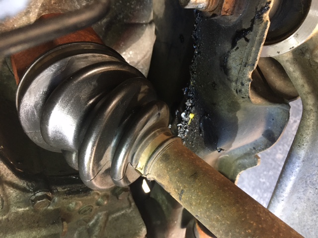

Had the opportunity to tackle the left front wheel bearing today and before I got too far I noticed flung grease from the driver's side inner CV :)
Took me some time, but finally found a tiny 3/16" long hole in the boot that's been squirting the grease around.
Is it possible that the inner CV could be causing all the noise? Just looking at the original owner's records it seems the right wheel hub and right CV axle were changed 40k ago, but never the left hub or CV axle.
I suppose it's time! (2006 V70 - 165k)

Can't tell but I would doubt. That doesn't appear to be much grease spilled. As others said, if you look at the bearing, be sure to test by hand before removing the securing bolts. The bearing will be completely stuck inside the wheel hub, a slide hammer is almost surely needed to remove it
