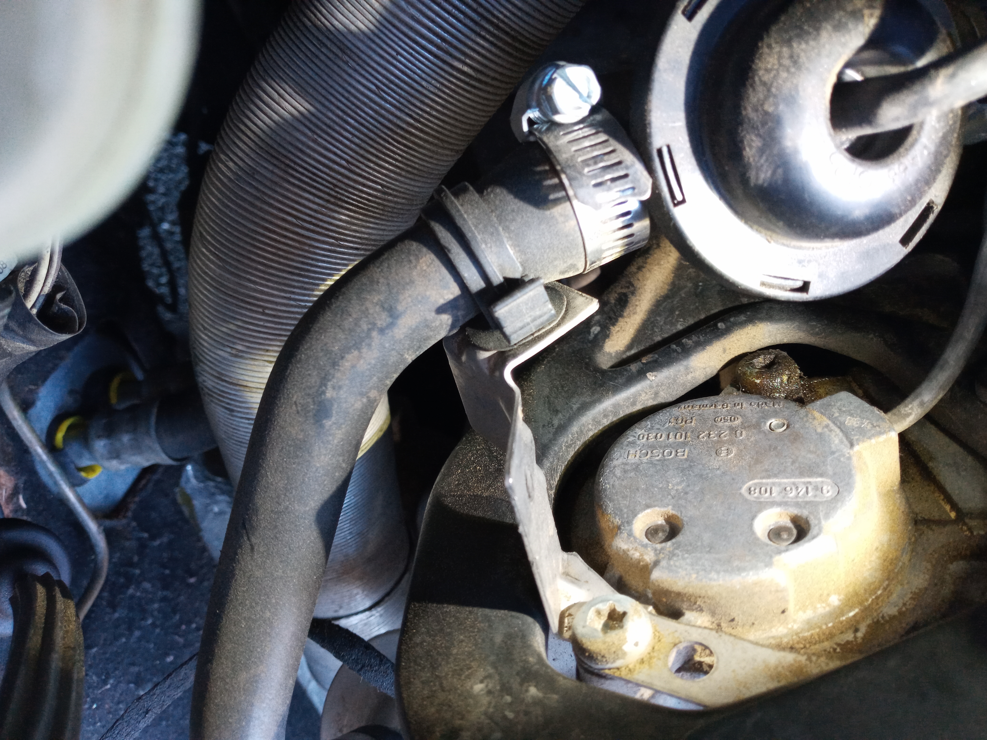

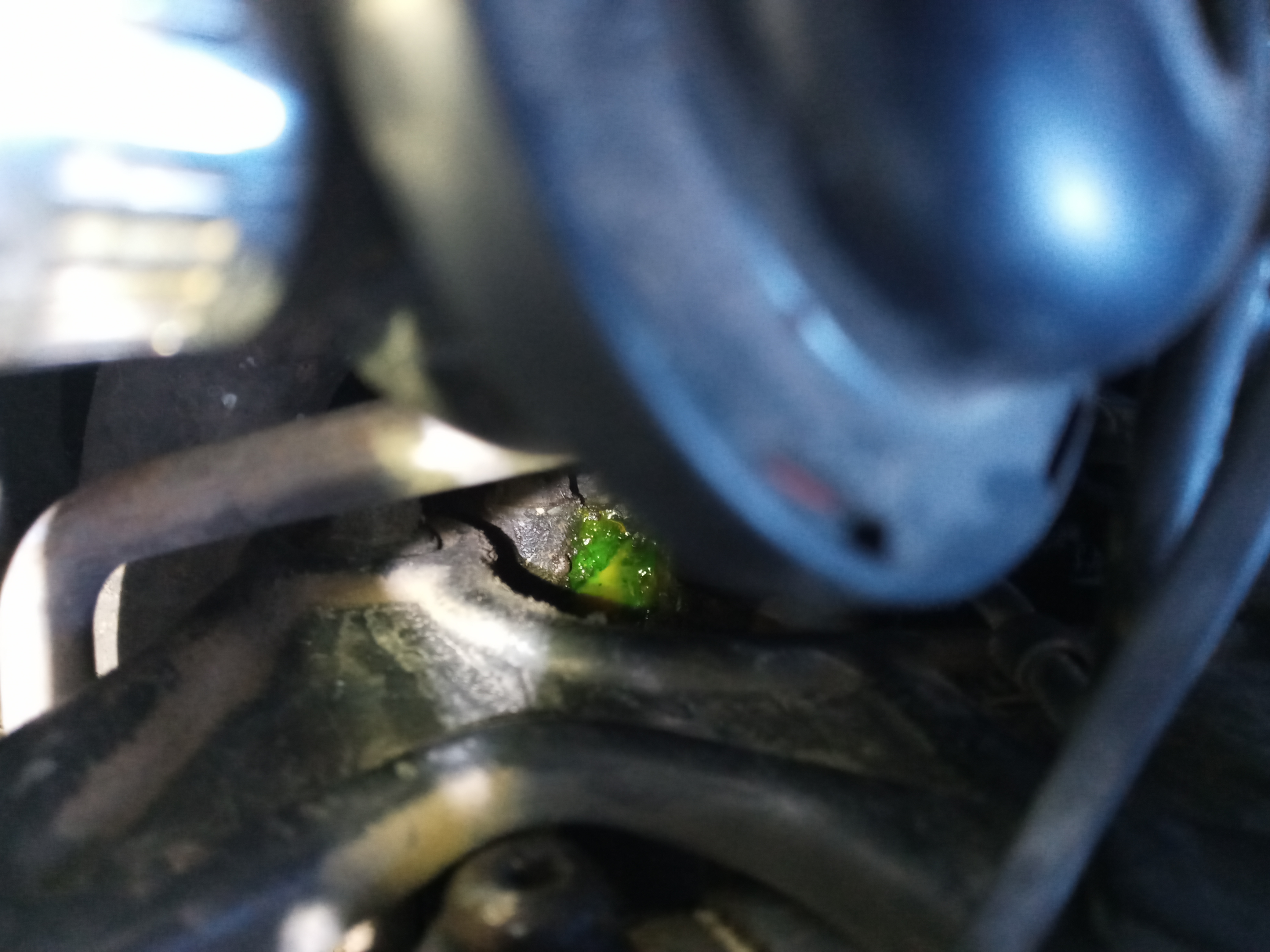

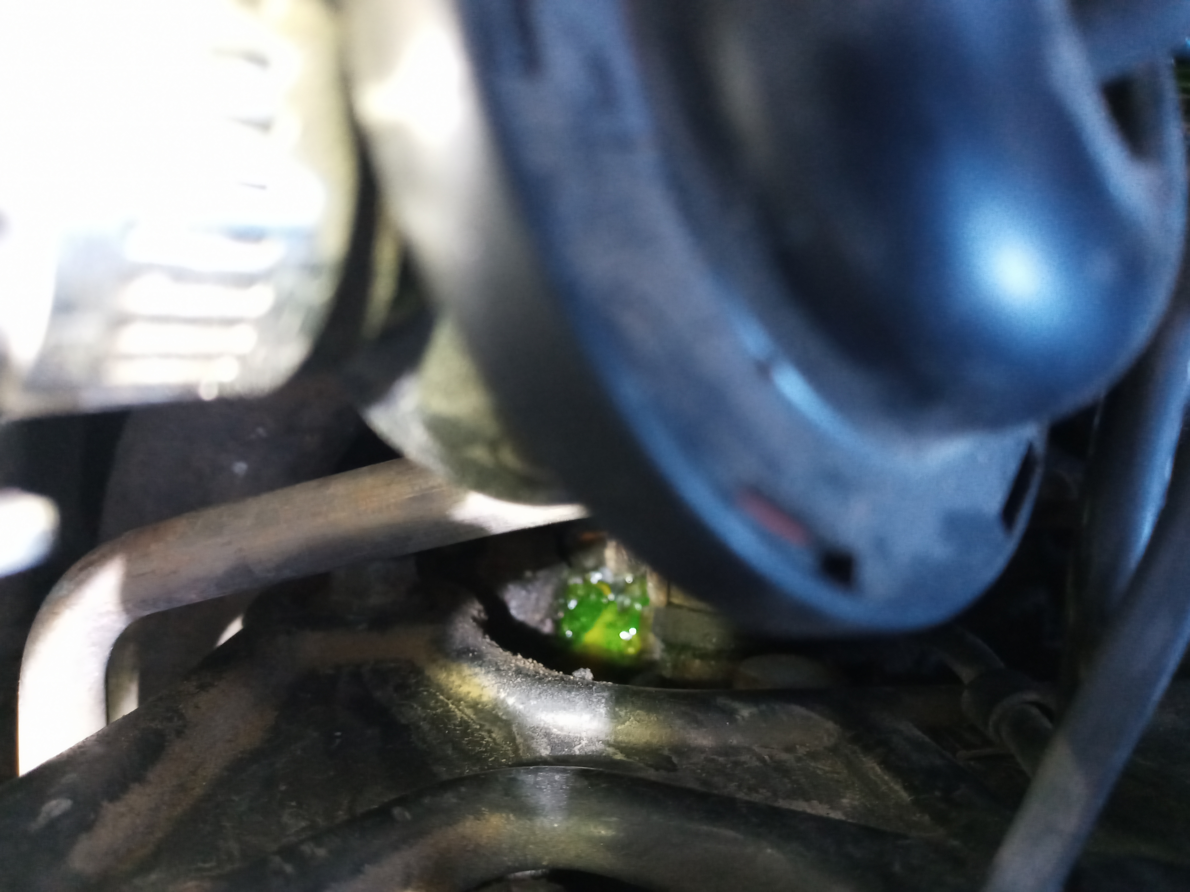

Looking to change my upper torque arm, and found this, please don't tell me it's a head, and if it is who believes in that pour in stuff, but what is it. It's right under where the upper torque arm is and down beside the engine. I really need help guys can someone be at my post today,.here is the pics I'm referring to. Thank you..

There is a heater hose attached right around that area, on the side of the head. Feel around and see if it's wet. I'm betting it's leaking right where it attaches to the fitting.

If a heater hose is leaking, it is tempting to tighten down hard on the hose clamp. However, better long term results are likely if you drain some coolant below the hose level, remove the hose, clean the likely corrosion on the hose barb, cut off the end of the hose were it was clamped (assuming hose is long enough), install hose, and clamp. Carefully refill coolant to proper level.

Ok just looked, that hose looks corroded, is that a pain to replace?

I keep getting ahead of myself on the post, the hose looks pretty short.😣

The hose is pretty easy to replace, but you need to be very careful removing it from the firewall coupler. It's plastic, and odds are it will break. I would recommend replacing both hoses, as well as the coupler. Or you can replace it with regular heater hoses and avoid having to deal with the plastic coupler again.

No right where that puddle is directly above there is a short hose it looks corroded. What's that hose, can you may not see it in the pic. I thought that was the one you were referring too. What do you think, will you need another pic? I'll try. Thanks so much man...

If you don’t have a turbo there are only three hoses there
A fat one to the radiator..skinny wrist size
Two small ones to the heater ...three finger diameter
The turbo has extra two for turbo coolant which are small, one finger thickness
