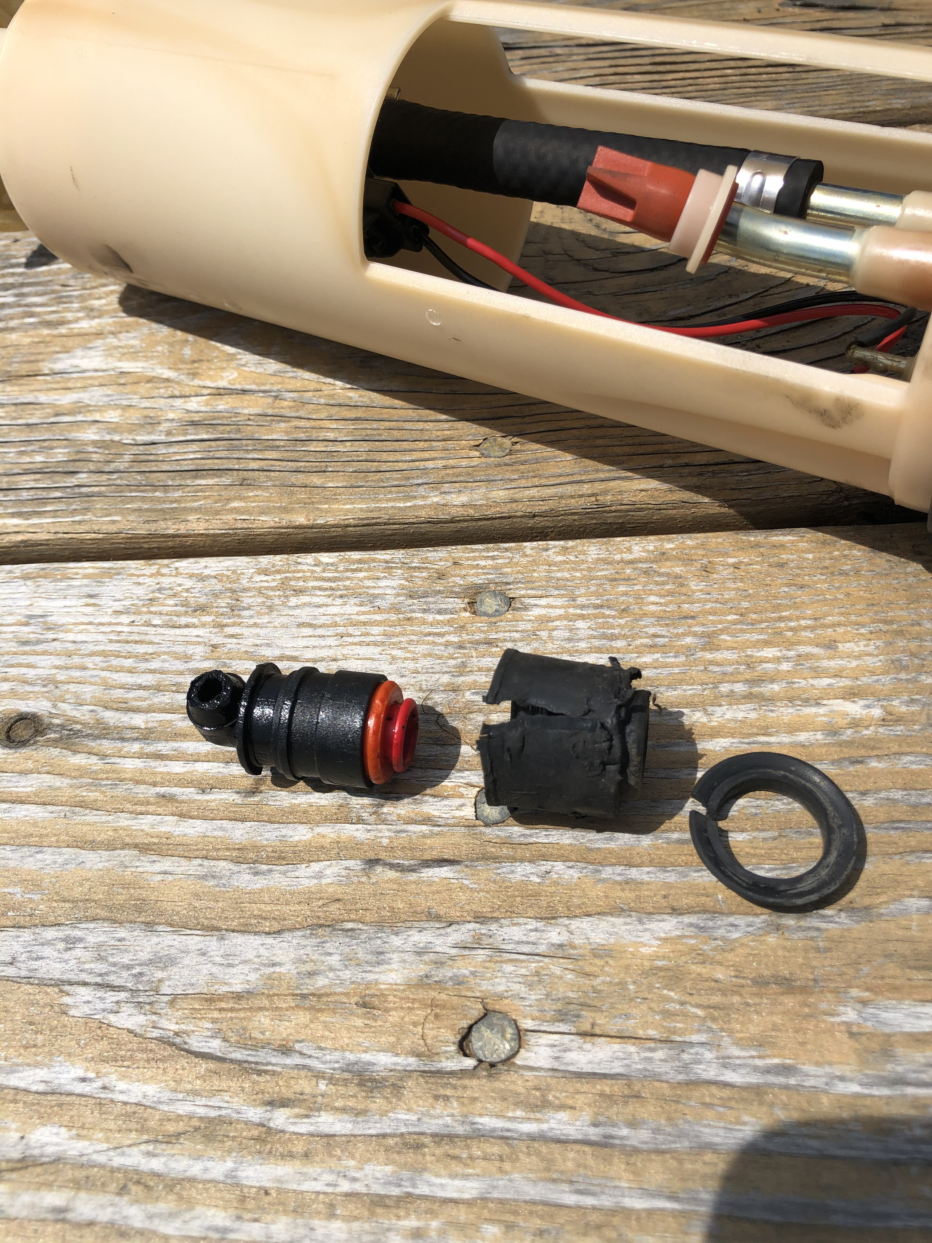

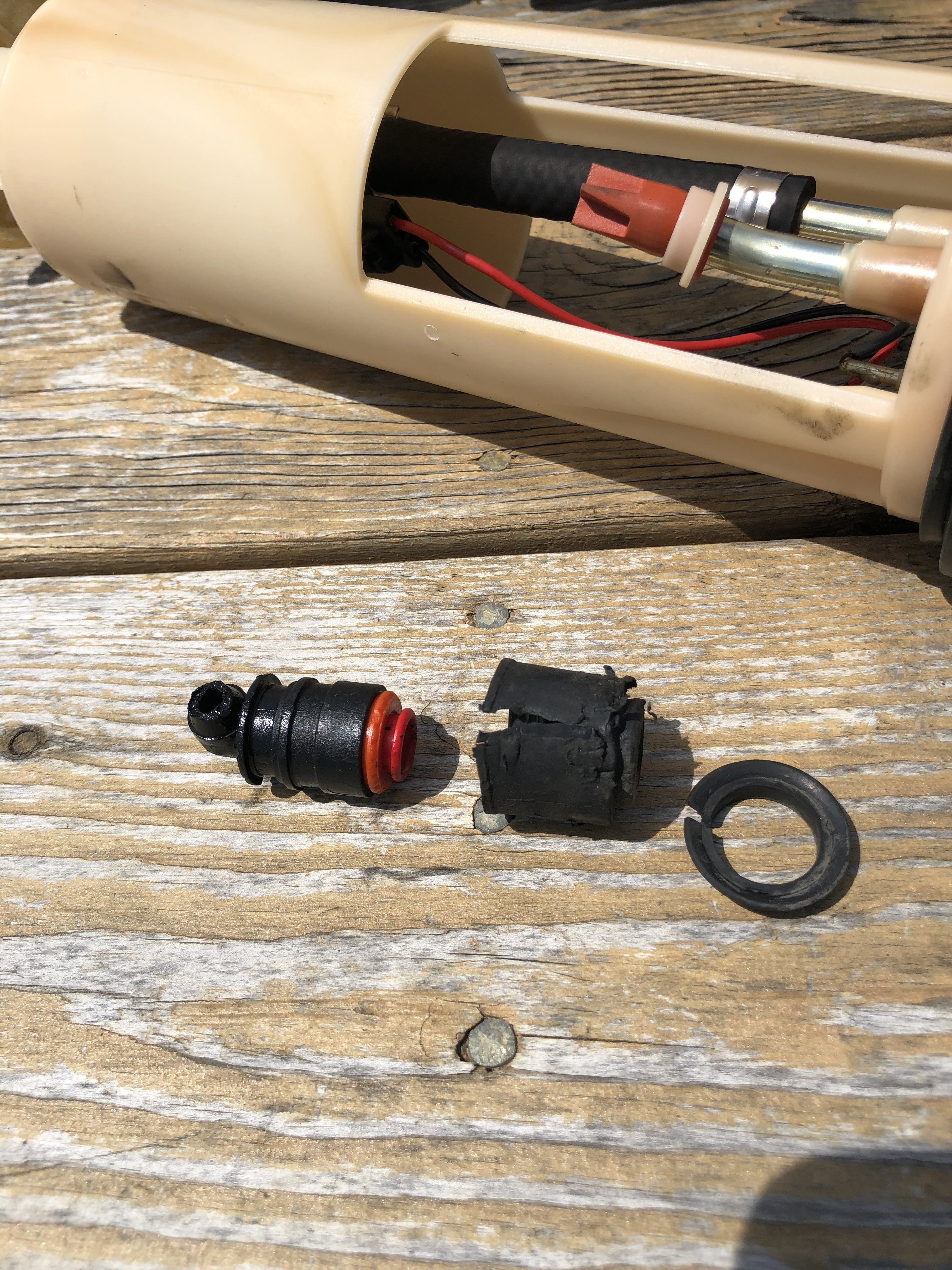

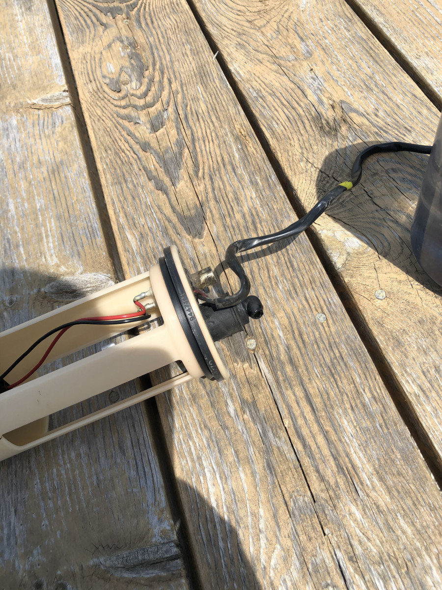

I am an idiot for forcing this while recovering a fuel pump from a parts car.
Broke the tab off the pipe.
I get a double DOH for not checking the basics first. I purged the fuel line and it recharged.
Finally I learned that crappy tire parts are a no no in all cases.

Images of the deviant part
2008 S60 2.5T Auto (Sold)
