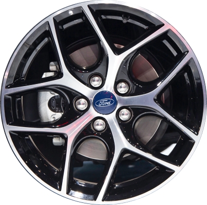

Just wanted to share I got gave some focus wheels like the ones below and while they are the same bolt pattern the hub bore is different and did not fit on my 2001 T5 V70 . If your the grinding type maybe but iv never done that stuff before and not sure if that's safe to do!

Very few wheels from other cars are likely to fit on Volvo, and on top of it you also need to match closely the offset, or your wheel bearings may take a beating. However, may be worth to know that the some wheels from older Volvo may work on the P2 platform. I think my S60 wheels are from a 98 or 99 which also had different lug head "angle", and these work well on P2 with the P2 lugs
