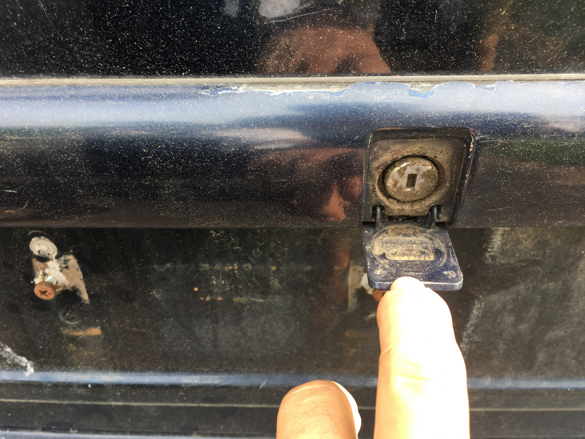

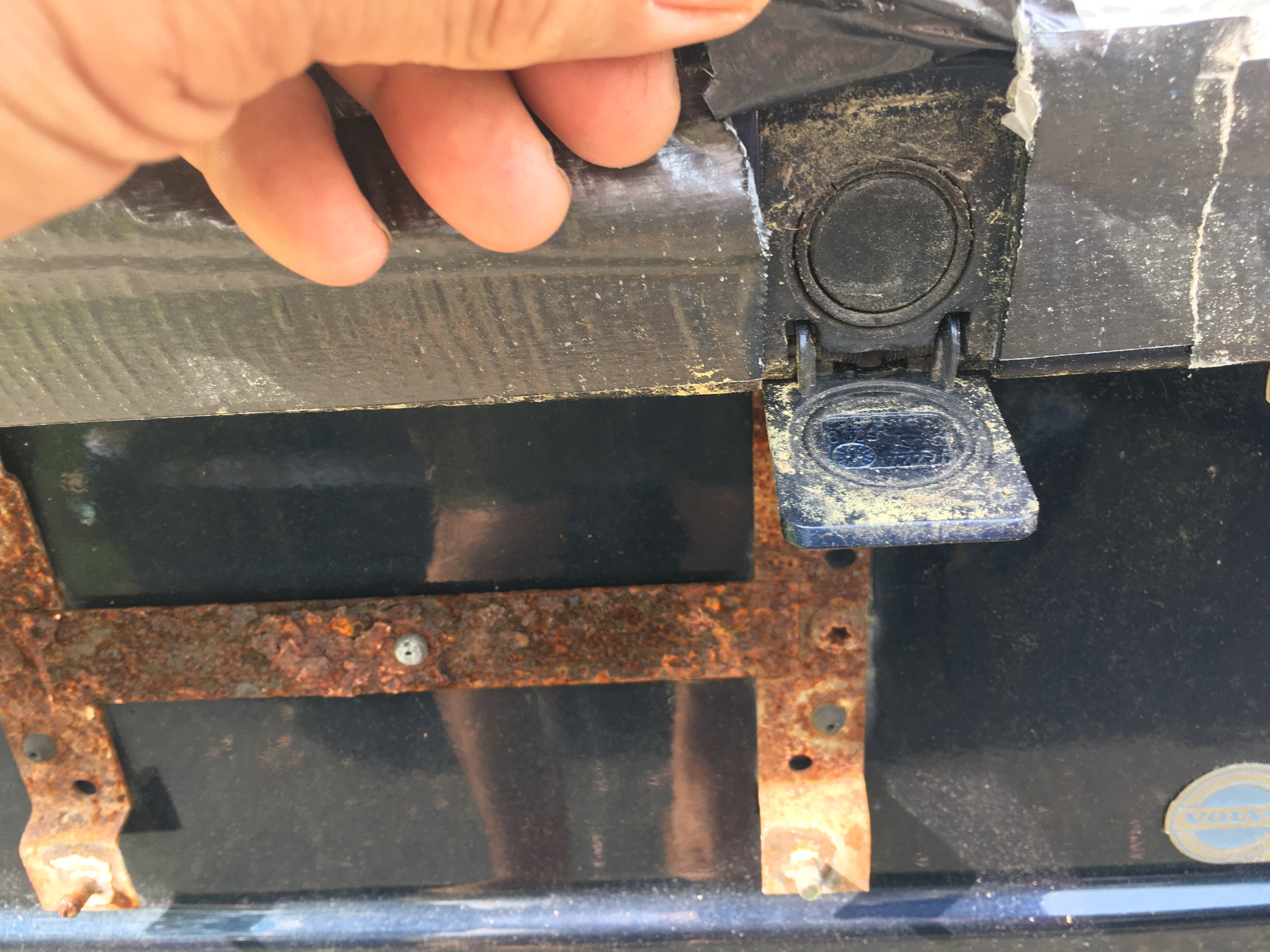

I'd love to know how you have a key mechanism at all in your V70. I've had two 2000 V70 and both had no key lock in the tailgate. It would save me a notable amount of time to be able to unlock just the trunk instead of doing so from inside the front door. Can I add one??
FireFox31
- Posts: 36147
It looks doable. The hole is blocked off with a removable cap
