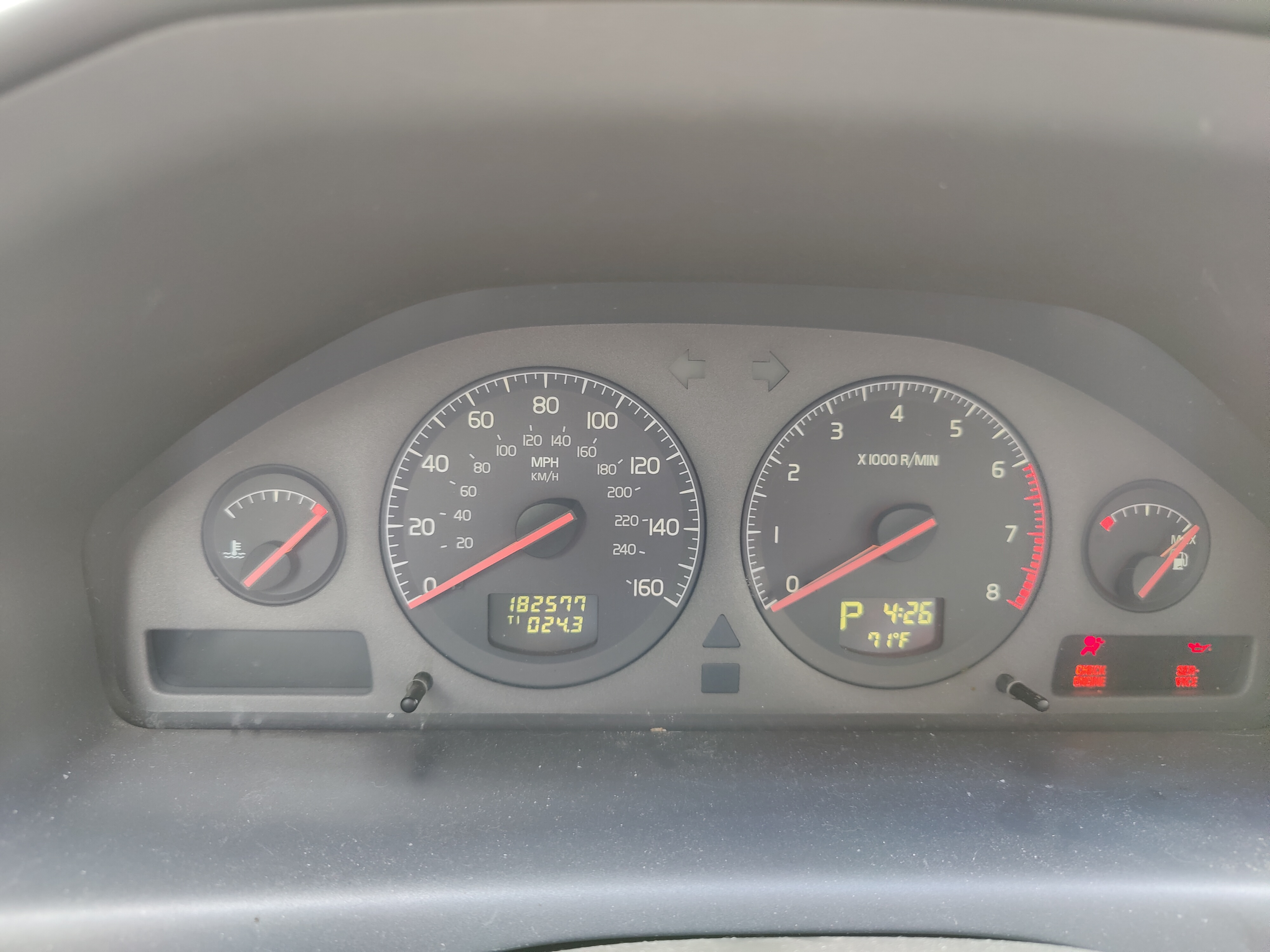

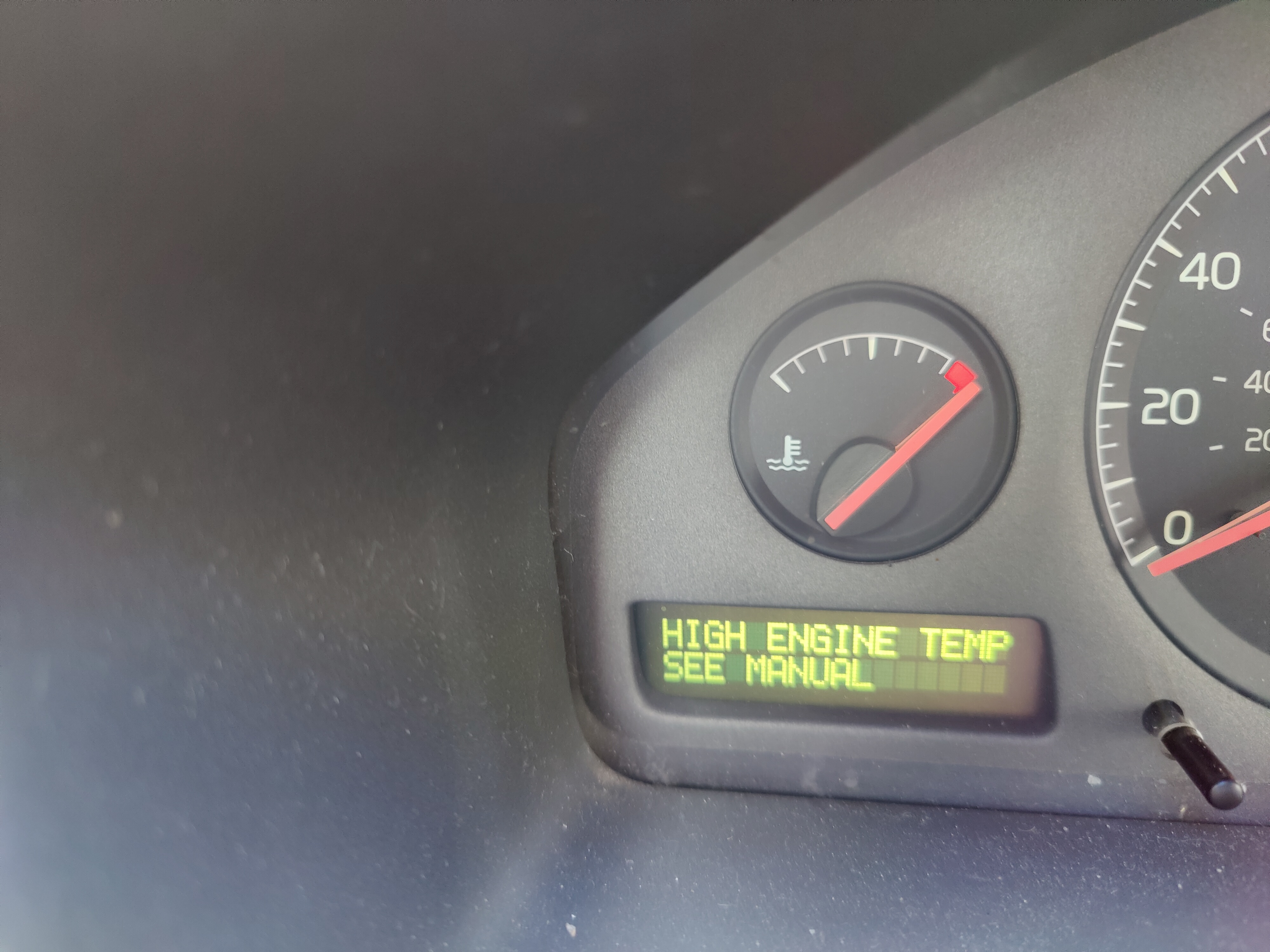

My temp guage pegged today while idling before I was getting ready to leave. Temp outside is almost 90F. I shut it off, popped the hood, and let it cool off. I did notice the upper radiator hose was extremely hot and the lower radiator hose was still cold.
My question is would this be the water pump, thermostat, or possibly something else? Even if the thermostat didn't open wouldn't there still be heat in the lower radiator hose? Any help would be greatly appreciated.

The temp guage pegs as soon as I start it. The engine is cold and the hoses are cold. Could it be a bad sensor? Where is it located at?

Look closer at the two wires going to the coolant temp sensor connector on the stat housing. Or maybe the sensor is shot

This is with the engine cold, and not running. The key is in position 2. Looks more like a sensor or wiring issue. I'm in the process of replacing my starter, and removed the two rear nuts holding the starter to the bracket on the engine block. I didn't have a problem before that, and I was removing the nuts with my arm wedged in between the power steering line and the intake manifold. I'm assuming from looking at the wiring that it runs along the block under the intake manifold and connects around the starter? Maybe I bumped something loose, or one or both of the wires are grounding out on the block causing the needle to peg. Any thoughts? I'd rather not pull the intake manifold off, but I'll have more access when the starter is removed probably this weekend. It's raining right now, and if there's a problem other than the sensor I don't want to drive it into the barn to work on it out of the rain. I really don't want to blow the engine.
