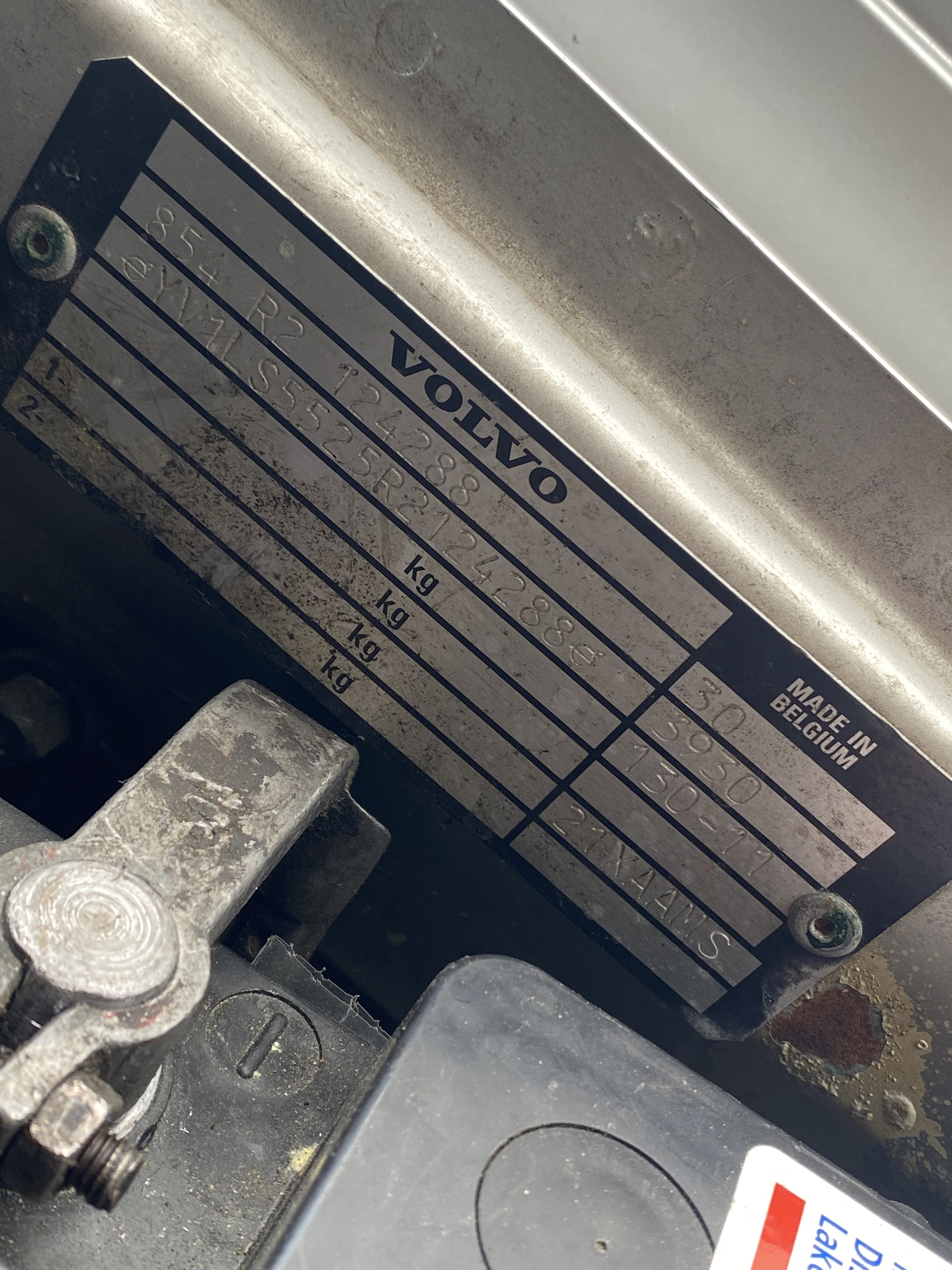

I have an 1994 850 non-turbo
Looking to replace control arms, inner and outer tie rods all together.
I ordered the parts a while ago, but before jacking it up, I wanted to do a little more research and I'm confused / worried about the inner tie rod compatibility.
according to FCP euro:
Position 21 will determine which Power Steering Rack and Pinion design your vehicle is equipped with.
Marked 4 = TRW
Marked 5 = SMI
Except, looking at my plate, in that spot I Have "21XAAMS"
there is no 5 or 4
anyone know what the right part is?
could it be one of these other spots?
https://www.fcpeuro.com/products/volvo- ... v70-271601

Not sure that works for 850's particularly that old. I will probably be corrected, but I believe that may only work for 98- cars (V/S/C 70's).

It may be better to check one of the Volvo parts sales sites like Tasca or Lisle to see if they give you better info. Also try Skandix in Germany.

Neil is close, this may help viewtopic.php?f=1&t=54721&start=10
