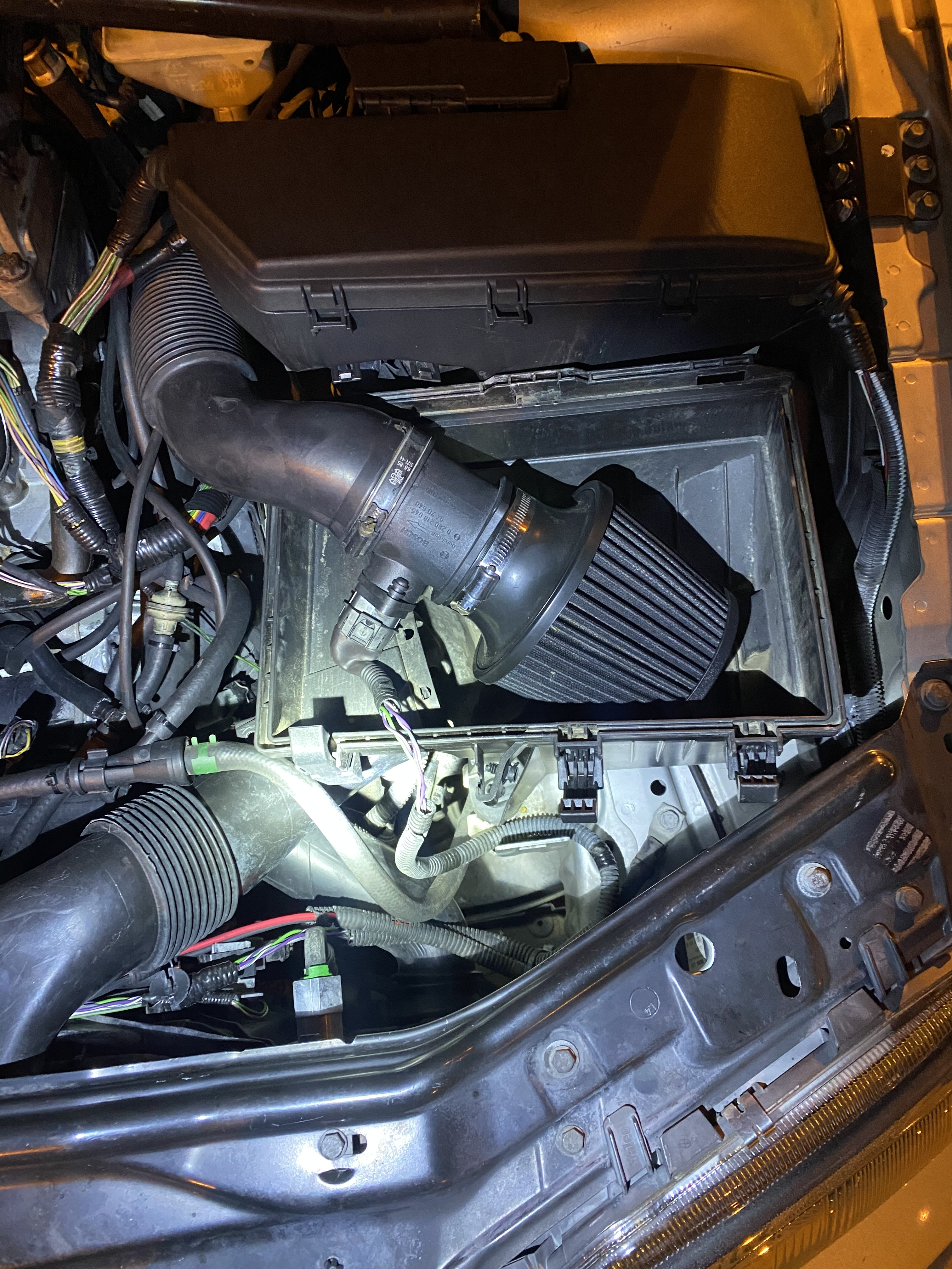

After doing much reading I believe my Mass air flow has gone out on my v70. When i got the car it had this filter put on by the lady's Grandson a week before the trans went out. I drove it didnt pay any mind tell the last couple of HOT (99 degree) days here in Arkansas and the car been acting funny. I'm thinking sucking in all that hot engine killed the factory 400K Mass air flow. Getting a new Bosch sensor and actual lid so it can get air in how it should and hope for the best. Just wanted to share incase this happens to anyone else!

Not likely. These things work by heating up a wire and then measuring the change in resistance as the air passing it cools that wire down.
Is that the kind of filter that has oil in it? If the kid overdid it, that could do in a MAF.

Yep oiled filter. I'm not a big fan of the open filter under hood thing but didn't pay to much mind to it. Iv always been under the impression on massairflow cars to use the dry type filter.kcodyjr wrote: 13 Jun 2021, 20:48 Not likely. These things work by heating up a wire and then measuring the change in resistance as the air passing it cools that wire down.

The air box lid should help intake temps. I never understood the open top stuff.

These "zero resistance" filters are engine killers!
Dry filter just decreases air flow when clogged.
Oiled filter stops trapping dust when clogged...

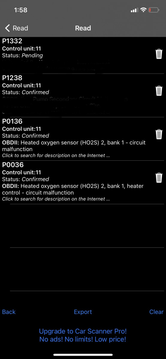

Well installed mass air flow sensor, cleaned ECM....... Went for a drive and bad idle and attempted stalling BUT no more ETM code
BUT a new one P1332
. Gotta say going from old 850’s to the P2 platform is a ROUGH transition. But I’m gonna stick to it. Oh and the new boost control is getting installed when it comes in tomorrow
. The 02 code has always been on the car because the old owner never had a 02 on the cat
