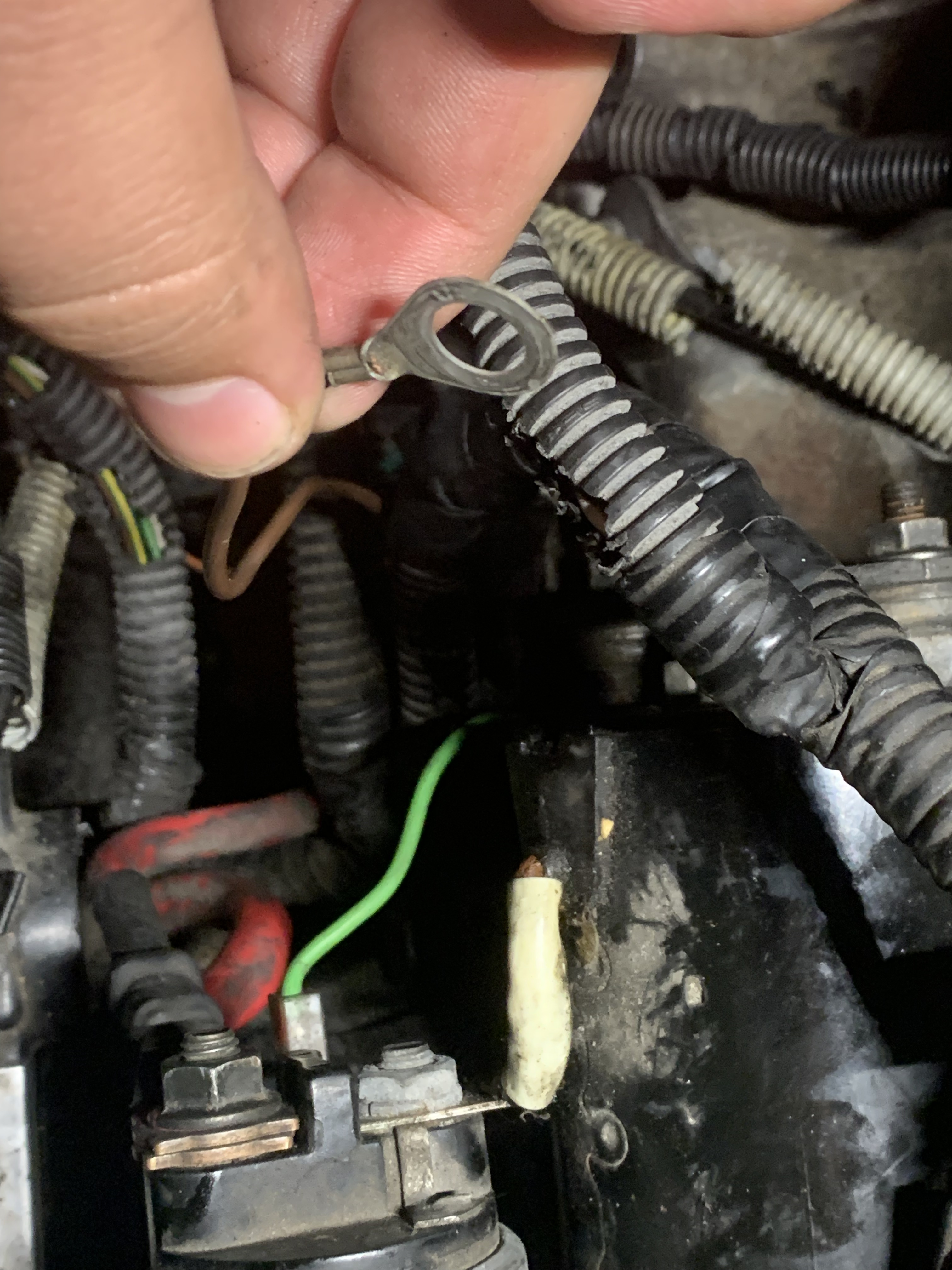

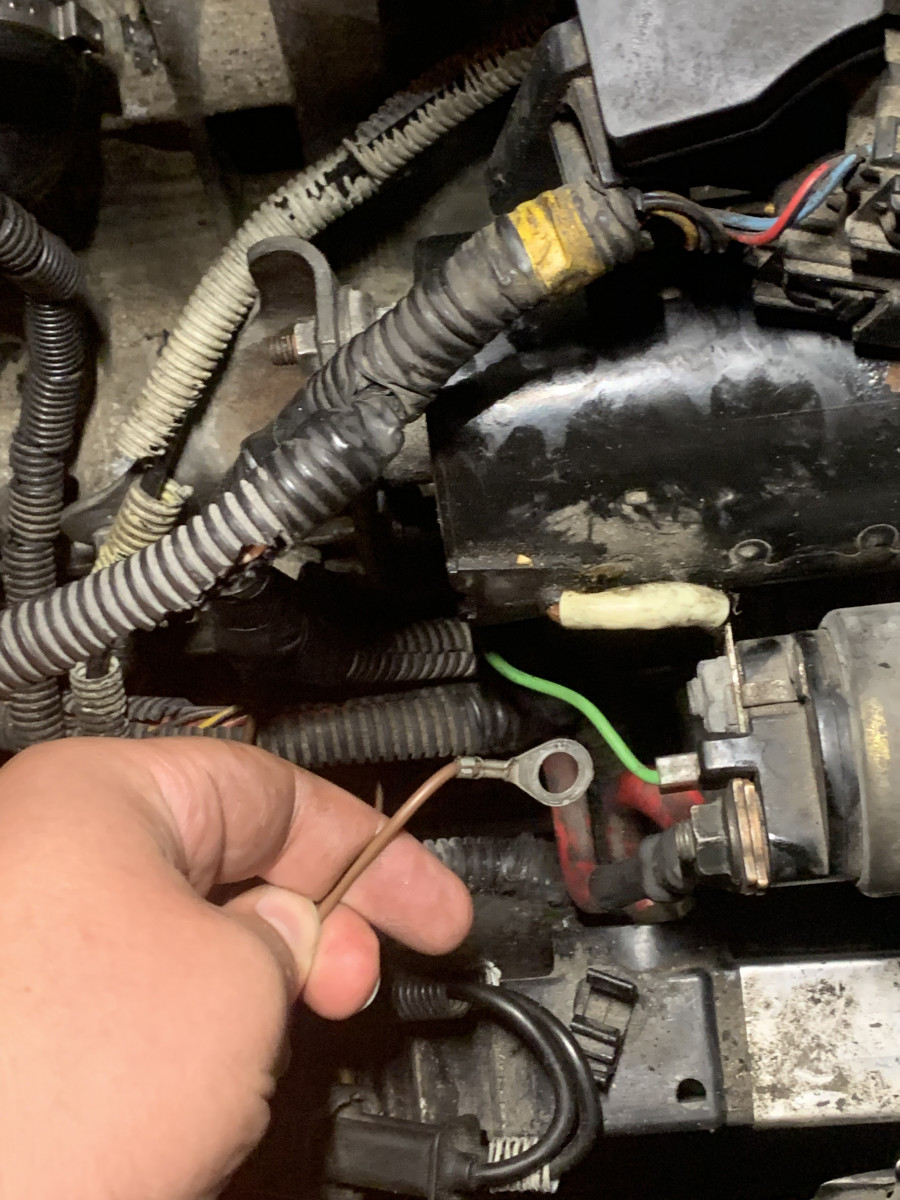

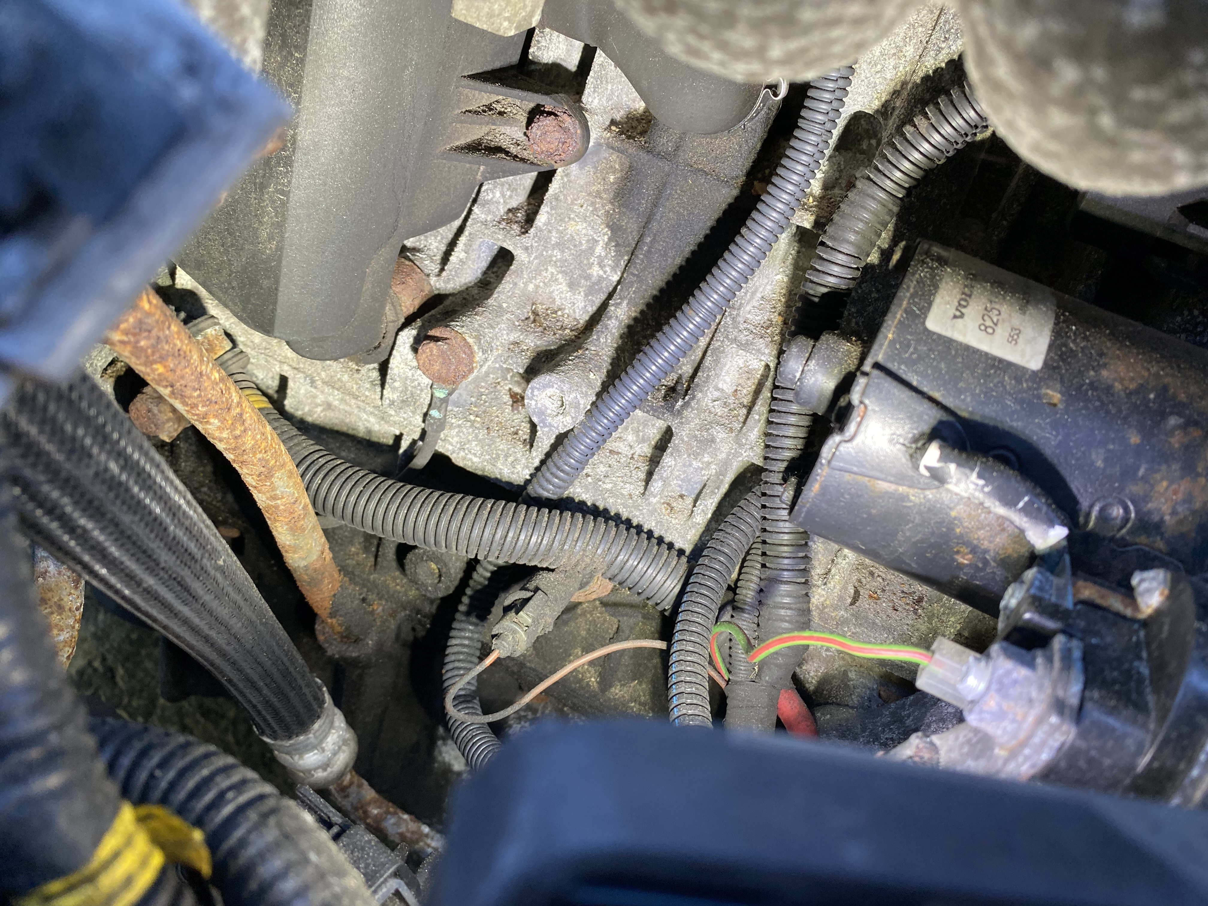

I recently took the engine out of my 2000 Volvo v70 and now that I am putting the engine back in I seem to have forgotten to put place one of the wires. The wire that I am having trouble with is a brown wire that is located by the starter. I cannot tell if it is a ground or power and I have no idea what it would go to. I have the starter in place and the manifold is still off.

Does it have a spade connector on it? Or does it have a round flat circular connector?
If it is the first is it the low voltage feed to the starter? There is a connector on the back of the starter near the main power cables.
A picture of the rough location might also help us here.

The brown colour and circular connector are consistent with a ground wire

Brown is typically a ground color in these cars.
I don’t have hands on experience with 2000’s,
but I would also suspect it belongs on a bolt.
If it is coming from a piece of wire loom, it might
be helpful to know what other wire colors are
in that section of loom.
