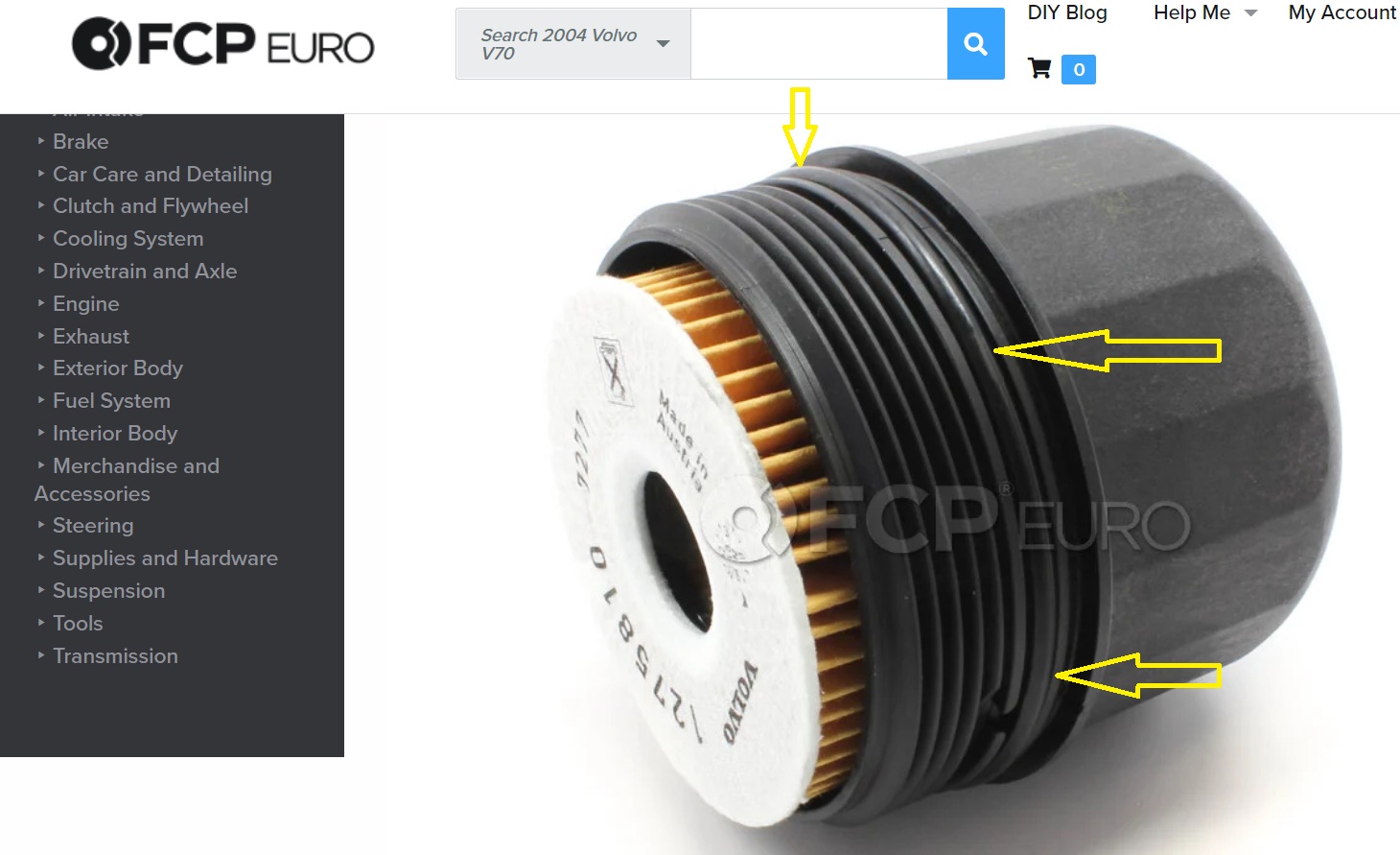

Ok, don't make too much fun of me here because my wife is really pissed at me. I must be getting old because after chnaging the oil on my P2, I have oil leaking everywhere and I think I know the problem. Funny as I have done the oil change on this car several times now with no trouble.
Can someone please verify for me where that darn rubber o-ring is supposed to sit. There are alor of plastic threads on that cap and for some reason I placed the new "o-ring" all the way at the bottom sitting up against the cap flange. I am going to assume that is wrong by now. Please let me know.

- No problems, we all make mistakes here and there.
- Here you go...
