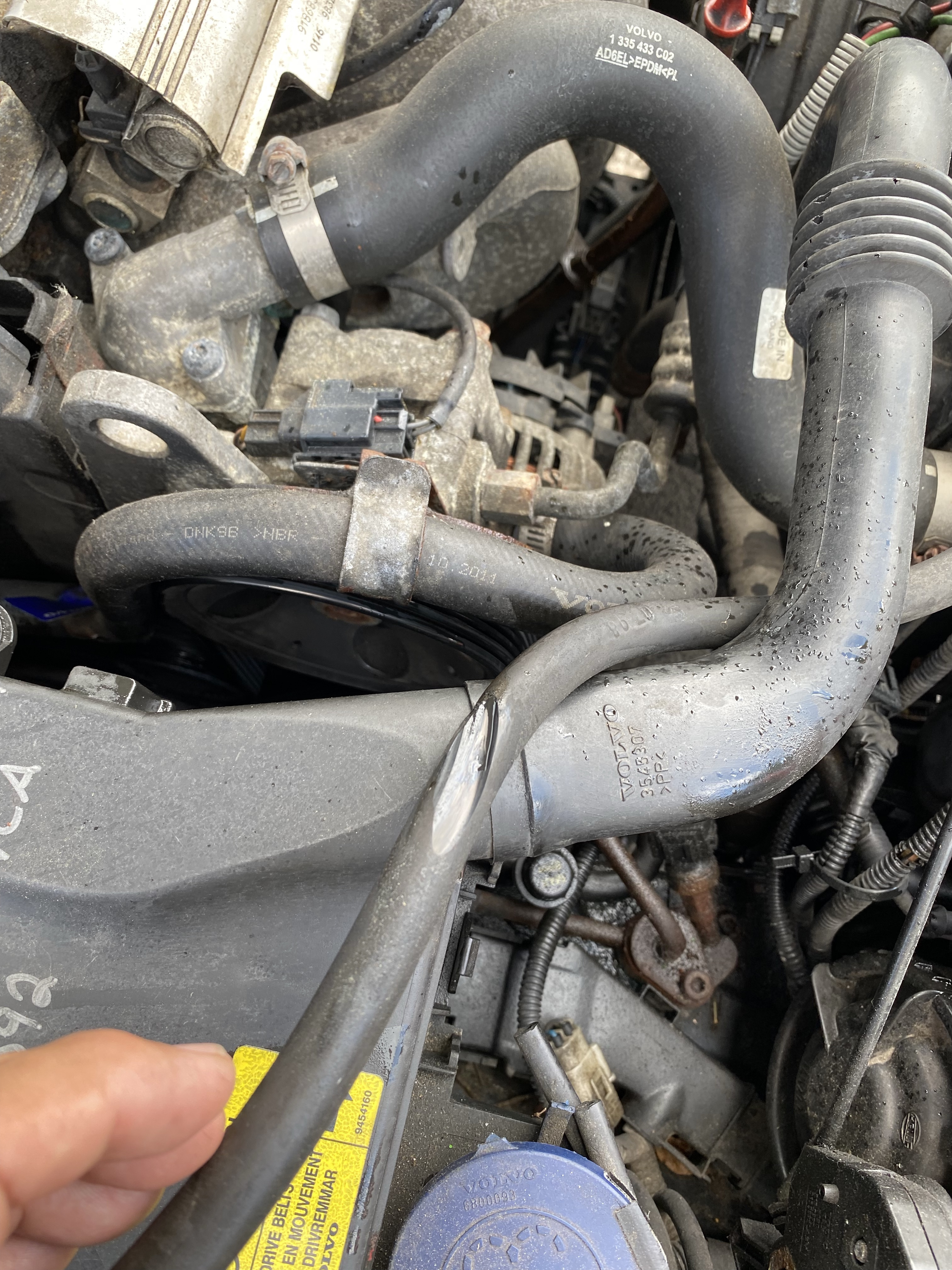

Low coolant light flashed its warning. Noticed at 65 mph on highway. I had checked coolant on weekend and it was fine.
I continued driving , watching coolant gauge which was locked on 3pm position.
5 minutes later reached destination. Coolant bottle empty.

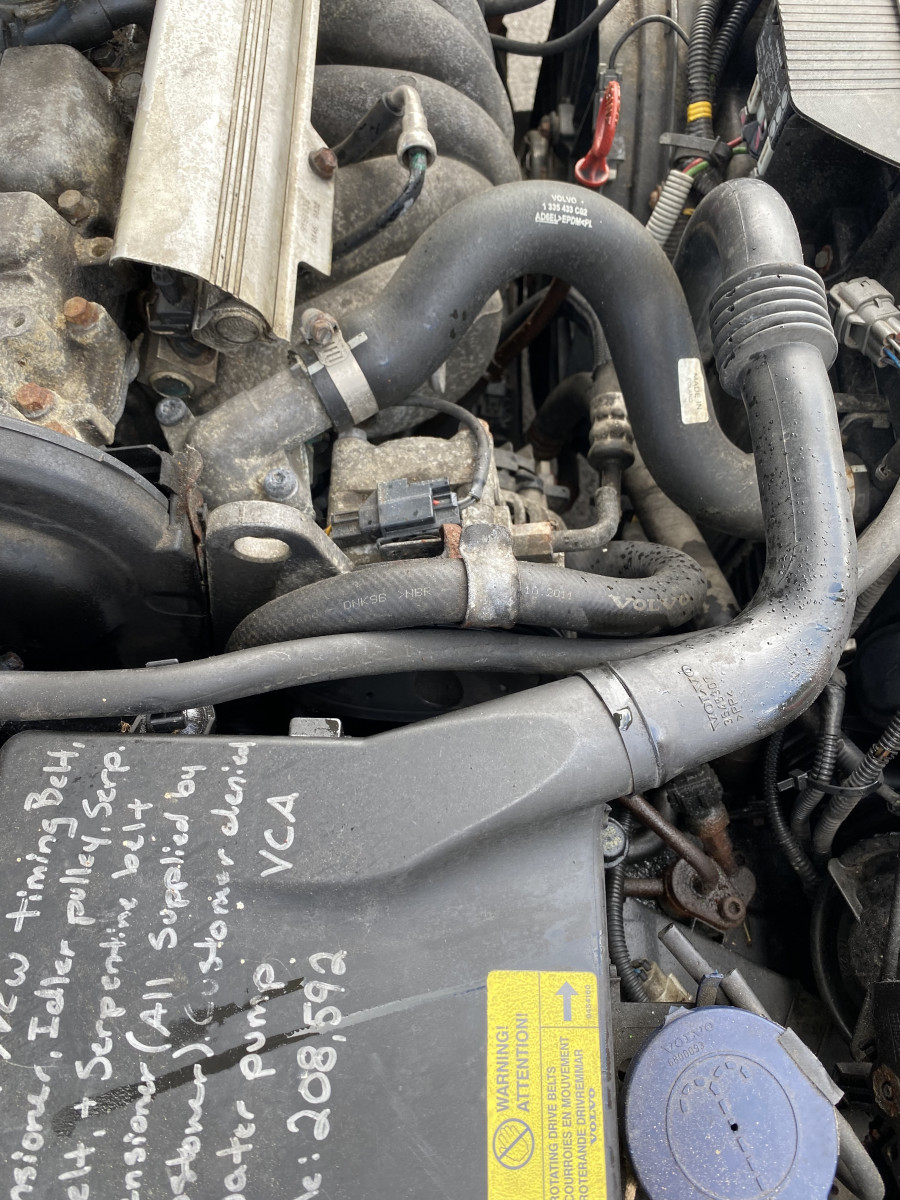

I had routed 1999 return hose form radiator to bottle under the ECU snorkel and it had dipped down and caught the PS pulley. A nice gouge was machined out and a 1mm thick stream of coolant was projecting out about 30 cm
I topped off with spare coolant , wrapped with electrical tape from the spare Kit, and drove home 12 miles without incident
P80 minor road incident 1999 v70

Gory pictures. The original hose had softened and sagged into the pS pulley. In later model 1999, the ECU air snorkel has a additional clip to pick up the radiator hose my early 1999 does not have
Another fix is to drape the hose over the air snorkel
This is extreme 1999 Volvo trivia

Or a zip tie on that ECU vent exhaust hose.

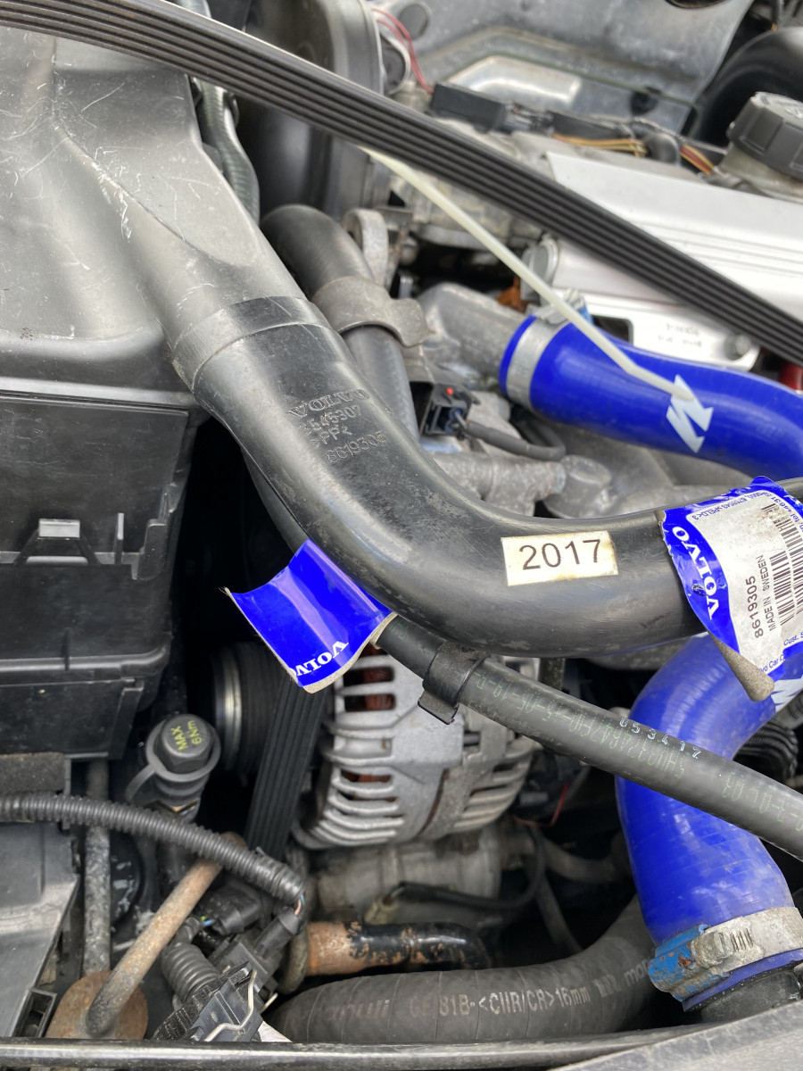

I modified my snorkel tube to add the clip as the original had fallen apart. Transferred the one from the original.

Everything pretty much worked as intended. I caught the coolant light with a cm of coolant Lefton the reservoir, popped hood , and saw problem right away. The hose had gotten soft vs the new one , but I’ll will figure out a way to secure it from a repeat in 20 years

looks like they added an extra hose or snorkel for every new model year. I spot at least 3 that my 96 doesn't have. More hoses and snorkels equals better car. Quite simple ...
