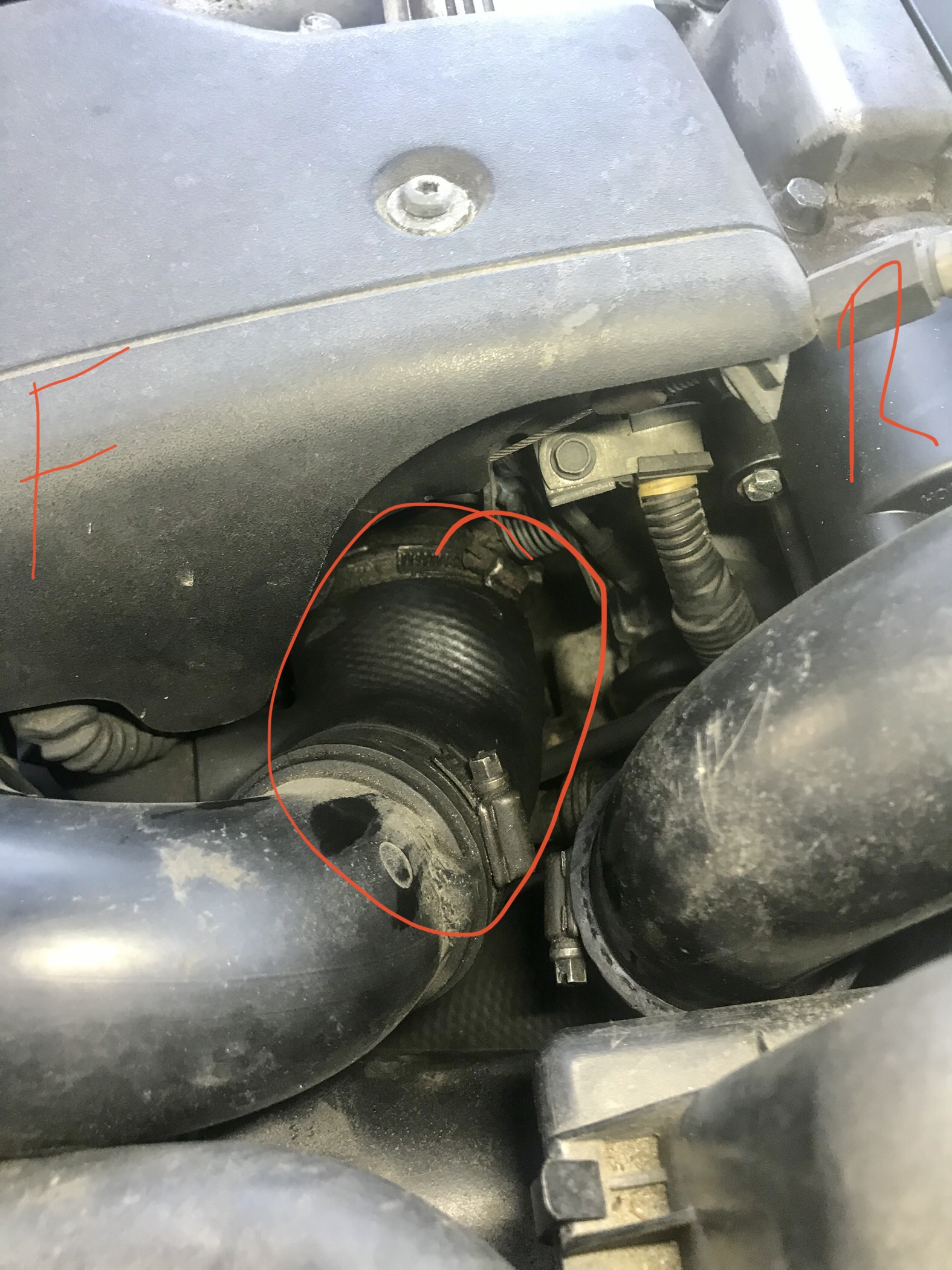

I’m having a hard time locating this portion of hose. Can someone please help me out? The current one is ripped in half which I’m sure is not helping the performance of the engine.
TIA folks

That's an intercooler piping hose for the turbo boost. Car should run terribly if it's ripped. They get oil soaked from normal usage then get soft and spongy, possibly all of them need changing if you're going to keep running the car.

Volvo PN: 9161093 Hard to see in your pic, but it does have the little offshoot hose going to the IAC right?

Yes. It’s been running horribly. I hunted and then I found this. It seemed like a Dumb question but…erikv11 wrote: 03 Jul 2021, 10:47 That's an intercooler piping hose for the turbo boost. Car should run terribly if it's ripped. They get oil soaked from normal usage then get soft and spongy, possibly all of them need changing if you're going to keep running the car.

Thank you. Definitely need to get that thing fixed.FlyingVolvo wrote: 03 Jul 2021, 10:59 Volvo PN: 9161093 Hard to see in your pic, but it does have the little offshoot hose going to the IAC right?
