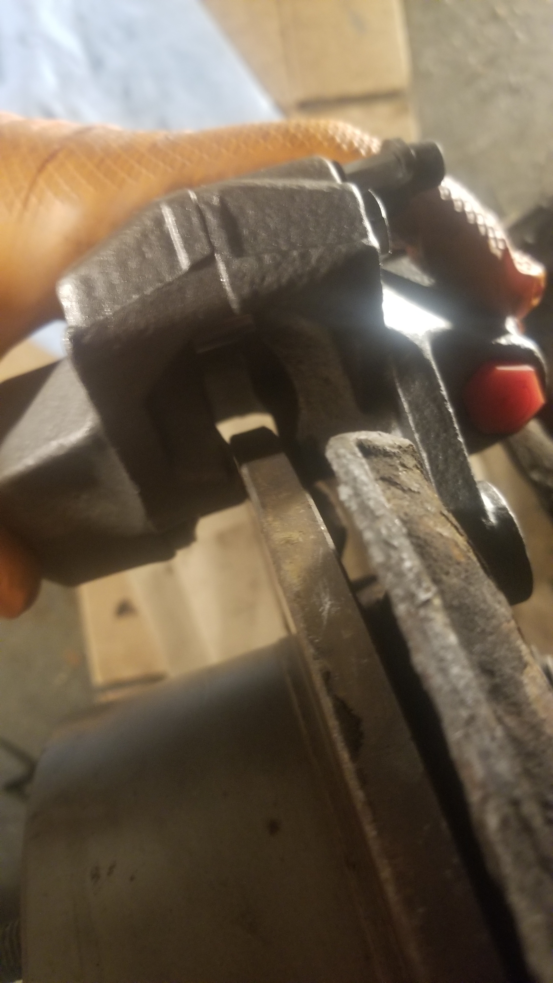

The new Right Rear caliper came in today, and again, I could not install it because the inside of the caliper was hitting the rotor in exactly the same manner as the caliper I sent back. This threw up flags and made me question my prior judgement. [scratch head for a long while]
-I again removed the Left Rear caliper to compare the two, and again, they looked like solid reflections.
-And again, the Right Rear caliper fit on the left mount with correct rotor clearance on both inside & outside.
-I attempted to mount the Left Rear caliper on the right side, but could NOT because it hit the rotor in the similar manner as the two replacement Right Rear calipers.
-The Rotor is mounted as it should be, and without any junk behind it as an offset.

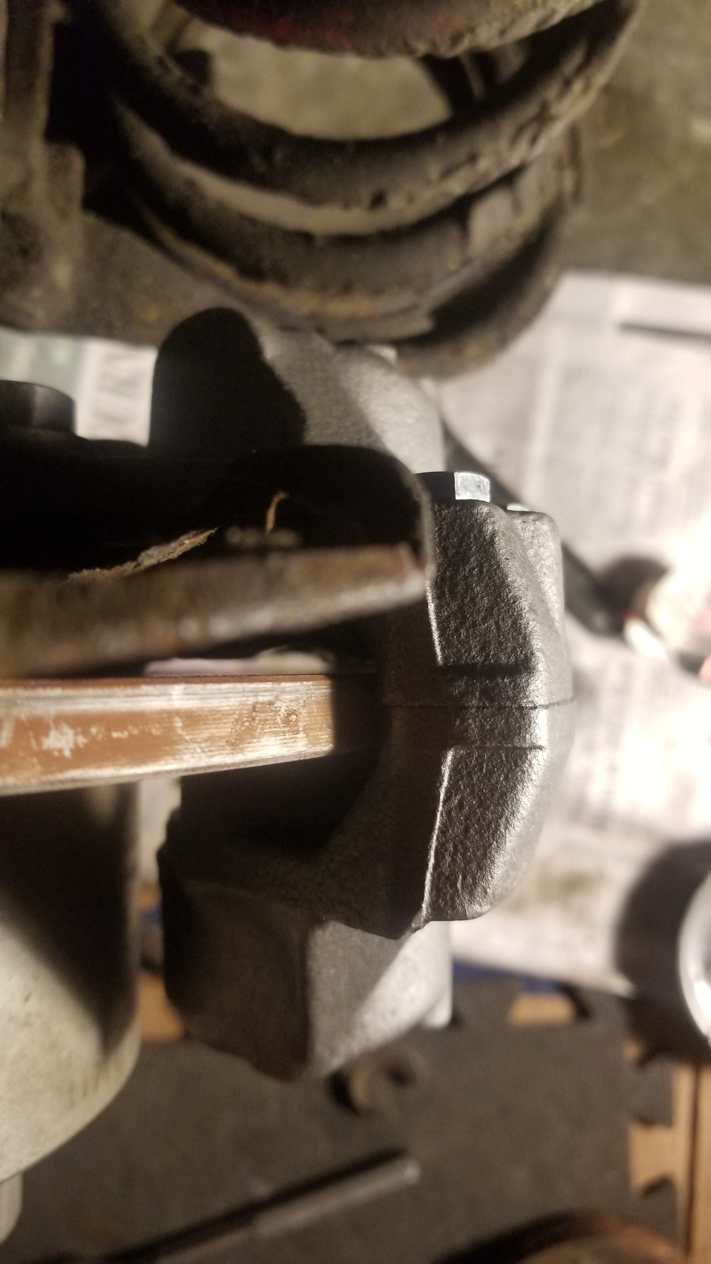

----- Old Caliper Right -----
~19mm mount surface to inner edge
~35mm mount surface to outer edge
----- New Caliper Right ----- ~19mm mount surface to inner edge
~32mm mount surface to outer edge

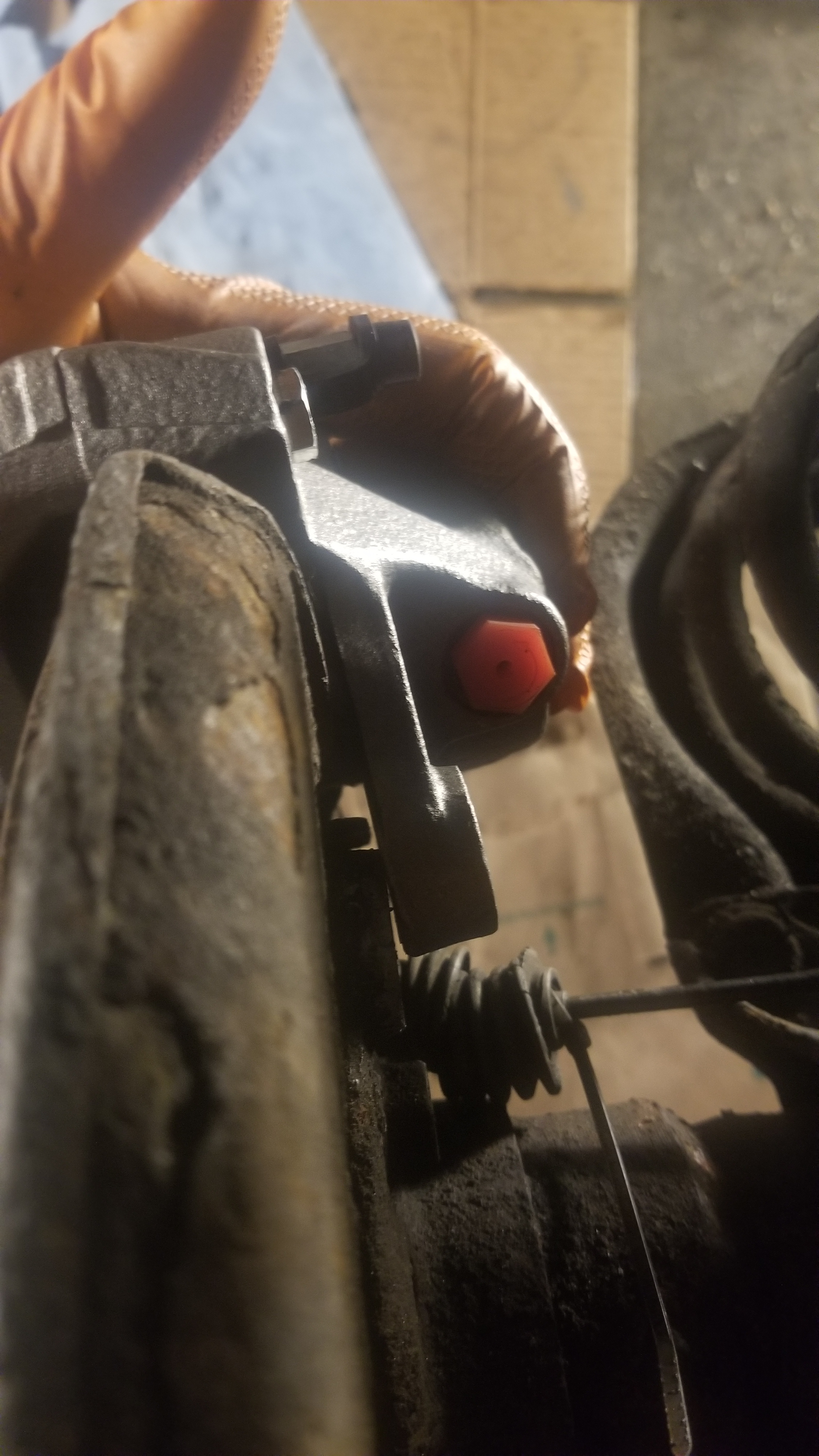

----- New Right Caliper on Left Side ----- Note that there is visible clearance between right caliper and left rotor.

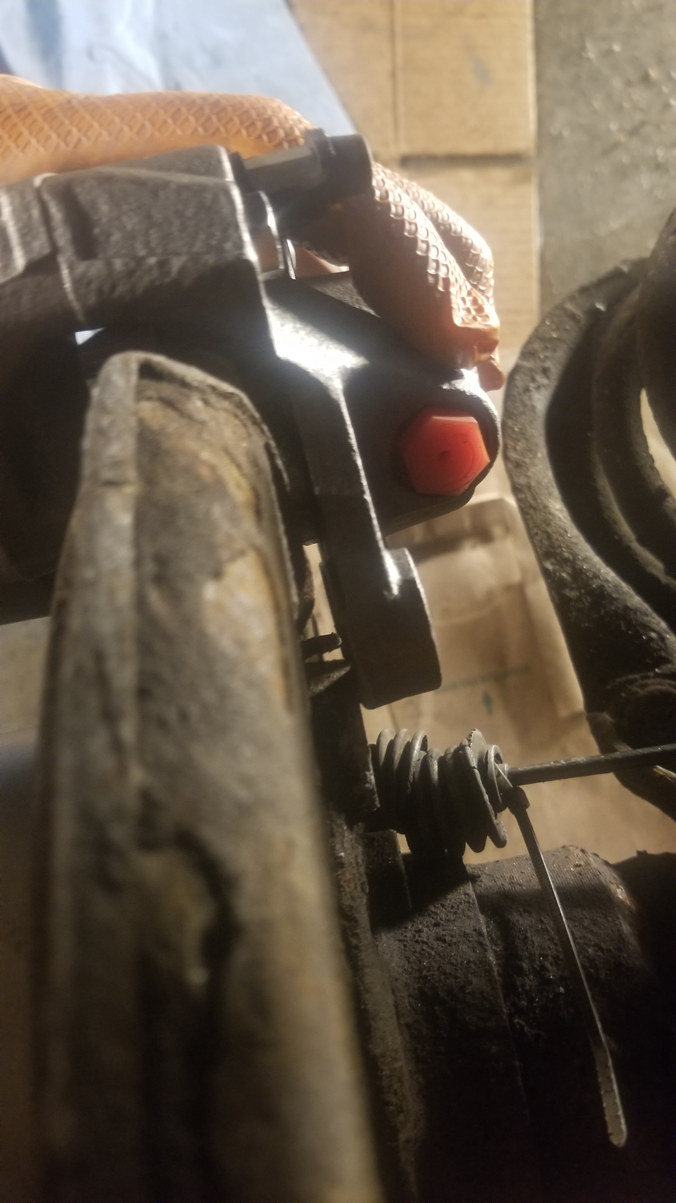

----- New Right Caliper on Right Side ----- The new Right Caliper centered about the right rotor (as it should be (and was on the left side)).
When the Right Caliper is centered about the rotor, the mount tabs are not co-planar (slight angle).
I could not fully mount the Right Caliper because it would hit the rotor such that the mount tabs are at a distinct angle.

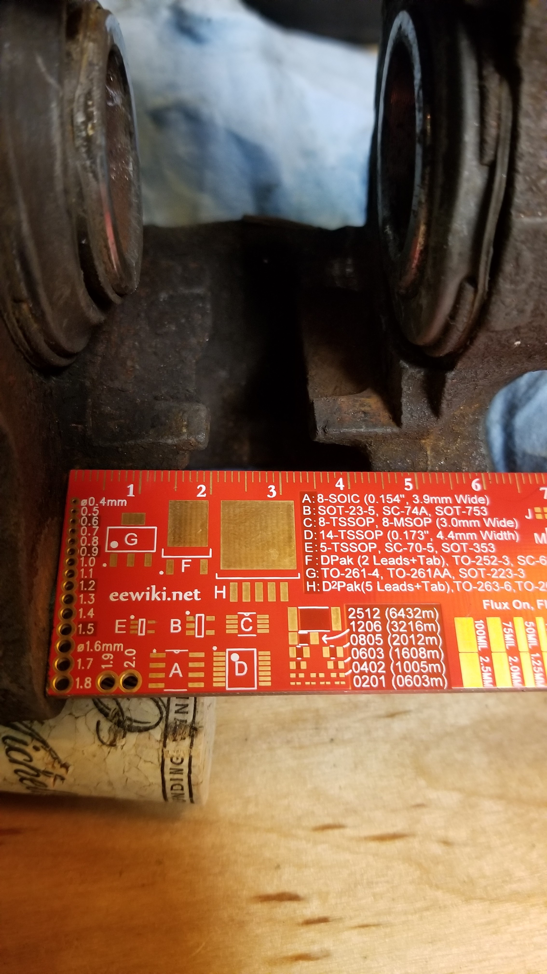

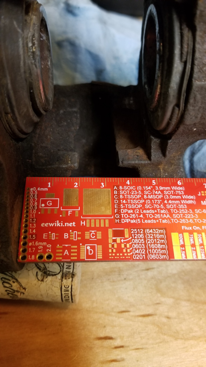

Took some more measurements.
The distance from the mounting tabs to the inside of the Rotor is ~24mm and the Rotor is 10mm thick.
The distance from the mounting surface of the caliper to the inside slot edge is ~19mm (so under 24mm), and ~32mm on the outside edge (unfortunately under the 34mm required for rotor clearance). Those 2mm of overlap collision is what is making them not fit. <grrrr>

Further investigation suggests that the new calipers ARE fabricated correctly.
I determined that my axle bearing has a 2mm gap between it and the axel's shoulder (which it should be flush against).
The 2mm hopefully will allow the caliper to be correctly mounted.
