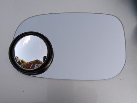

This says it works with the 2009 XC90 but not the R-Design. No heating elements on the back of this stand alone glass.
https://www.ebay.com/itm/392585113957?_ ... %3A2047675

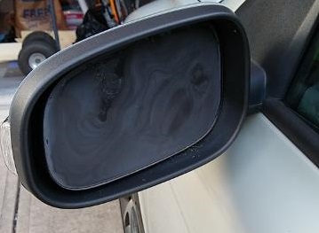

Found pictures from last year of the driver's side when it started wobbling. This time didn't let it fall and break while driving.
