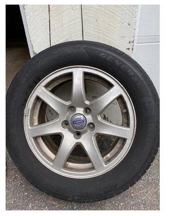

Found a set of 16" wheels/tires that are available locally and trying to understand if they will fit my 2006 V70.
I'm currently running 17" Thors, but the idea of a cushier 16" ride is appealing.
Any ideas what these are (or what the original fitment was)?
OEM Wheel Identification Assistance?

MDK here...so, those wheels are for a 2008 V70..I don't know the name or the center bore or the offset. But I'm pretty sure that is the first year of the new body style. I doubt they'll fit an 06. Not only that. If they're for sale then there's probably something wrong with either the tires or wheels or both.

They look like Naos which is Volvo part number 30748344.
Look for a Volvo part number on the back side of the wheel.
Naos has a 20 year history from 1998 - 2018. Mostly V70 but was also used on S60 & S80 depending on year.

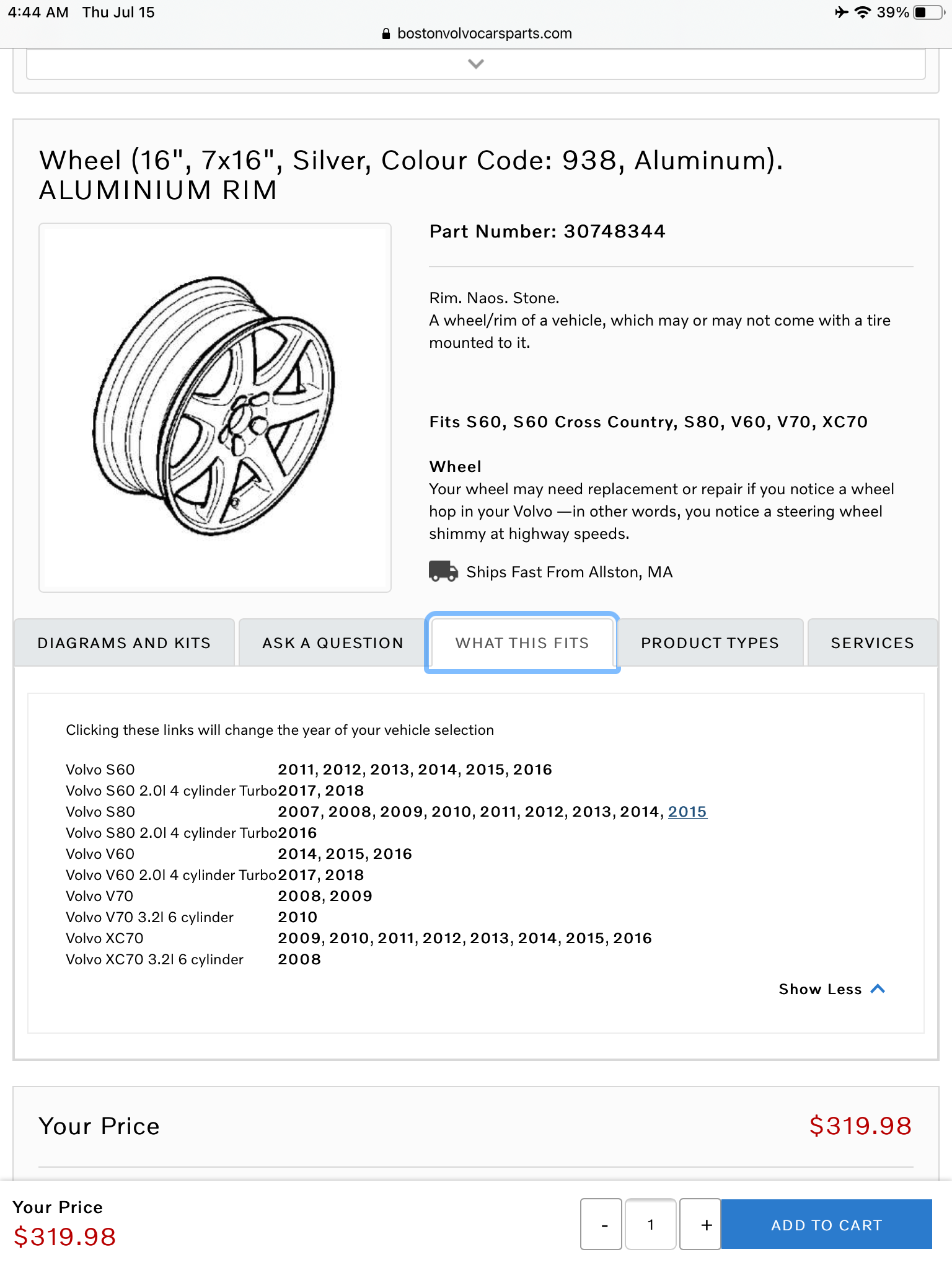

I think Naos were a later wheel from 2008 on. If I have actually corrected a RHP mistake I will need the rest of the day off for stress reduction.
It’s definitely a Naos wheel though

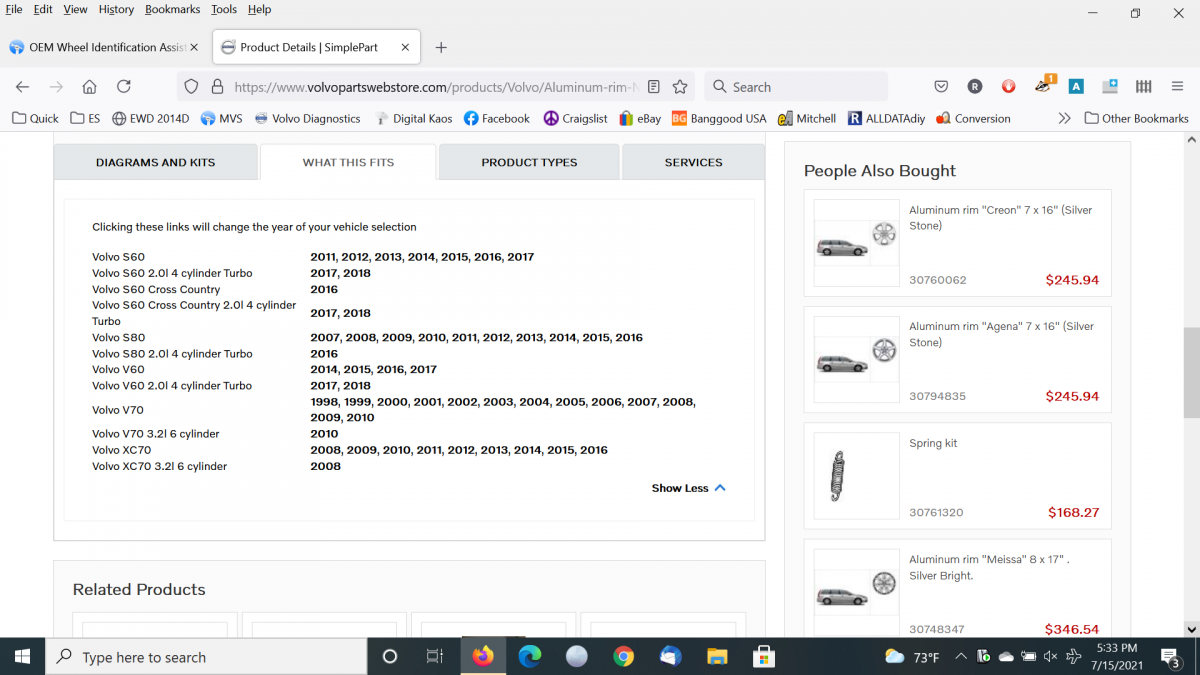

Google 1998 Volvo V70. Click on images. Check out the wheels.

It doesn’t show in the P80:wheel chart link above, and volvo OEM shows fitment for later models
No doubt there are lots of P80s running these as they are nice looking wheels.

Hum ... Depends on where you look or who you ask.abscate wrote: 15 Jul 2021, 02:46 It doesn’t show in the P80:wheel chart link above, and volvo OEM shows fitment for later models
