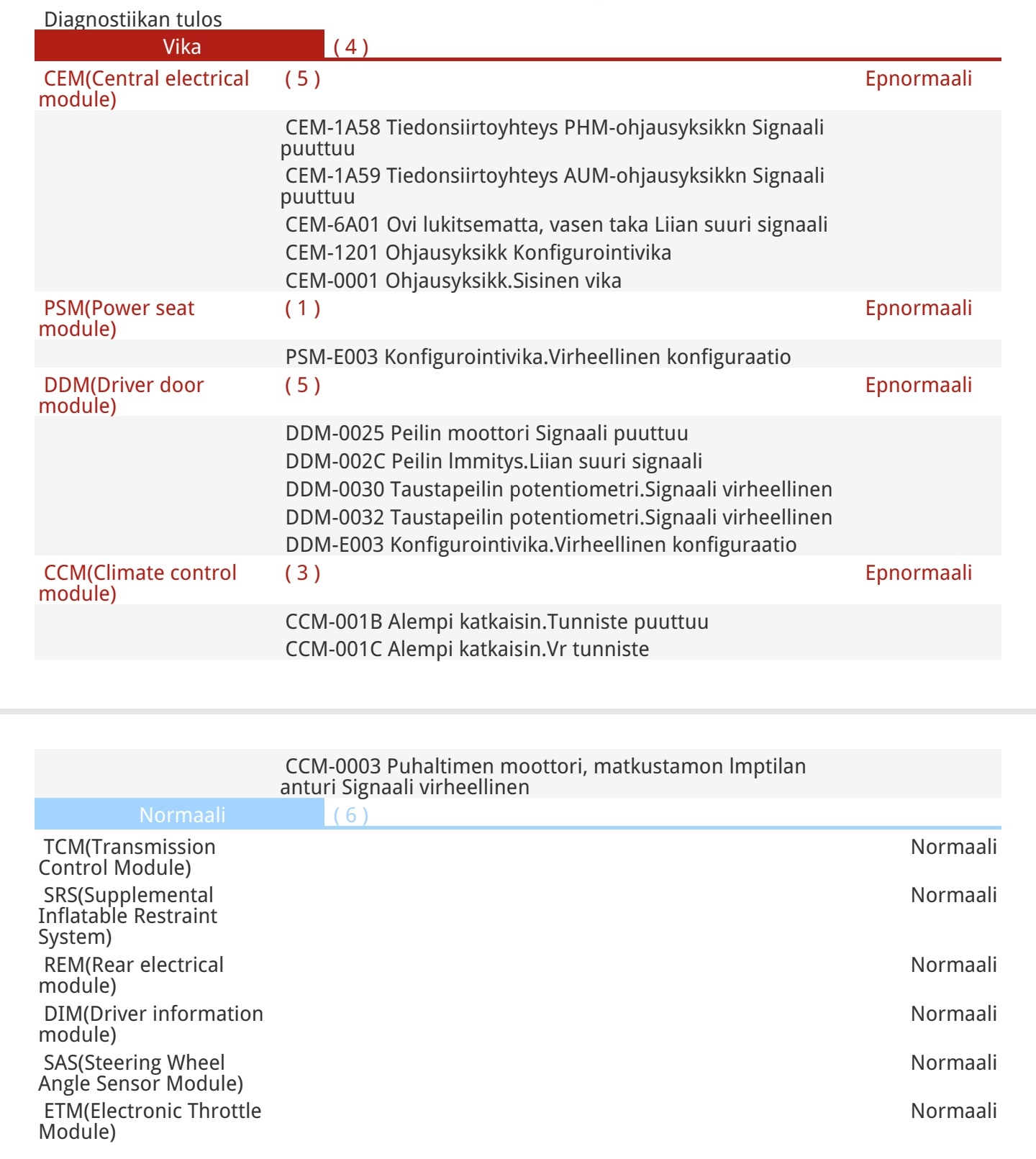

) some error codes it gave when i tried reading them you can see them in attavhments.

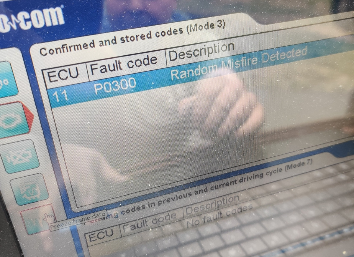

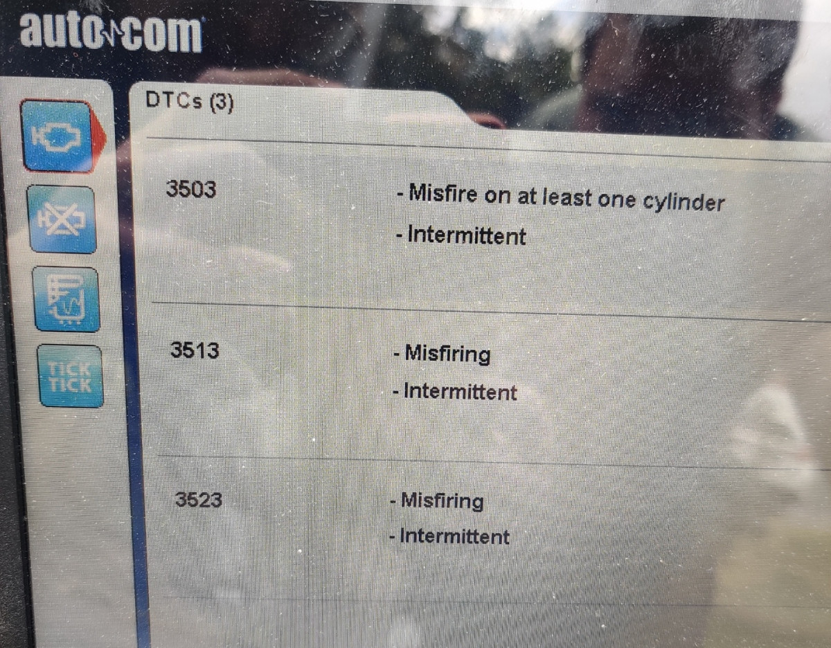

Been a little busy with the work last week but checked everything and actually everything was fine spark plugs were okay but there was misfires in cylinder 3. I replaced the coil and no fault codes anymore ( with vida ) and the fuel usage went back to normal but now after a couple of days and 2 harder acceleration it did this
