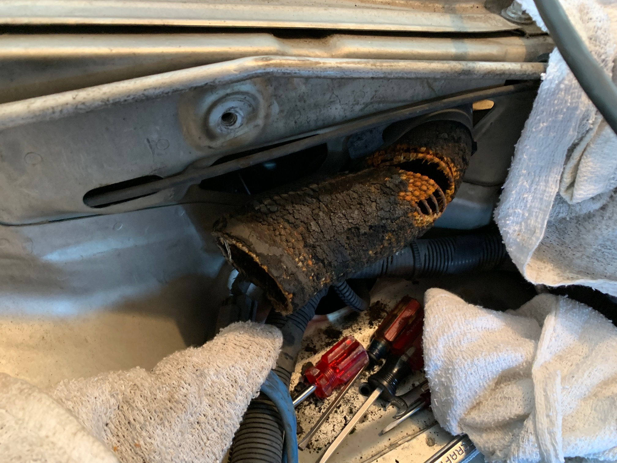

During the PNP switch replacement I had to remove the air box assembly, battery and battery tray. When I removed the lower air box assembly I also had to remove a rubber hose that I assume took in cold air from the side finder, I guess a "poor" cold air intake if you may. As you can see from the image below, the ONCE rubber hose is completely shot. It was so brittle that I had to be very careful when touching it.

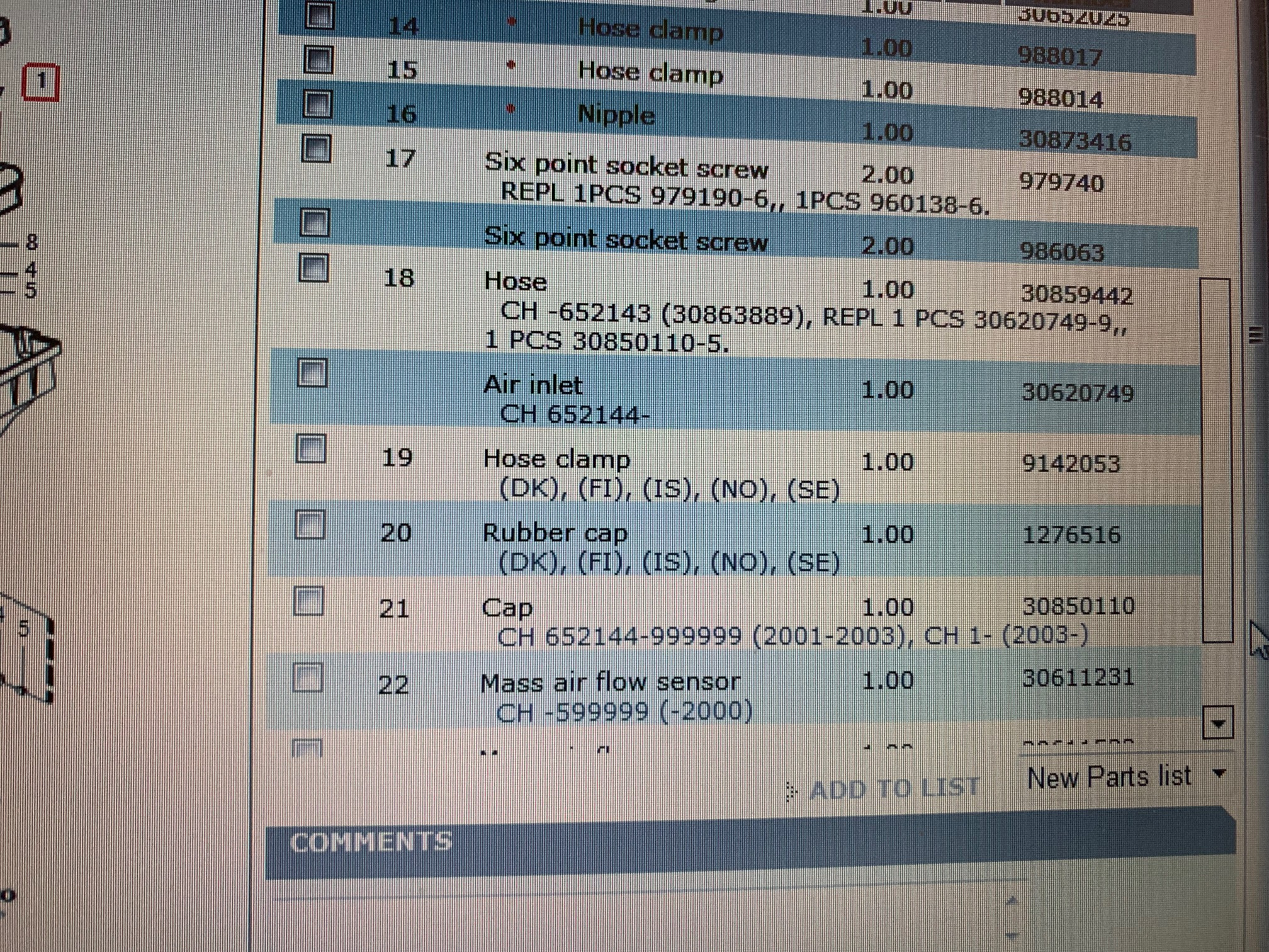

I figured I would order a new hose and that would be that. I looked in VIDA and it looks like it's part # 30859442. I was looking around online and I think one of two things is going on. The part # has been discontinued or the part # has been changed.
Below is what I found from looking online but I'm not sure what I need to order. I will also post images of what VIDA said when I went into the parts look up. I think in V40 2001 the configuration was a little bit different and that's why I'm being thrown off.

CH = Chassis. The Chassis number is the last six digits of your VIN number.

Thanks! I never knew what that meant in VIDA, but now I do. I checked VIDA and my last six #'s Chassis number are 428777.
Based on my chassis number I don't think those parts are for my vehicle?
If you go to this link https://www.myvolvoparts.com/oem-parts/ ... dhcw%3D%3D
You'll see it says that the part # in question has been discontinued and to use these two other part numbers, 30620749 AND 30850110. I might go ahead and order them and see what happens. What do you think?

VolvoFredNY wrote: 19 Jul 2021, 17:49 You'll see it says that the part # in question has been discontinued and to use these two other part numbers, 30620749 AND 30850110. I might go ahead and order them and see what happens. What do you think?
They are $50.00 parts at a dealer. I would go get a good one out of a self service salvage yard, pay less then $10.00 and be done with it.
