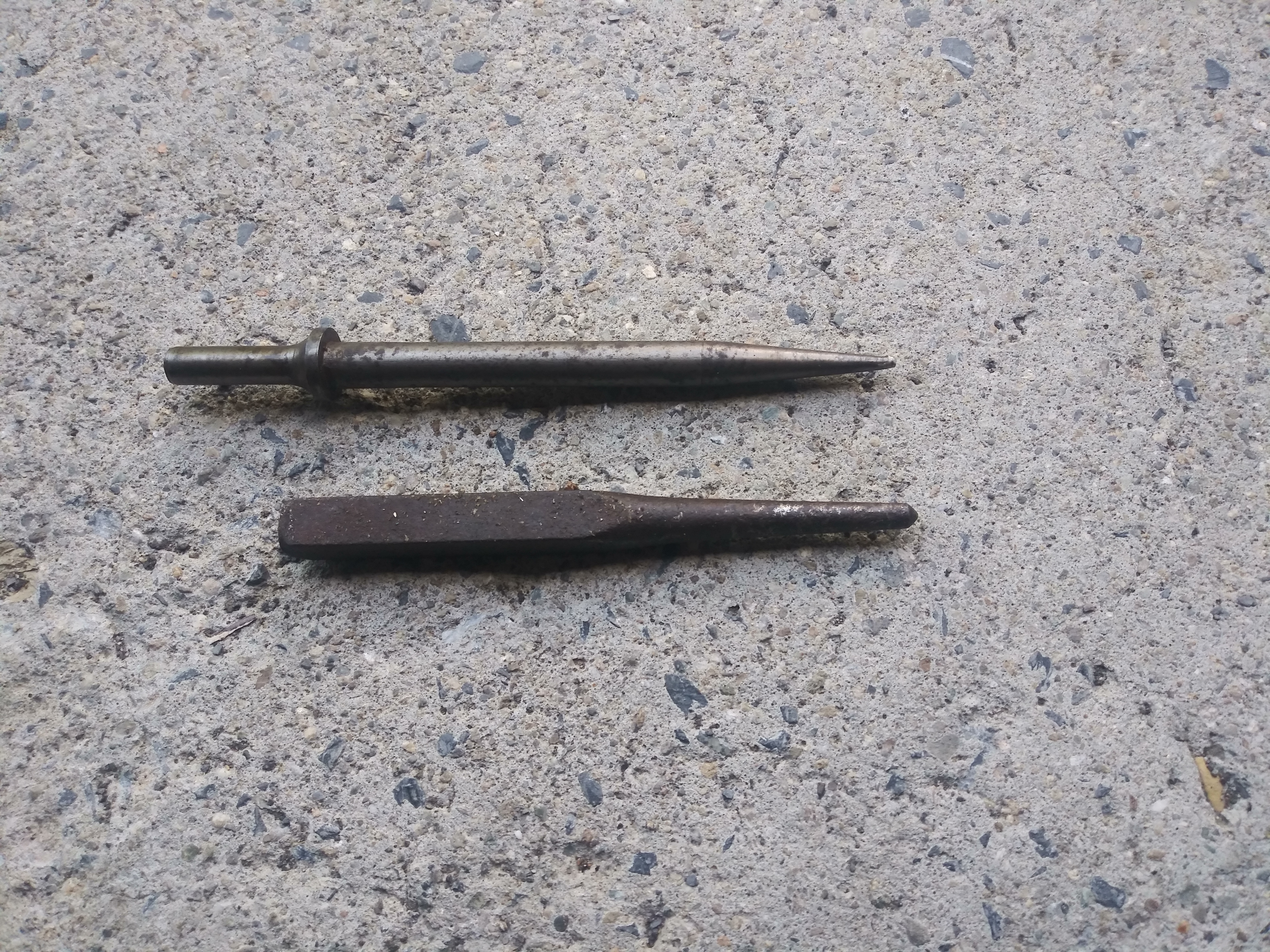

Post by jonesg »
maybe heat a steel punch , not red hot, push it into the hose, let it soften the hose, remove, then insert the fitting and clamp.
