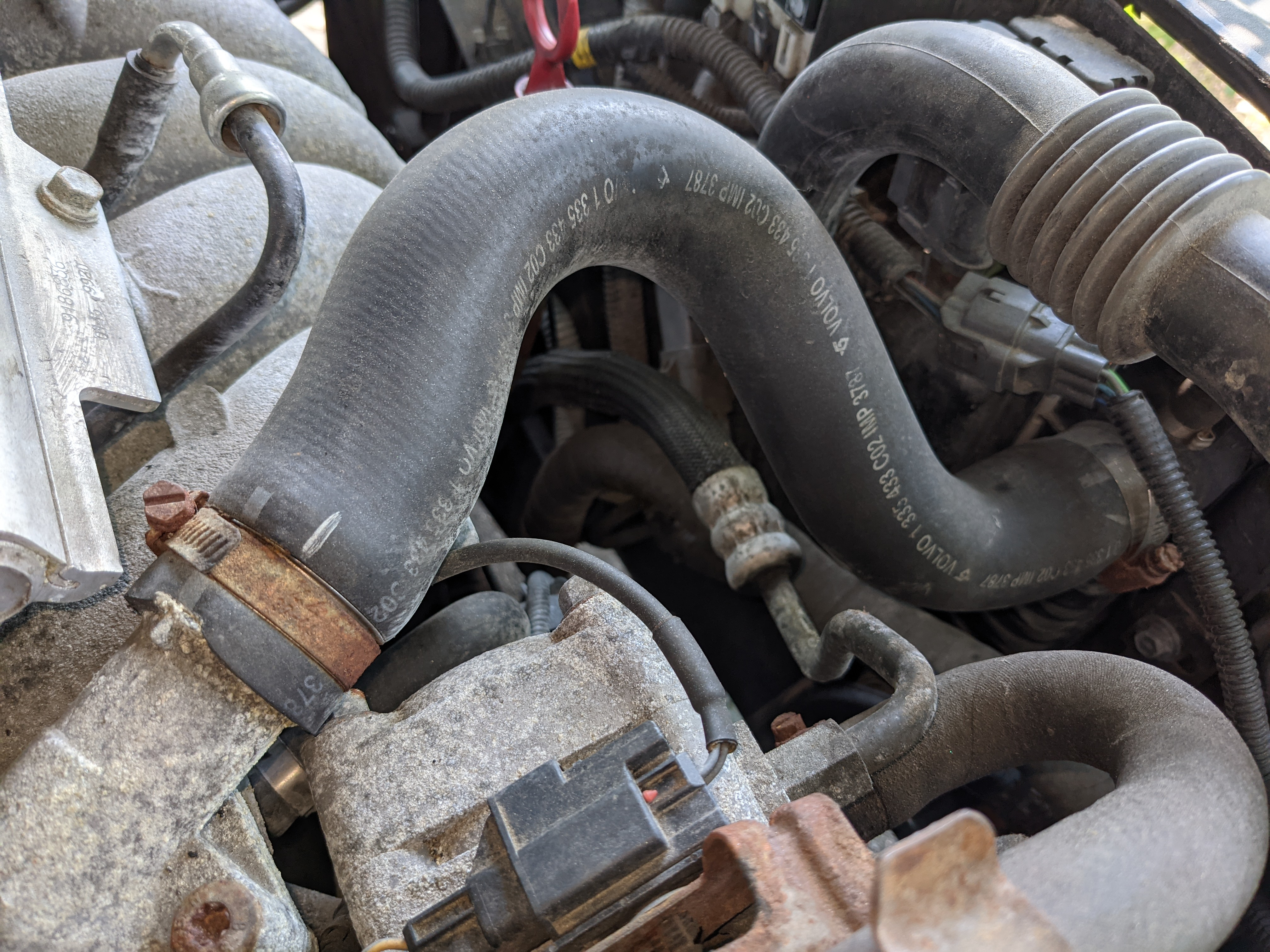

How can we tell when a radiator coolant hose needs to be replaced proactively if it isn't leaking? Do they have an estimated lifespan for proactive replacement?

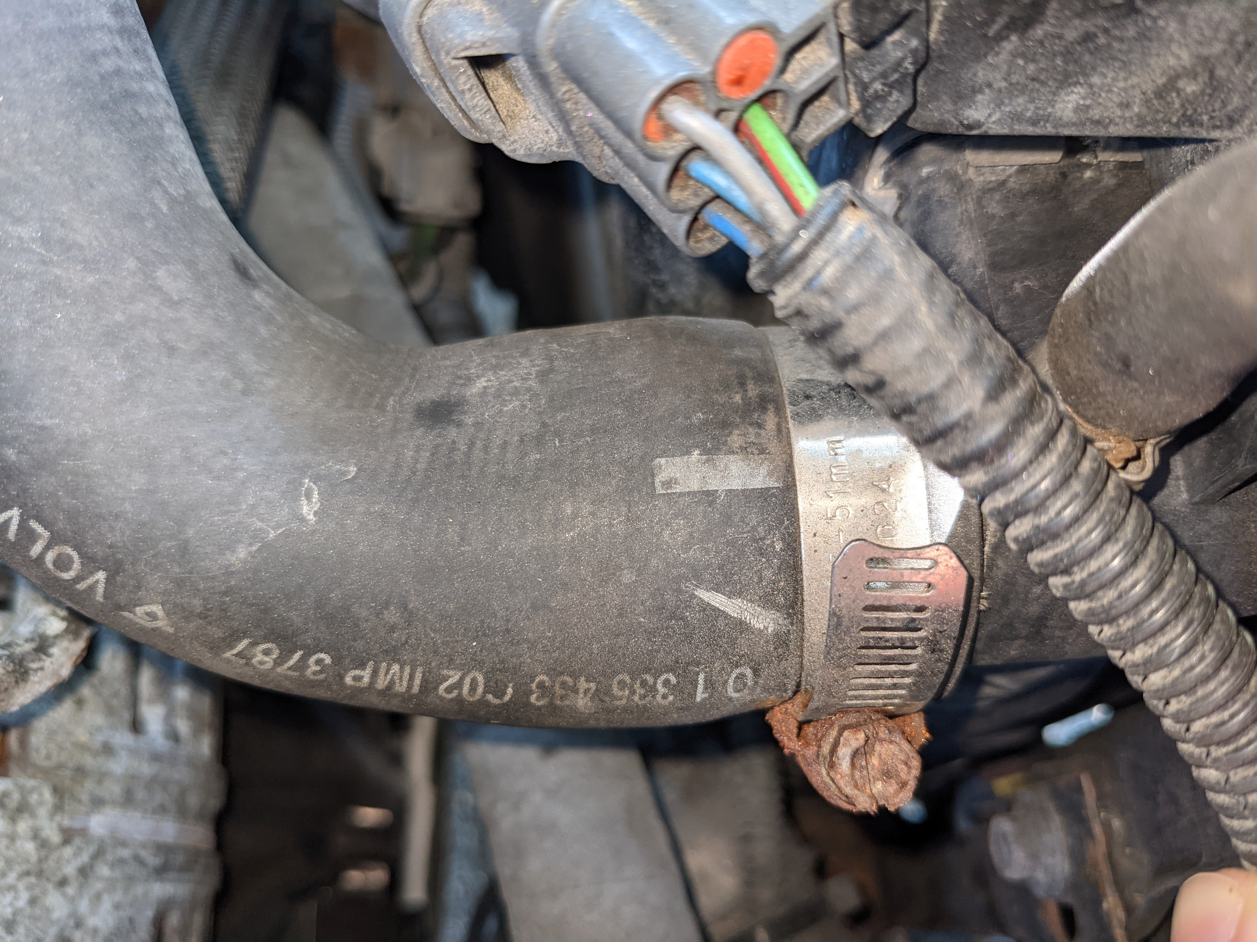

The few service records which came with my 200k mi 2000 V70 said to replace the upper radiator hose. I don't see any cracks in it even when squeezing, and it feels soft instead of brittle. It looks a little swollen at the thermostat clamp. I read an FCP reviewer mention they might fail "from the inside out".
The clamps don't look great, but I can swap those. Can anyone recommend good replacements with the inner metal ring to protect the hose? FCP and VolvoPartsWebStore sell part # 988030 but it no longer has that insert.

Your hoses look like they need to be replaced,
You are correct I go by the swollen look and yours meet that criteria. When it looks like an animal is living in them, the threads I believe are stretched.

It's best to changes them out if they are over 15 years old or 150K miles. Some hoses last the life of the vehicle but that not a great idea if it is hidden and burst while driving.

Agree with the above.
Rubber only lasts that long under heat cycles.
It is amazing these hoses go to 200K miles.
Replace both upper and lower hoses.
Use only Volvo, don't bother with aftermarket.
Time to replace the thermostat too (I use Wahler only)...
Inspect the heater hoses too.

I also agree on this. A burst hose is way worse than the cost of replacing it and the piece of mind that goes with it.
Can't recall if your car is turbo or not. If turbo, also consider the turbo coolant hoses as they are easily over looked.

Thank you guys for your input, yet again! Should the expansion tank hoses be replaced (top overflow hose and bottom supply hose)? This is starting to get expensive...

As for the tank hoses the ends were bulging on both the 03 T6 & C30 T5 and leaking so had to cut those section. I would change it.

I would also replace the hose clamps. Those are starting to rust and can separate from rust. Cheap insurance and easier to work on new clamps. Get all stainless steel clamps if you can find them.

Thanks, I am also replacing the clamps. I'm using OEM Volvo clamps, so probably paying more than I should. But why save $5 to have a weak link?
