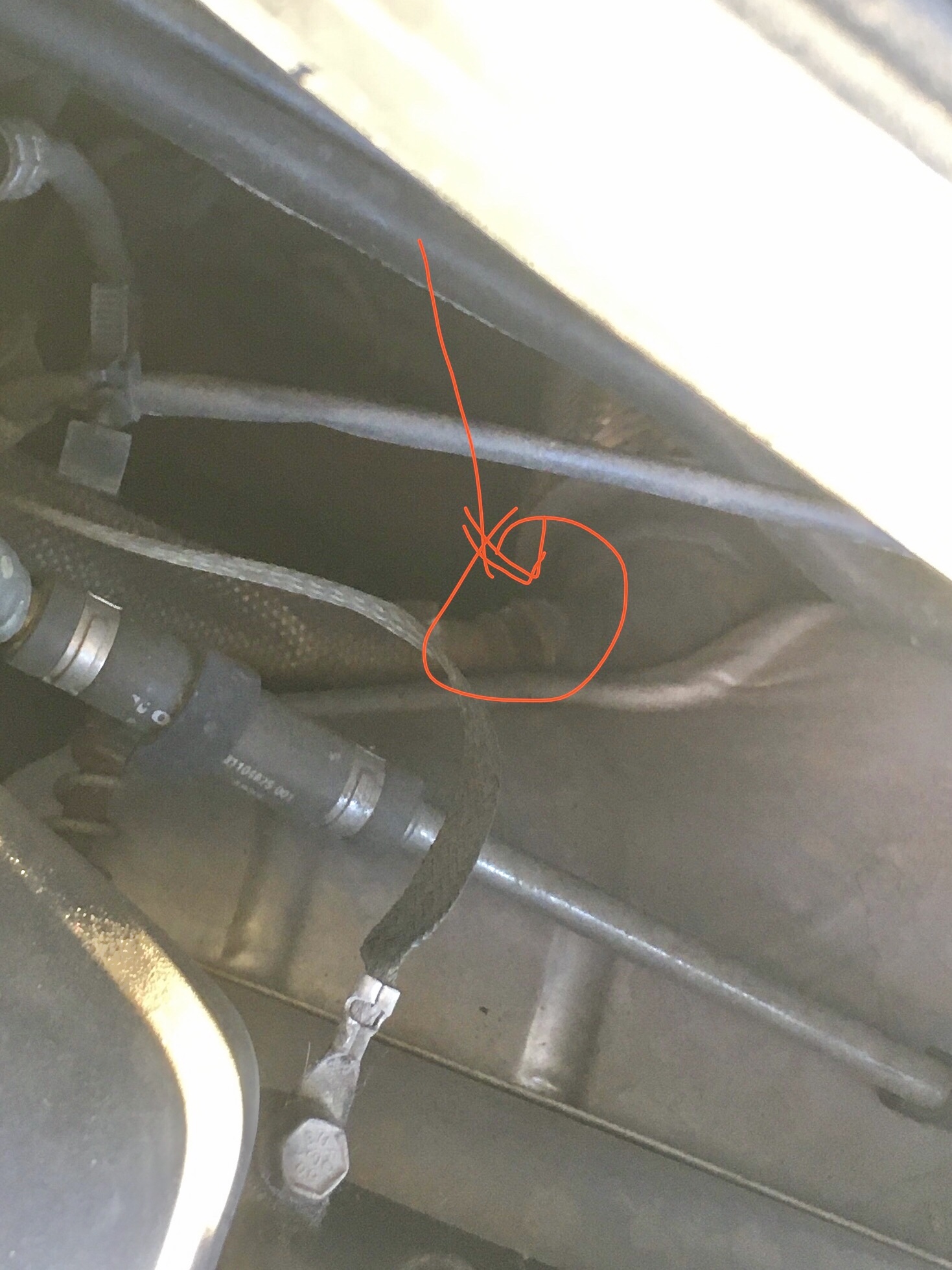

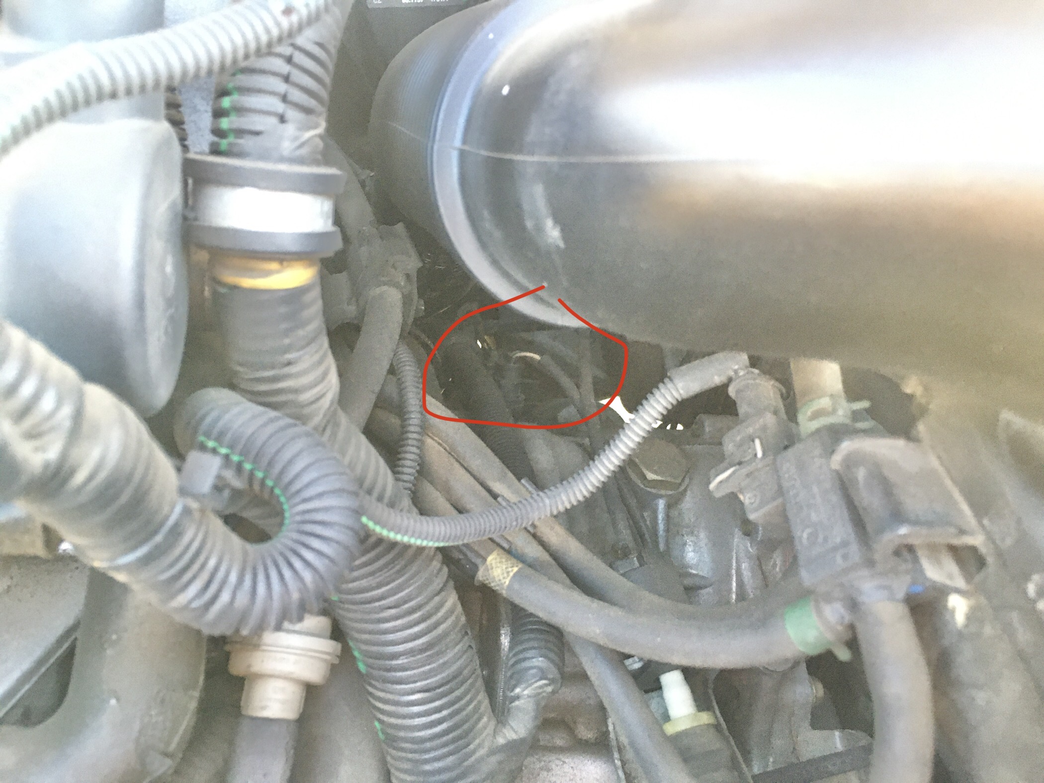

Ok,
I found it.
The front sensor is accessible from top of passenger side behind the engine.
Tricky part is the wire and plug go all the way to the driver side and accessing to unplug needs some parts to get out of the way.
Any recommendations?

Post by jonesg »
You have to pull the bread box and kitchen sink, the engine can remain but everything else has to make room.
The bigger problem is you can only get one hand in there.
Rehearse one handed juggling, knowing how it comes apart is the trick, they designed it to come apart with one hand.

Post by Mikele82 »
Thanks, yeah. i hope i can one hand this.
