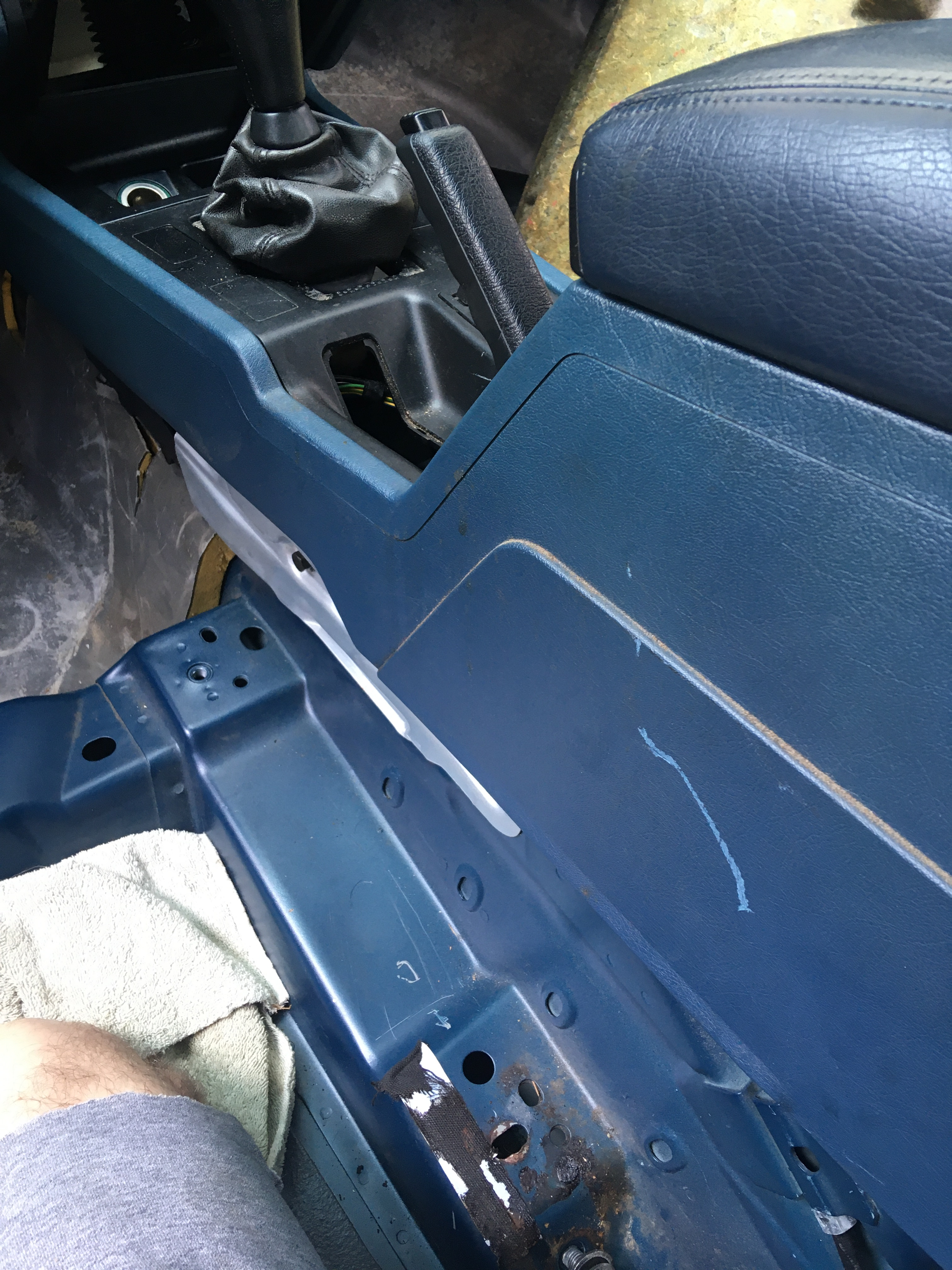

Well, it doesn’t go the way I expected.
I found the two bolts over the cigarette lighter the 2 ones in the glove box and the washer under the handbrake ( I think).
But the central console still stays « blocked » under the ashtray area :

So, This car is full of plastics that do theirs ages... Carefully, i extracted the ashtray first and,i get a roll spring , a sort of metallic fastener, and the body of the ashtray did fall down...
Manov : 0 / Ashtray : 1
I succeeded in to move the black flat hose for the heating :
Manov : 1 / Heater flat hose : 0
Sound isolation
As i could get the central console out, I made a point of cutting away the moss, which was very wet, and dried the floor. The moss is only wet on the flat surface, and there is no rising on the sides. So I thought I would dry the cut piece and put it back. First and foremost, I need to use RUSTOL to stop the little bit of rust there is...
Well, I'm not satisfied, working outside like this, on a parking lot, is pretty hard. And to tell you the truth, I worked for two years like crazy for my diploma, I'm blown up...
Tomorrow, i have to treat the floor , then to let dry, and wednesday, i spray a finish coat. To there, the sound insulation will be dry and i will rebuild the interior :
Manov : 1/2 / Car floor : 1/2
