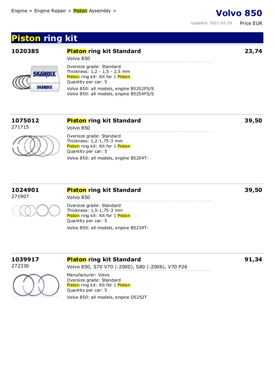

^ Exactly. I did find some on Skandix, but for about $ 150 + each, and that doesn't include shipping from Europe. Nuts !
So since I only have lower compression in two cylinders, and rings are available, I will probably just go the cheap route and hone / re-ring those two cylinders and leave the everything else alone. I can see $$$$ being spent otherwise.
